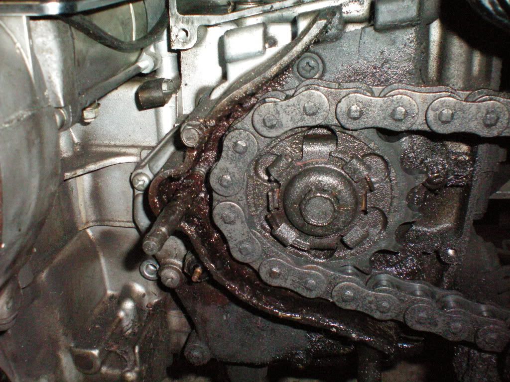

OK, so I have everything off, almost ready for the engine to come out, how do I remove the drive chain? I am thinking that I should loosen the rear wheel to slacken the chain, then remove those clips on the c/s sprocket and remove sprocket, is that right?

Re: proper method of removing engine?
27 Sep 2009 17:35
look for a master link in the drive chain and take it out then you can seperate the chain or if you have an impact gun remove the counter shaft sprocket and the chain will come right off.
27 Sep 2009 17:55
so a ratchet won't remove the sprocket? do I need a chain link breaker to remove the master link?

- PLUMMEN
- Posts: 7986
- Thanks: 104
27 Sep 2009 17:57
slide rear wheel all the way forward ,should give plenty of slack
27 Sep 2009 18:09
PLUMMEN wrote:
I thought I would do that, but there is that rim that runs right around the chain at the c/s sprocket that prevents me from just removing the chain without removing the sprocket too, unless as tim says I break the chain, although I am kinda leary of breaking the chain, fleetwood mac told me not to...
