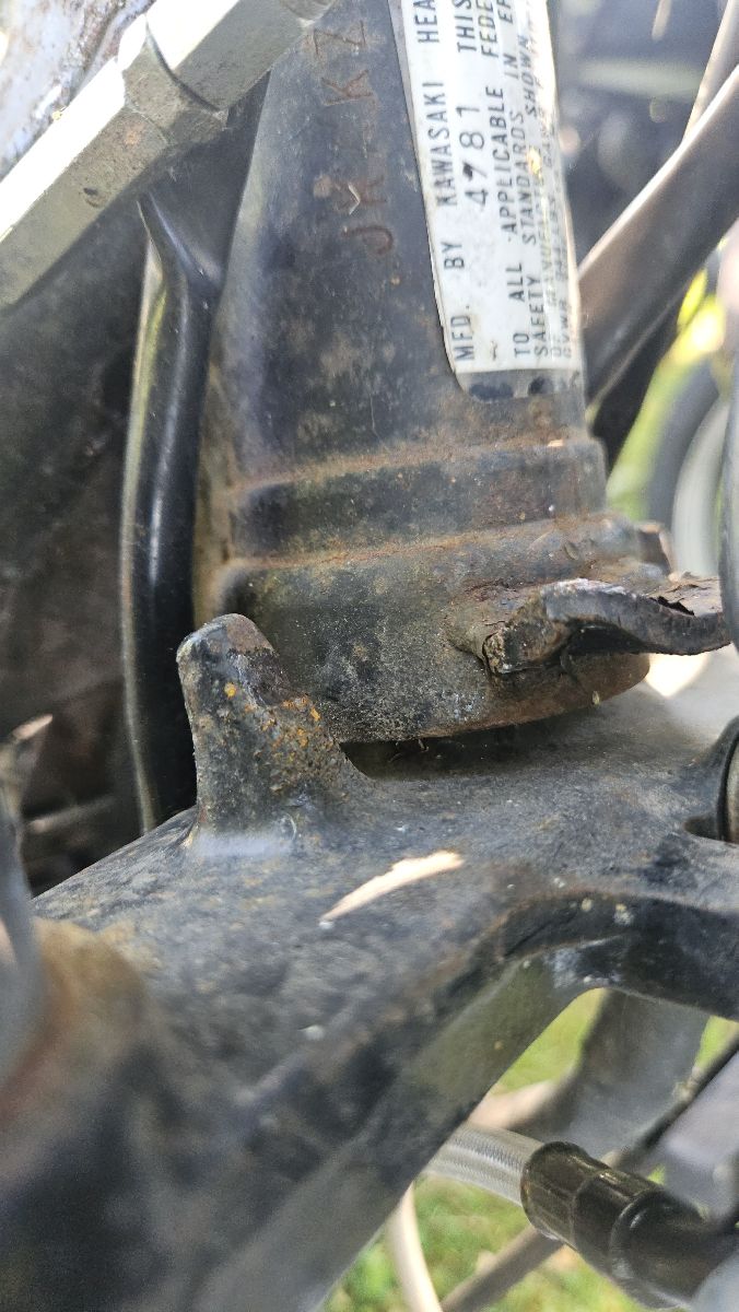

Anything I do with regards to forks will be basically the whole front end....
In addition to the csr having leading axle forks. the steering head angle is another consideration. also. check the steering stop to see if it's bent. might give a clue as to how much force the steering head and frame sustained.
You're right about the steering stop. It is bent slightly up on the right side of the frame where it contacts when you turn the handlebars left. The left side of the handlebar is also very damaged.
