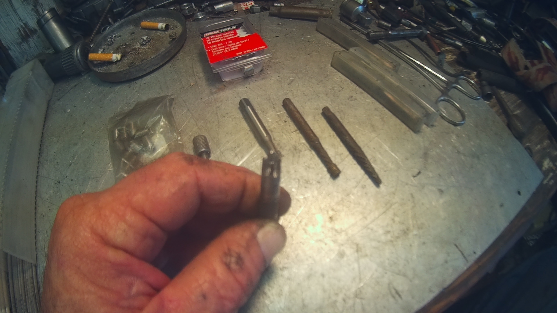

Being a easy out is tapered light tapping on it with a punch can loosen it enough to get it free enough to pull out with a magnet. It can take time to get it loose enough with gentle prying it from side to side. I hate those things. I got myself in REAL trouble breaking off a tap in a hard to reach hole. I took a old broken nail punch, ground the end making an extractor. Now that was a pucker moment. When it backed right out was almost as good as sex. :woohoo:

Thanks for the ideas. I tried to tap it loose but it is in there like a rock. I think that is going to make it worse as there is no room to do much more than to tap it in more The masonry bit would tap it a bit but would take material off. It might take a day or two to cut it out though. I am going to sleep on it and see what I think in the morning.

Masonry bits are Tungsten carbide and will cut hardened steels.
You may need to sharpen it and use some oil but you have a good chance of drilling the easy out.
Just be sure to use a slow speed.

While tapping on the broken piece you hold the punch lightly allowing it to bounce. Eventually the broken piece begins to bounce as well allowing it to be extracted with a magnet. It will go in just so far then becomes sloppy in the hole. Reverse drills are the best way to remove broken bolts but they can also break causing you the same problem. All just a part of wrenching. Everyone has been there. :whistle:

Well I tried every trick I knew and the ones you offered up and the end result is I am going to get a new head. Oh well, it is just money. And thank goodness for a wife who doesn't mind my hobby. Thanks for the input all. It is really nice to have a place to go to help from people who really know their chit.
