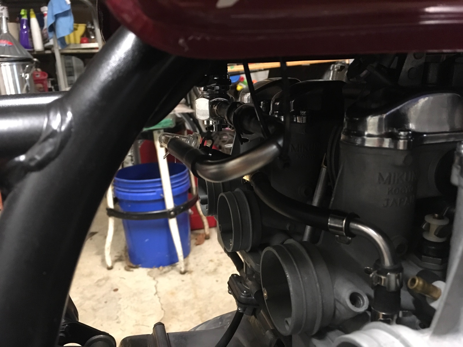

Not worried about dirt in the bowl. There is a filter on the pingel petcock and also I have secondary stone type filtered up stream of the carbs. Trust me as much leaning, bouncing, and sloshing that happens during a ride the dirt, if there is already in suspension and not on the bottom of the bowl.
