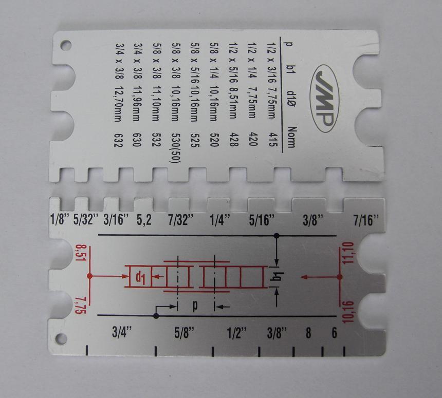

I specified a 530 when ordering so unless they made it wrong I can't be sure.
