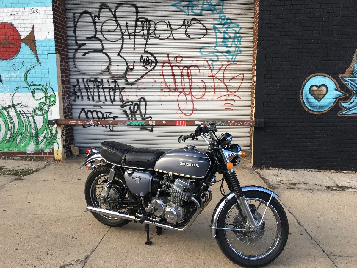

Great advice! On my CB750 I had that same experience. The cable snapped while i was on the highway here in crazy NYC where ppl drive like mad. Luckily there was a shoulder I was able to pull onto. I have spare of all clutch cables, so Im going to swap it outright. Here is my 750 that experienced the snapped cable.
