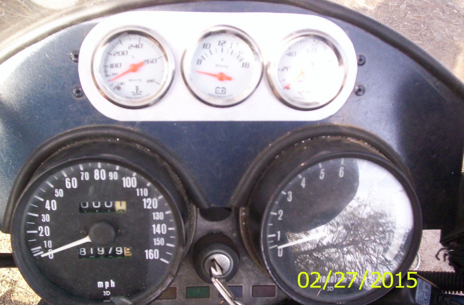

I brought my Z1 out here in the desert in 76. For the most part it was my daily driver. It does get very hot sometimes but I haven't had any problems due to heat. I installed a oil cooler in 85 and the problem I was having was no oil pressure at start up. The oil would drain back into the sump. That made checking the oil difficult as the cooler took about a quart. The oil light would come on under hard acceleration, telling me the oil level was low. Then the wreck 6/13/86 a Friday. The bike was destroyed including the cooler. Got it back on the road about two years later this time no cooler. I rode it until parked in 98. In 13 I got it back on the road after a major overhaul. Still no cooler. I've been wanting one but unless I can do something about the drain back, I'll do without one. In the two years I've been riding it, I've had no overheating problems. In the city, (I use to live in LA in 75) I can see where a cooler could help in traffic. I didn't have one at the time and yeah, the bike got real hot. No problems though. Splitting lanes was a gamble but a must do for our air cooled bikes. I have gauges now and the running temp stays in the 240/250 range. That's head temp. When shut off it will peg the gauge but once running it will go back down.
