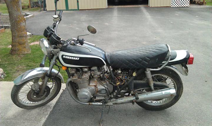

And here is a before shot of this months BOTM
Quite a transformation Ehh ?

Street Fighter LTD wrote: And here is a before shot of this months BOTM
Quite a transformation Ehh ?i
This was how I purchased it for $300. It was a steal, felt bad for the guy, his wife made him put it up for sale on Craigslist.
