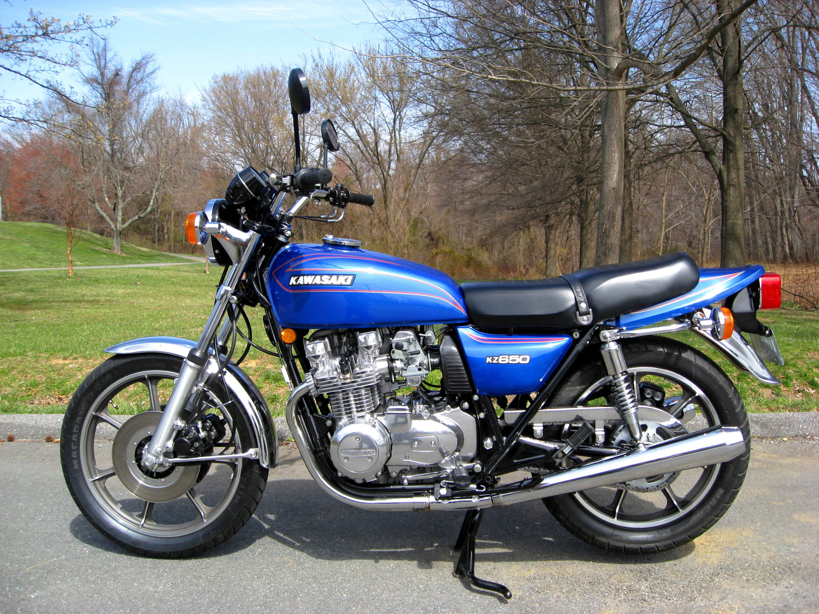

Personally I like the C better as it has better brakes and alloy wheels. What is the VIN of the bike in question? If the VIN stamped in the steering neck begins with "KZ650C-" followed by a 6 position numeric the bike's frame at least began life as a "C" model. Otherwise, it did not. If the frame is from a KZ650-C and the wheels, brakes, etc. have been changed I would be concerned as to why (big wreck?) and whether or not the person making the changes got everything right. I suspect you will find it in fact is not a KZ650-C. Here's what a KZ650-C1 looks like (he says with pride. :laugh: ) Ed
