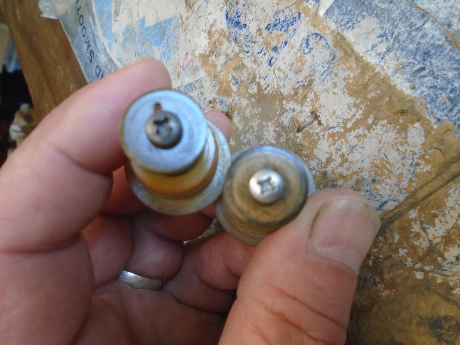

Pulled the stator cover today... part of the neutral switch came with it.
I was able to get this part unscrewed with some needlenose pliers:
I ordered a new one, though it was revised to be a bullet/push on connector rather than a screw on so I'll need to change the connector on the harness. Should be here by the mid-next week. Here you can see the end-state of my previous stator grommet replacement and wiring job... I wasn't happy with it when I did it, and I'm not happy with it now. Hence the new stator.

- asphalt900
- Posts: 1566
- Thanks: 1049
Re: Z1B Mid-Summer Refresh
20 Jul 2025 06:46
Lots of fancy there. Do they explain why the need for the "oil pressure" relief? These are roller engines not plain bearing and preference volume over pressure.

Got it! Here's some additional info if it helps. Those plastic Neutral switches, they crack even on the NOS shelf! An alternative, if you can find one is the 13151-018 metal version. Identical to the plastic one, still retains the original "forked" connector with Phillips head screw. They were used on the Kawasaki F11 250's. And while you're in there fiddling, look at that bypass oil switch. They refined them thru the years, drilling a relief hole in the plate. They are datecoded by the way, last photo, unless replaced.
