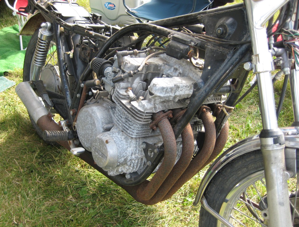

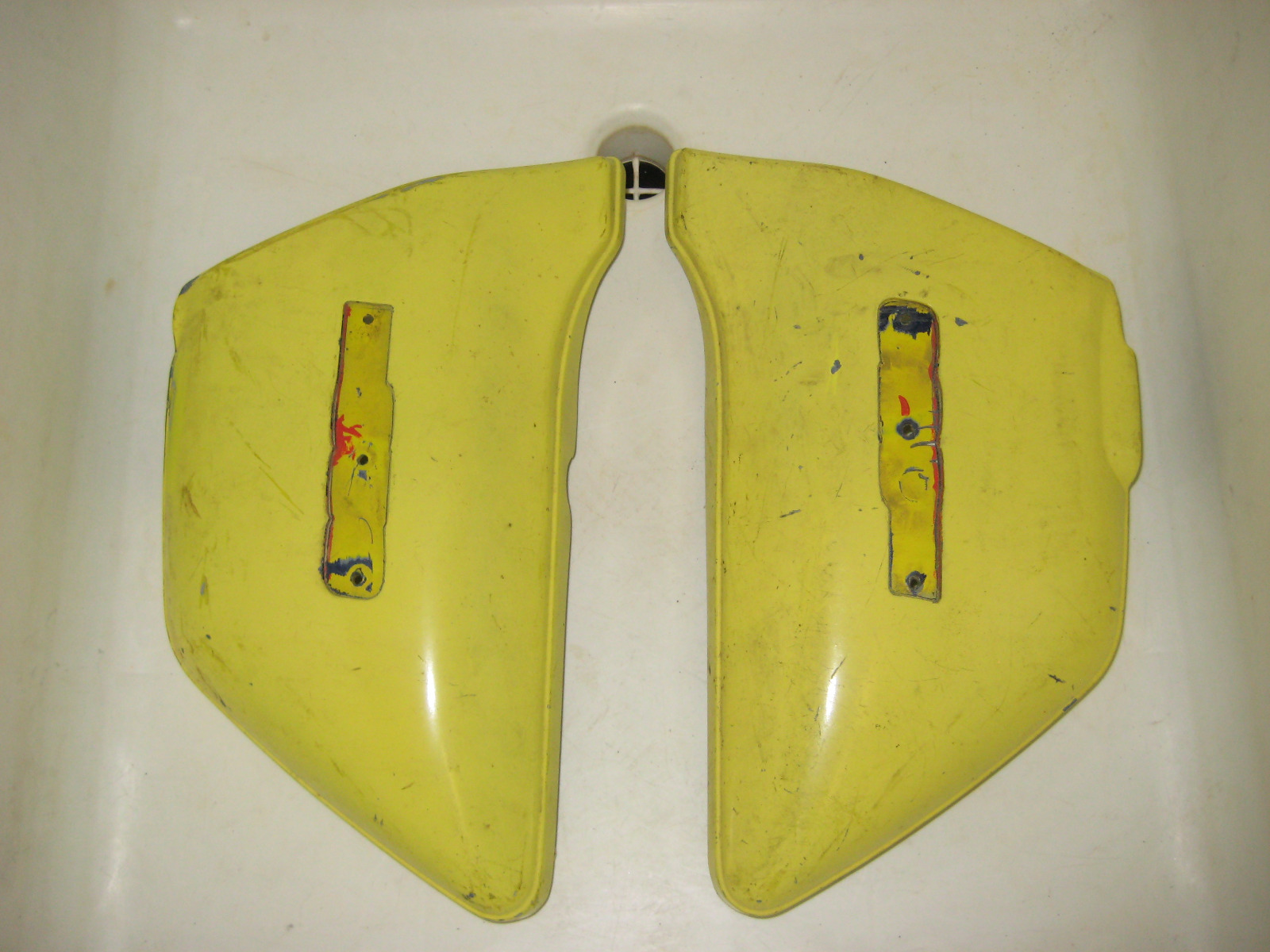

Just thought I would get the ball rolling on this but not sure on a timeline. Here are the pics I found of the day I bought the bike.
I took the tank, tail piece, side covers, and the seat off for the pics, all that was missing was the headlamp/bucket. It was already missing turn signals (a common mod)
The engine ended up being a low compression dog but it was free to rotate, just crusty with white corrosion.
I plan to cut down the stock seat foam, maybe do a aluminum or fiberglass solo seat pan. Fabricate a fiberglass headlamp shell. Alloy DIY rear set controls, minimal wire harness and smaller battery etc.
It came with a fairly clean tank and mismatched body pieces. All usable parts.

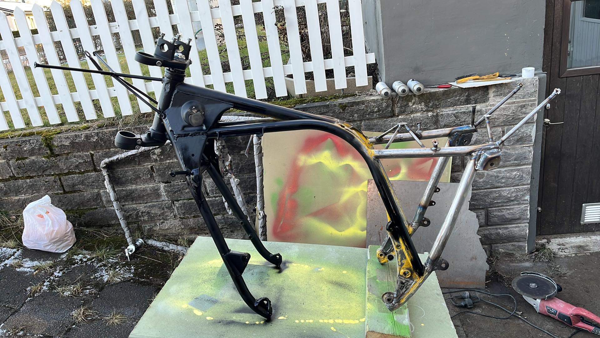

04 Feb 2025 13:34There is a few kgs to save on the frame. 🙂
Maybe not recommended for street use.
If I remember correctly the frame now weights ~10kg.
The whole bike weights 159kg without fuel.
But that’s without generator and starter. Aluminium swingarm and magnesium wheels.

That drag bike looks great. Very long intake runners? Did that improve midrange or top end?
About saving weight on axles. I tried once to drill out axles but it was difficult. I found it was easier and cheap to buy hollow axles from a scrapyard.
For the engine mounts I put helicoil in the engine and short screws instead of the long bolts all the way thru.
