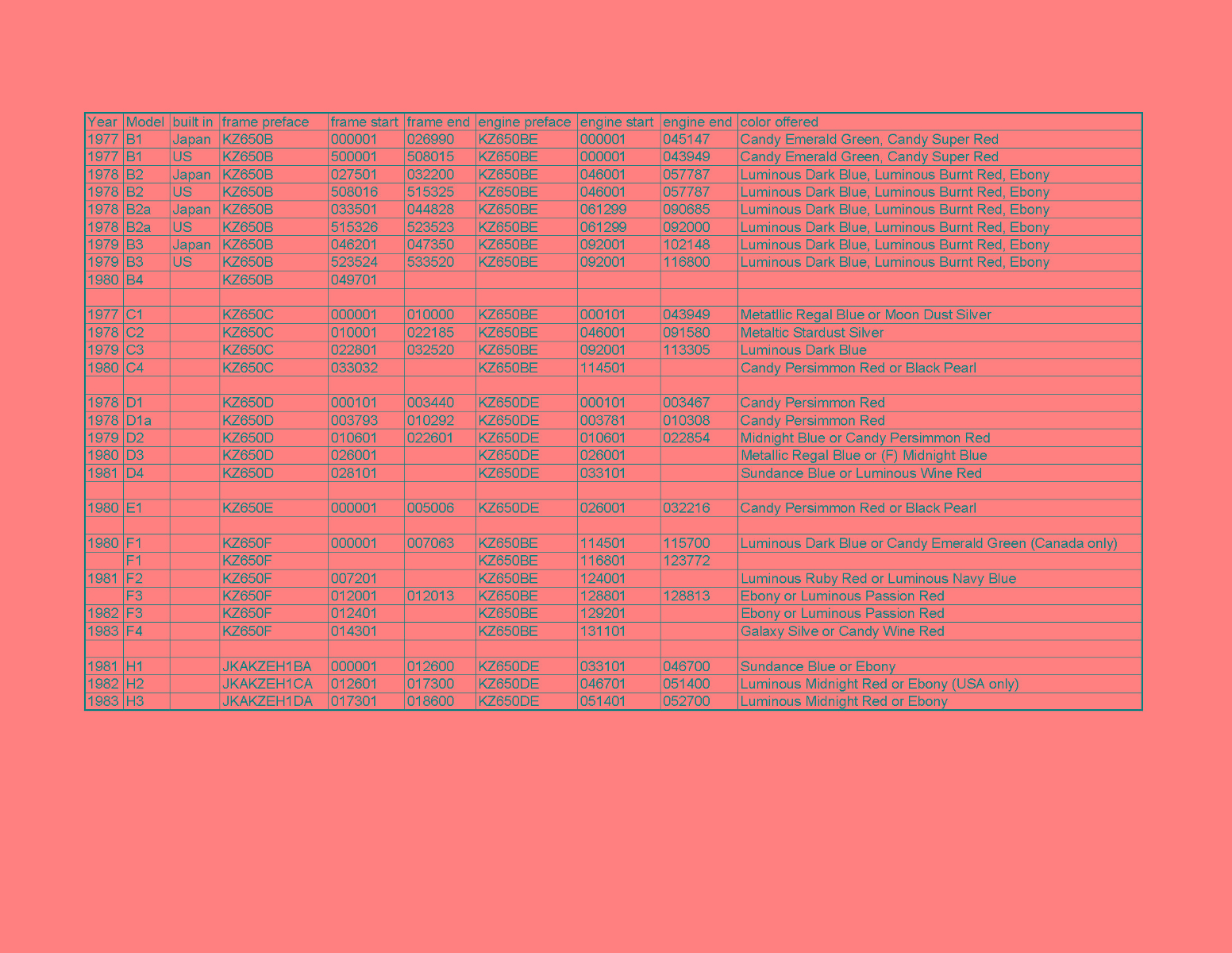

G'day from South Australia. I am finally getting into my project bike, a 1977 KZ650, ( I think ). The import certificate says it is a 1977but I am thinking the actual manufacture date maybe 1976. The engine number is KZ650BE094244 and the frame number is KZ650B-524522. It has the spoke wheels and one of the carbs has a accelerator pump fitted. Starting to look like the motor might be fitted to an earlier frame. I want to get a complete gasket and seal kit for it, any suggestions. For future reference is it possible to remove the valve stem seals without totally destroying them. I think the gasket kits come with the new seals so I ruined them. If I wanted to remove them is there a special tool for the job?.

According to this web site and your frame serial number it looks to be a 1978 model.
www.jarlef.no/Kawasaki/Series/Z/650/z650b.htm

Numbers also here.
www.kzrider.com/filebase-alias?task=down...id=1178&catid=64&m=0
Factory gaskets and seals are the best, though there is no kit.

Not claiming I know anymore than anyone else, but the numbers you posted fall within the frame and engine numbers I have found and made sense of (not claiming they are 100% correct) for a 1979 B3 model.

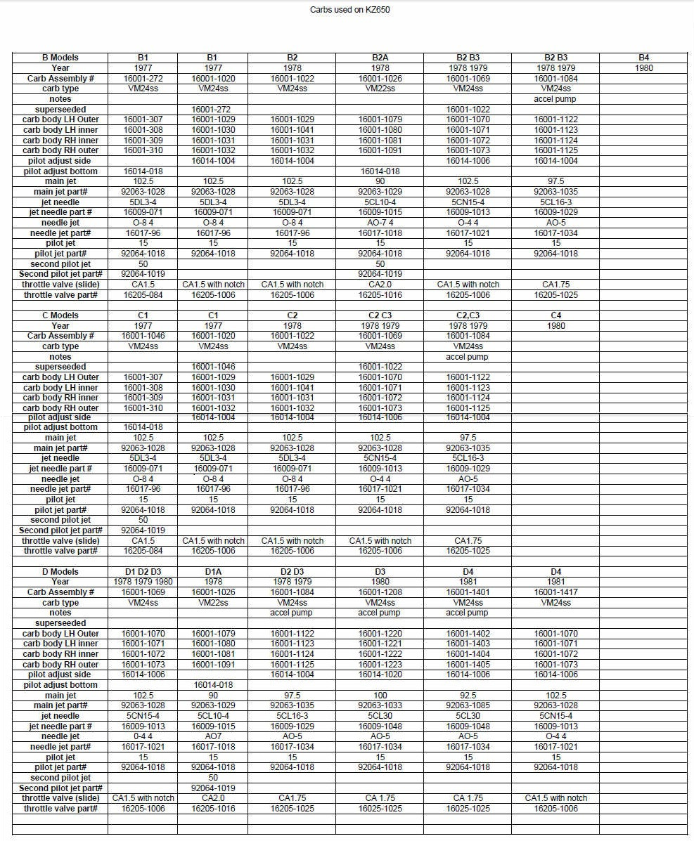

Thanks for the replies, I think I am getting closer to finding what year and model 650 I have. The fuel tank has the smaller letters in the "kawasaki" I still can't find out about the accelerator pump on one of the carbs. It only appears on very few models I have looked at. It wasn't an optional extra was it

01 Oct 2024 06:42 - 01 Oct 2024 06:50If you have the small lettering tank logo that is 1979 and later. Accelerator pump carbs were only used on USA models starting in mid 1978/1979 for emissions purposes. If you have a cam cover and air box that has tubing on them its for the emissions equipment and most likely originated in the USA.Thanks for the replies, I think I am getting closer to finding what year and model 650 I have. The fuel tank has the smaller letters in the "kawasaki" I still can't find out about the accelerator pump on one of the carbs. It only appears on very few models I have looked at. It wasn't an optional extra was it
Bikes that were imported from Japan to Canada had no emissions equipment. I believe this is the same for bikes that made it to UK/Europe.
