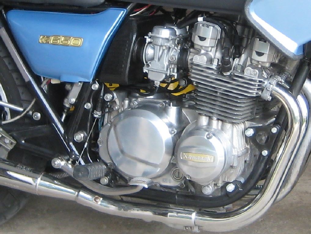

The best way to get more performance is with cubic inches.
If you could find a early 750 barrel and bore it to 810 that is the best bang for the buck. Its hard to find NOS piston and cam kits for the 650 but its possible with a LOT of waiting/searching. You can buy APE performance valve springs off the shelf. Carbs are easy to get but cost a lot, CR29 is a good option that increases HP. The cam sprockets from the earlier motor fit the later cams and the other way around.
The other way would be to swap in a complete 750 engine, either a later (post 82) GPZ750 or the more modern Zephyr or ZR7 engines (it has all been done) they all fit the stock 650 frame but you need to make engine mount spacers.
I went with a Spectre engine as it was a lot cheaper solution for me, but a lot more work converting to chain drive. In stock form its just a couple of HP under the GPZ750 of the same year and usually a lot less money than the GPZ.

07 Oct 2023 20:35 - 07 Oct 2023 20:42The best way to get more performance is with cubic inches.
Awesome bike I've looked at those engines, what does it take to convert over to chain?
577nitro-
To do that conversion you can split the cases without removing the barrels if needed, just invert the engine and work from the oil pan side. Take off the shaft cover and shaft housing first before splitting the engine. You have to remove the 750 transmission because the gear ratio is weird compared to a chain drive bike. I took the complete trans out of a 650 and it fits with no issues, the 650 and 750 clutch are identical. There is a oil feed hole that went into the shaft drive housing, it needs to be plugged with a 1/8 NPT fitting, it is next to the clutch rod. You can use any clutch actuator cover but I chose to use one from a KZ700 as it has the better release mechanism. You also need to make a custom gasket to allow the use of a 650/750 trans door cover, a stock gasket does not cover enough of the machined surface (the shaft housing gasket surface is slightly larger than chain drive trans cover) You also have to make spacers at every engine mounting point if going into a 650 frame as these newer engines are all rubber mounted, I made mine from 1" OD 6061. The front sprocket lines up with a thin shim behind the sprocket (.050-.060") so chain line is not an issue.
The engine is out of a 1982 Spectre, it had been stored for a lot of years so I put new rings in it. In that picture I am using CVK 34 mm carbs from a 1990 Ninja 750 I re spaced, that is the only performance upgrade except for a Dyna S and green coils. The exhaust is stock 650 F model, the air box has been modified to take the larger CV inlet rubbers.
