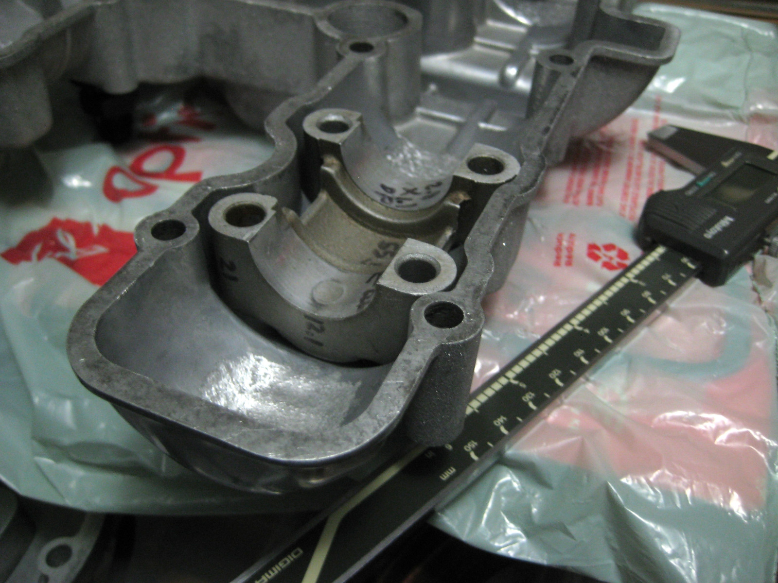

The other day I looked into replacing the cam cap bolts with studs. On the early Z1 head and cover this ended up to be a non starter.
I had a spare cam cap to lay into the valve cover.
Cam cap shoulder where bolt goes thru is 22.5mm high.
It ends up that the cam cover cavity where the cam cap sits is 29mm deep (Kawi OEM gasket is 1.70mm thick) This leaves only 8.2mm clearance for a stud sticking thru before it hits the cam cover (only room for a flange nut) So there is no extra stud length to "pull" down on the cam cap when permanently installed as planned.
I can't speak to what the situation is on the newer heads and cam covers (J/MK2)
Wookies temporary stud method seems to be a good option or the "C" clamp method for "pulling" down higher lift cams. I don't think it will be a issue with my .425" cams, and probably up to .435" cams (max for street)
So I am shelving the idea on this build and sticking with regular OEM bolts.
I have been a 650/750 guy for most of my motorcycling life, so shim under cam swaps must be over a hundred times or more. Have I stripped out a few holes, yes (mostly on my 650 drag bike) Just insert and move on, usually do them with the head on the bike, eventually they all get done. Come to think of it I don't think I have seen too many pics of heads with permanent studs installed, maybe once or twice.
I am not saying its not a good idea to put studs in permanently, I just don't think its warranted. The number of times I am going to take the cams in/out I could not say, its a crap shoot.
The most proactive thing would be to insert all the cam cap threads with steel inserts, but that takes time and setup. I don't know if I would bother with a street bike as it seems over kill. With the steel inserts you can positively pull the cams down by using OEM bolts in the cam caps.
I had no issues pulling down .480" cams on my drag bike with C clamp or even just pushing on them with my hand. I think it may get trickier with +.500" cams and higher spring rates (never been there)
