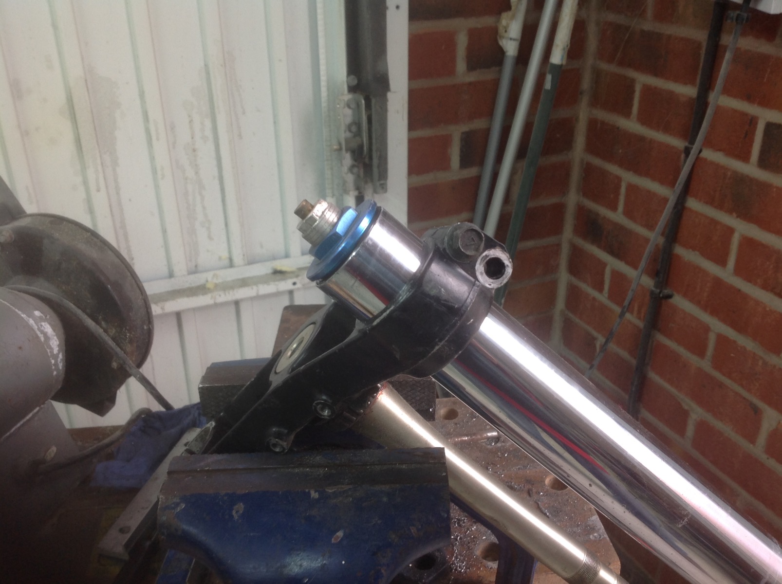

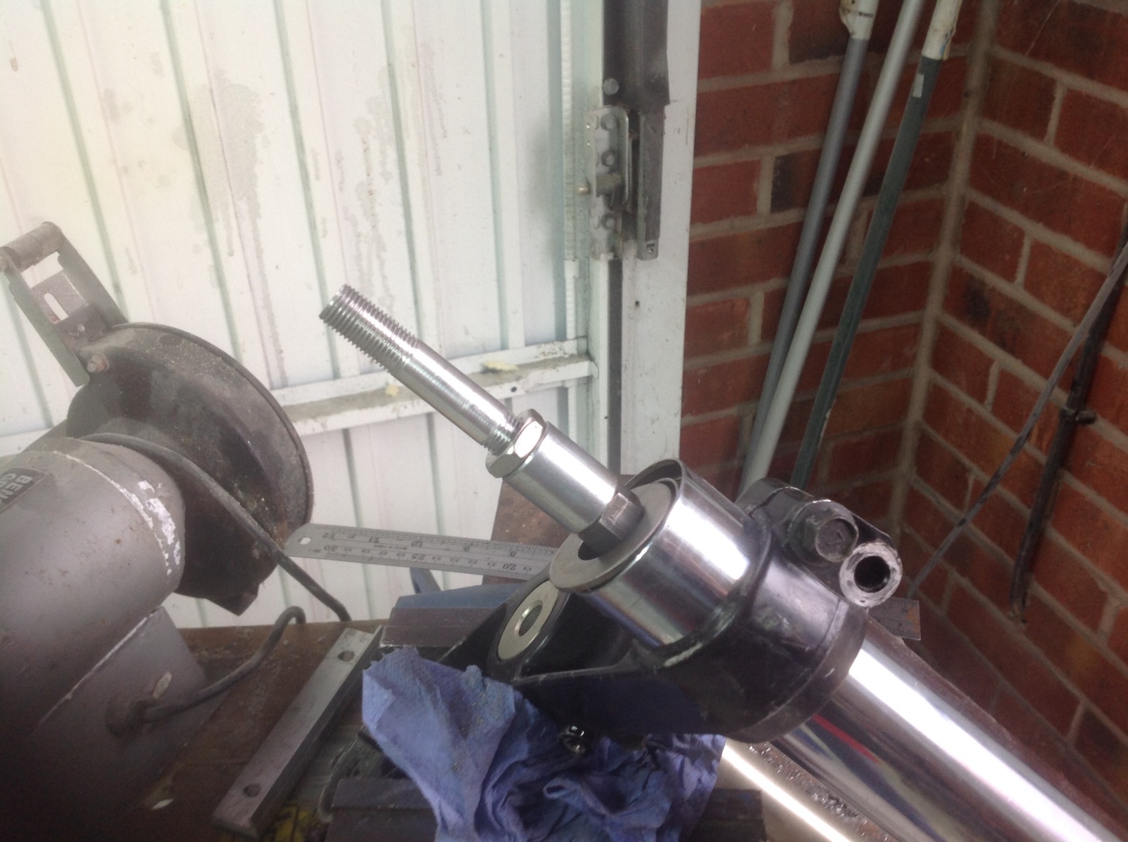

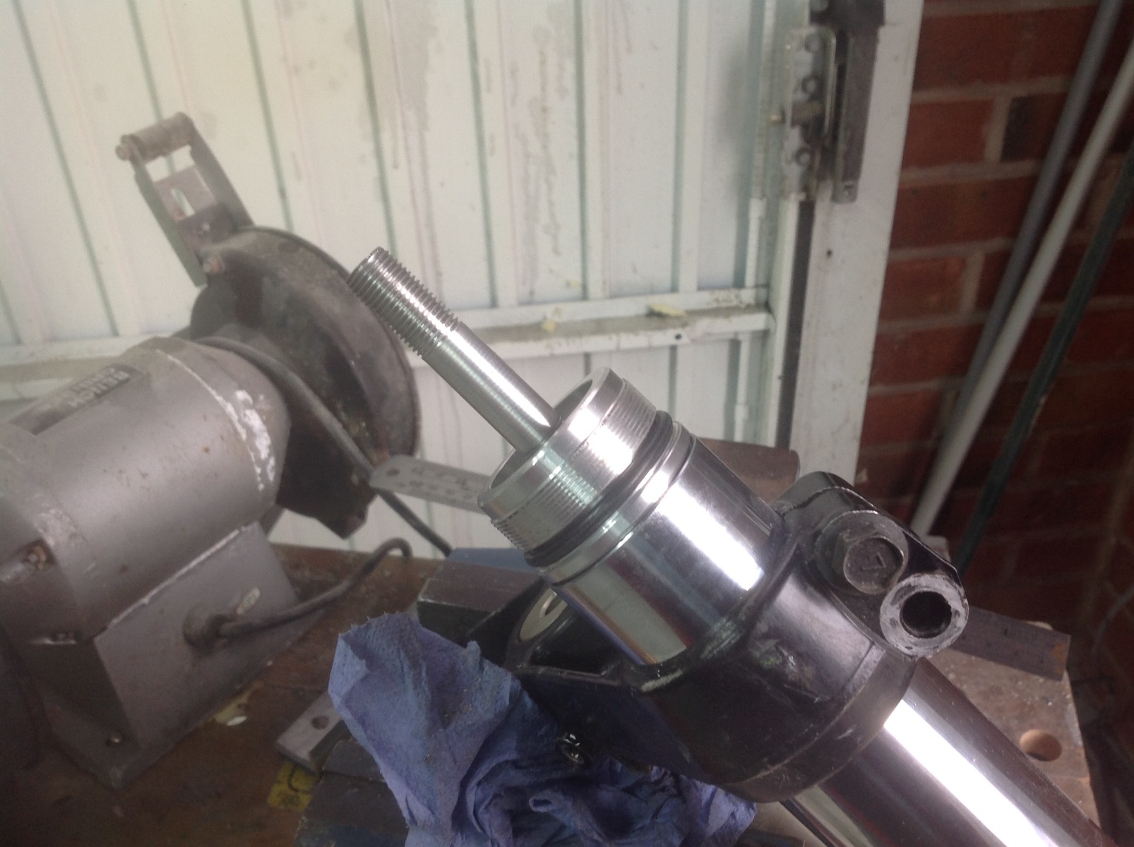

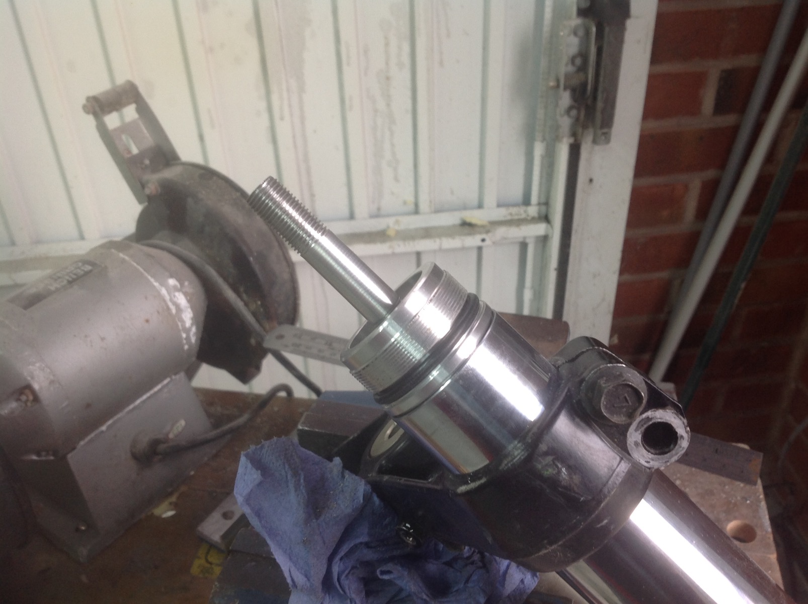

I started the day brimming with anticipation that I would be posting pic's of my front end fitted today, after months of delays I finally got everything back from the second machine shop on Thursday ( modified stem and fork extension parts) All that was left to do was knock up a couple of extension pieces for the damper rods that carry the adjuster rods. No problem I thought as I had the inner tubes from the 600 forks I bought for the main extension tubes (£25 for a bent pair and the top caps and lowers are also the same as the 900 ones I'm using) Turns out it isn't quite so straightforward to run a 12x1.25 thread down a piece of blank stock with a fixed die that is intended for thread restoration, so seven failed attempts later I have run out of stock (it appears for me at least it is near impossible to run a straight thread down virgin stock) So now deflated I have ordered a meter of threaded rod (I am hopeful drilling a hole through the middle will be easier than threading the outside)

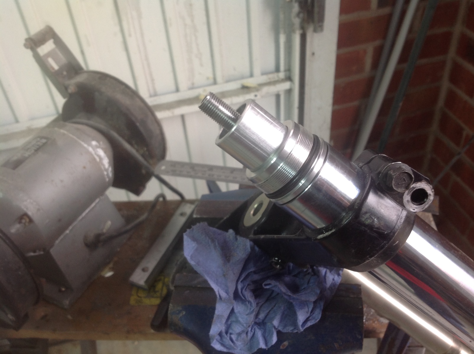

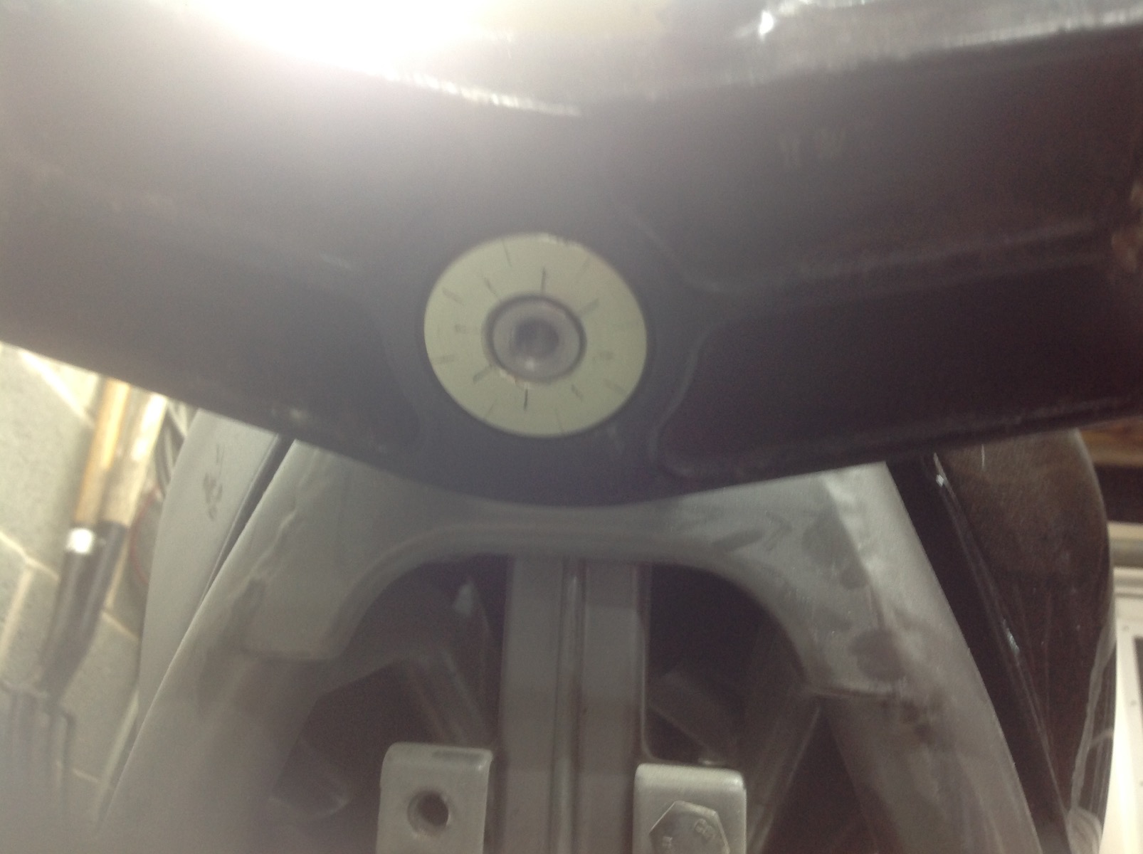

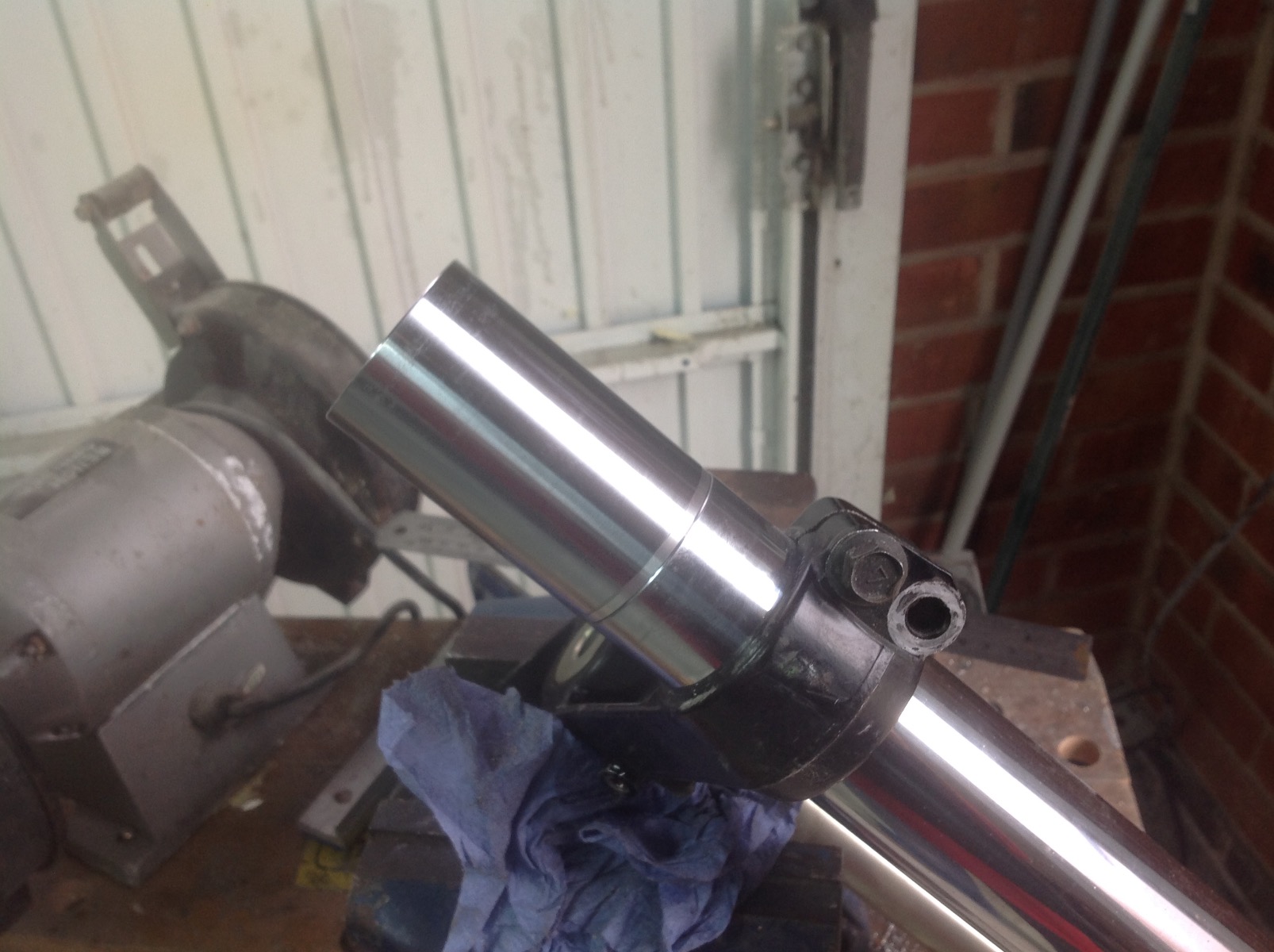

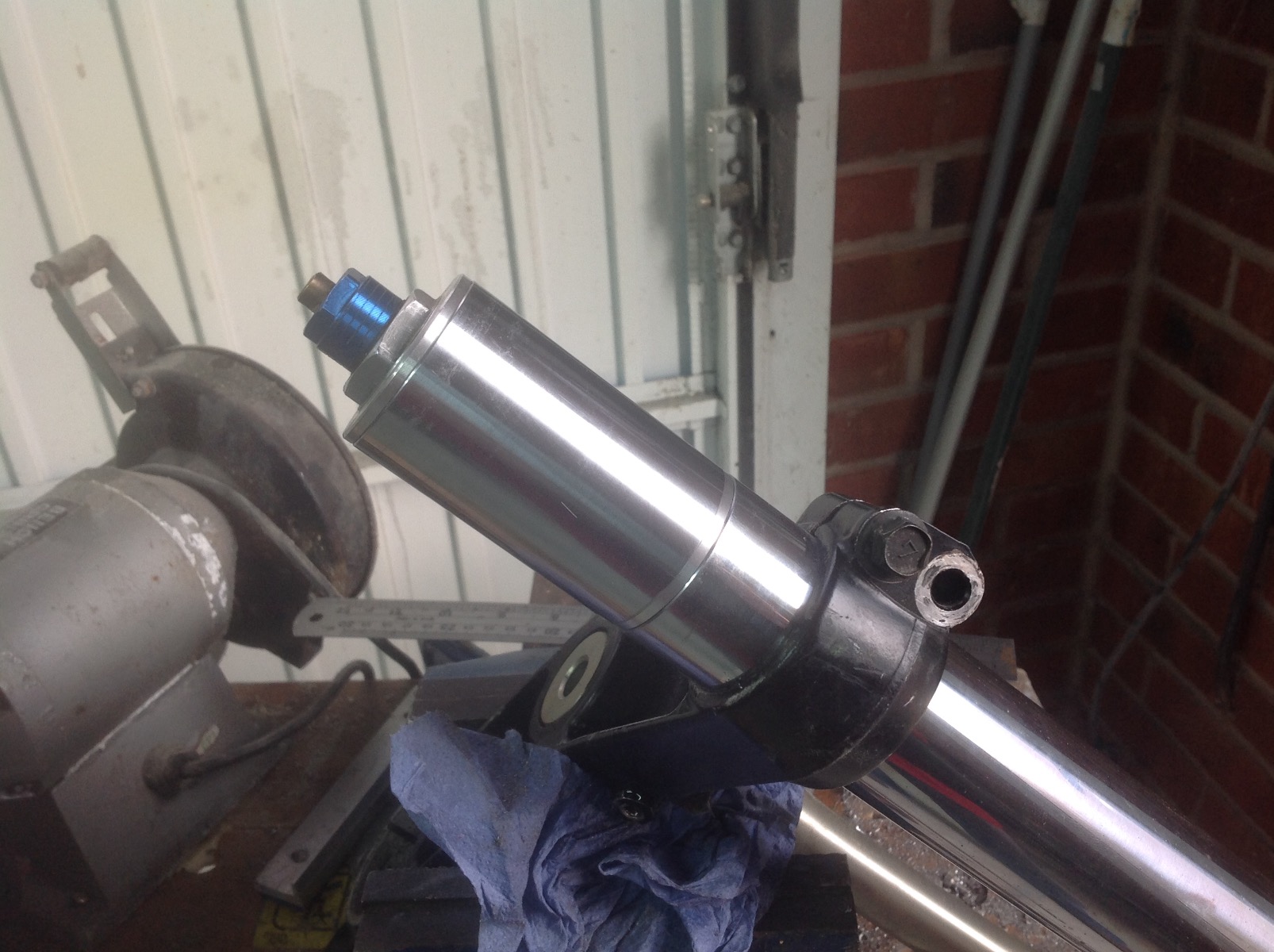

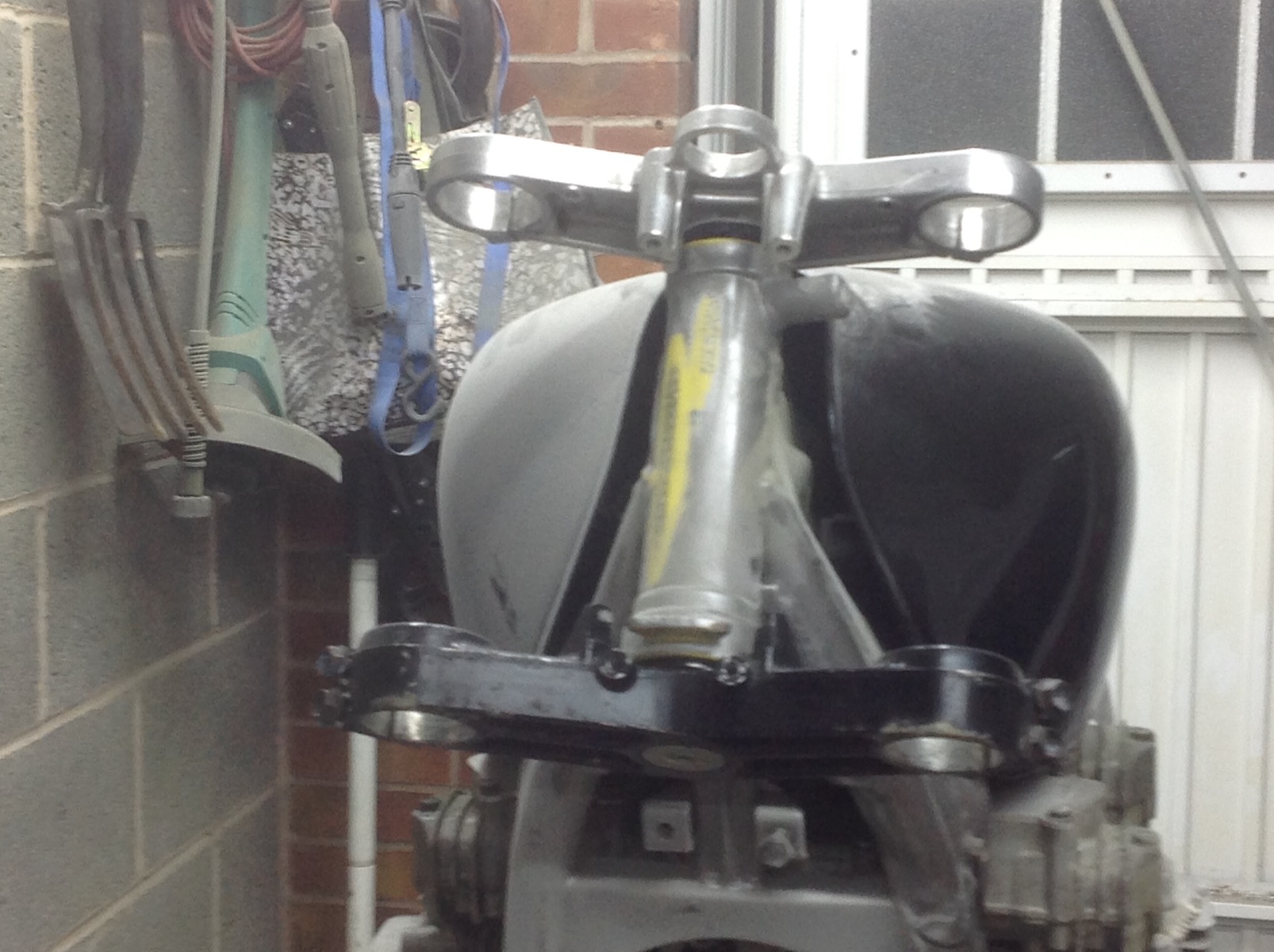

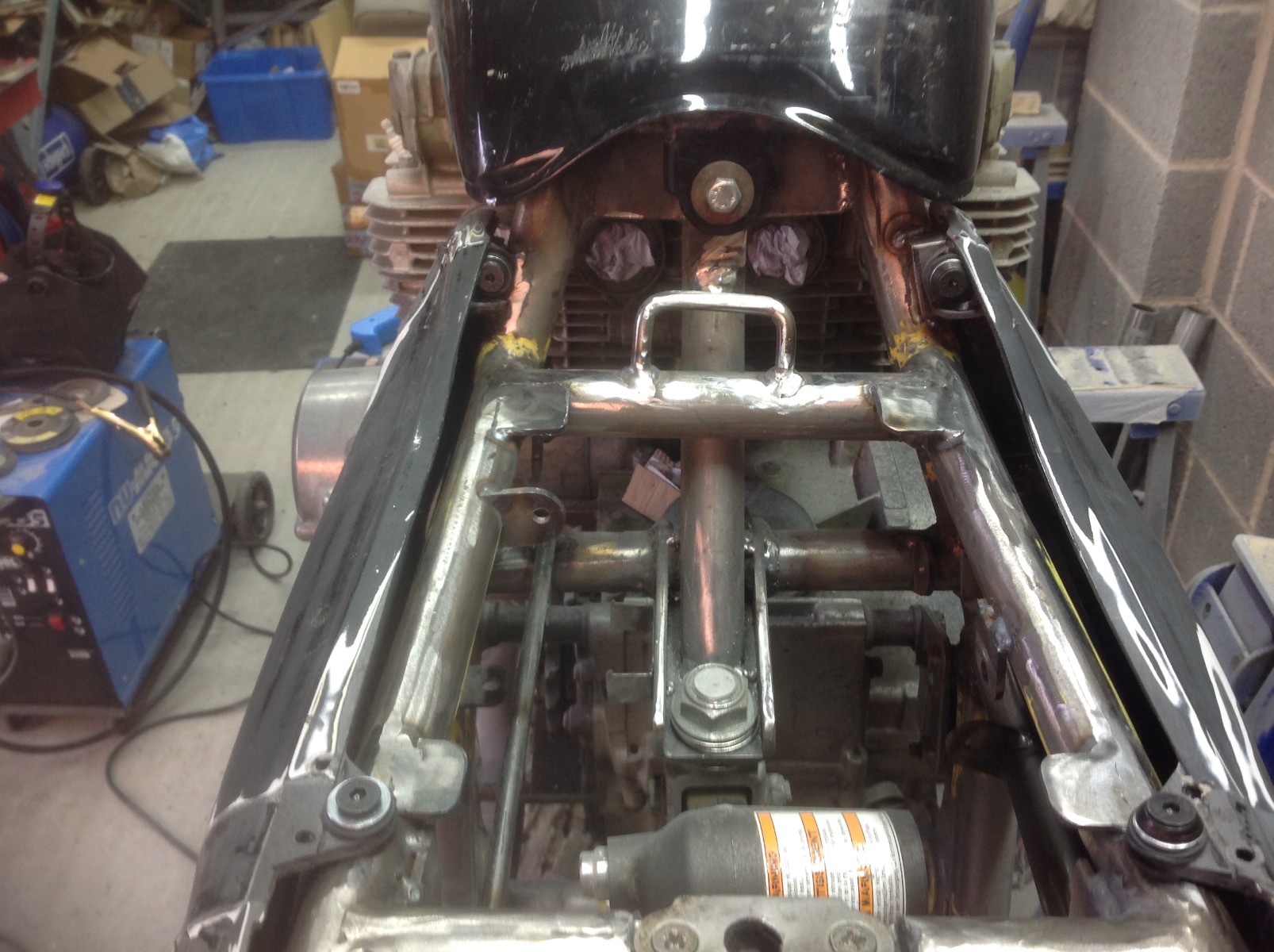

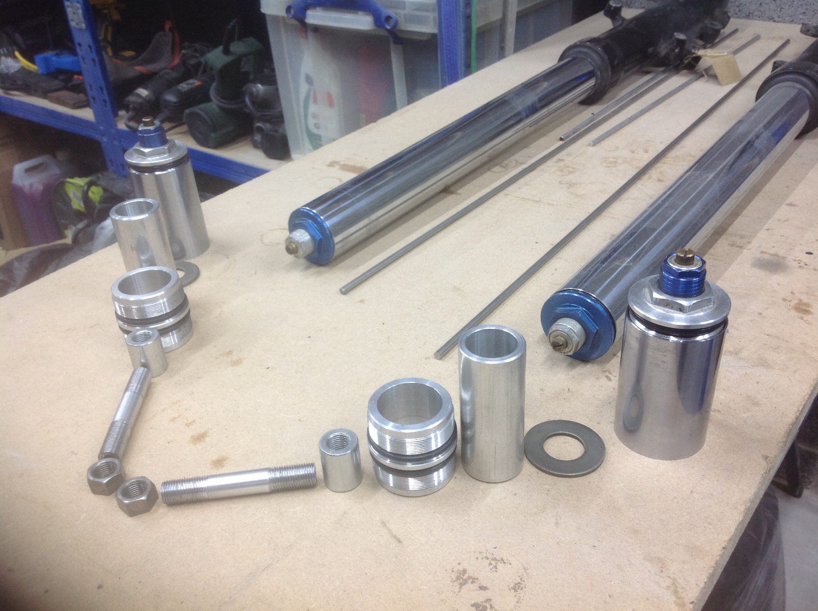

After Saturdays biblical failure I took a day out on Sunday, tidied my garage and did some research where I came across a technique using a drill press to run a straight thread on blank stock. During the tidy up I found a couple of off cuts from the 600 damper rods long enough for what I needed so back on it tonight and "success" so the fork extensions are now ready to fit. The tree's are on (where I reduced the stem to take the KZ lower bearing I have pressed a stainless insert into the bottom of the stem to replace the strength removed by the diameter reduction. 7mm of of alloy off, 13mm of stainless in)

I managed to get the forks built up last night (I use an old bottom tree with broken lock stops that I picked up cheap to hold forks in a vice without damaging them) really happy that the parts I waited so long to have made fit like a dream and as the extensions are harvested from a scrap pair of 600 forks they look almost stock (just 46mm and fully adjustable)

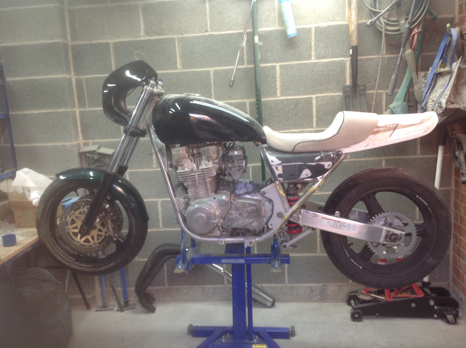

12 Nov 2022 10:28

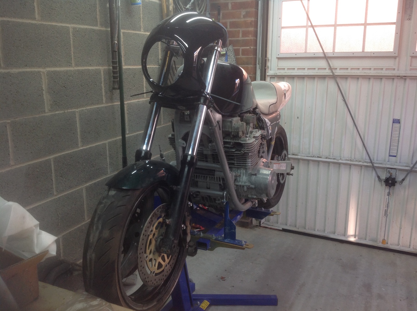

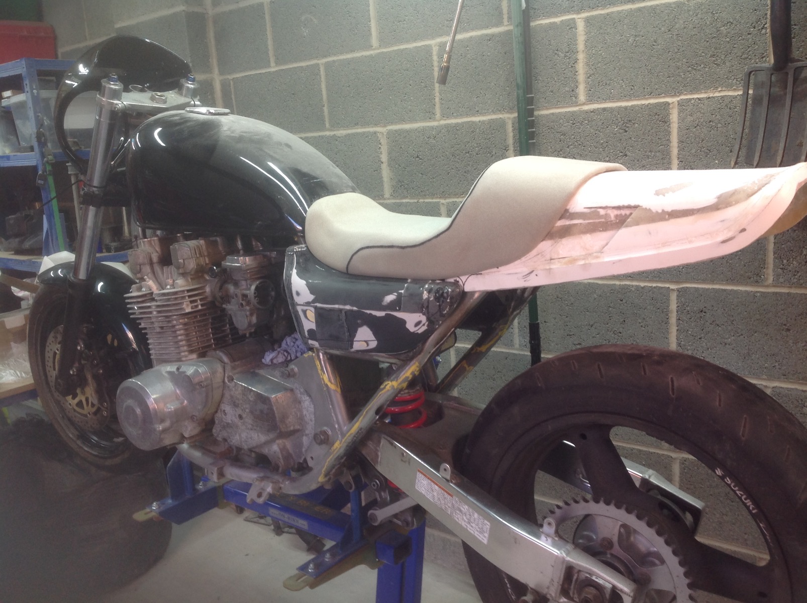

With the forks back together I decided to test fit the front end (and then I got carried away and threw lots of other parts on too) I have to say I am really happy so far, don't know what you guys think but I think the donor parts I have harvested really work well together (visually at least, time will tell) I don't think that in these pictures it is immediately obvious that there are parts from 8 different bike (including the original) being used

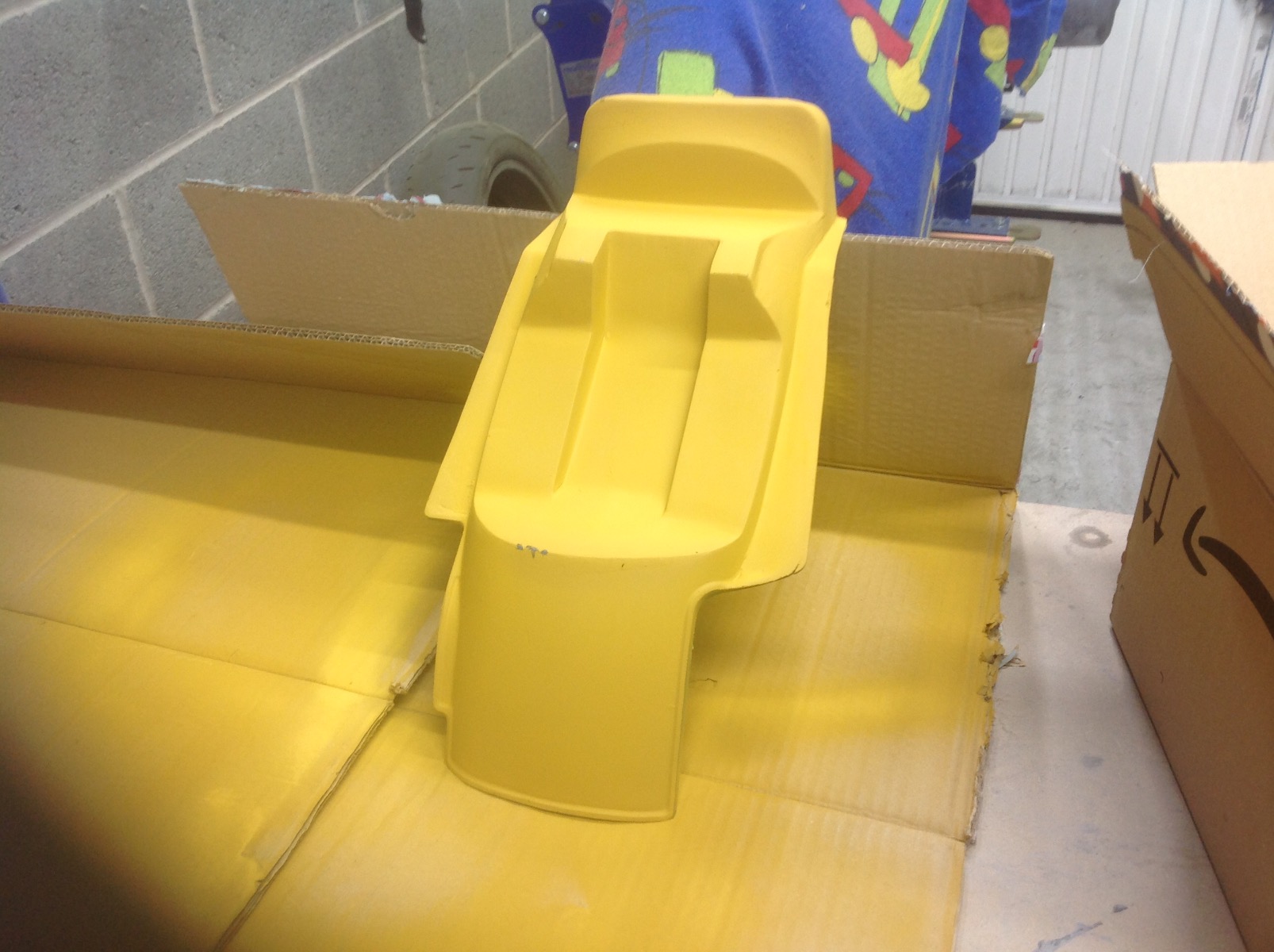

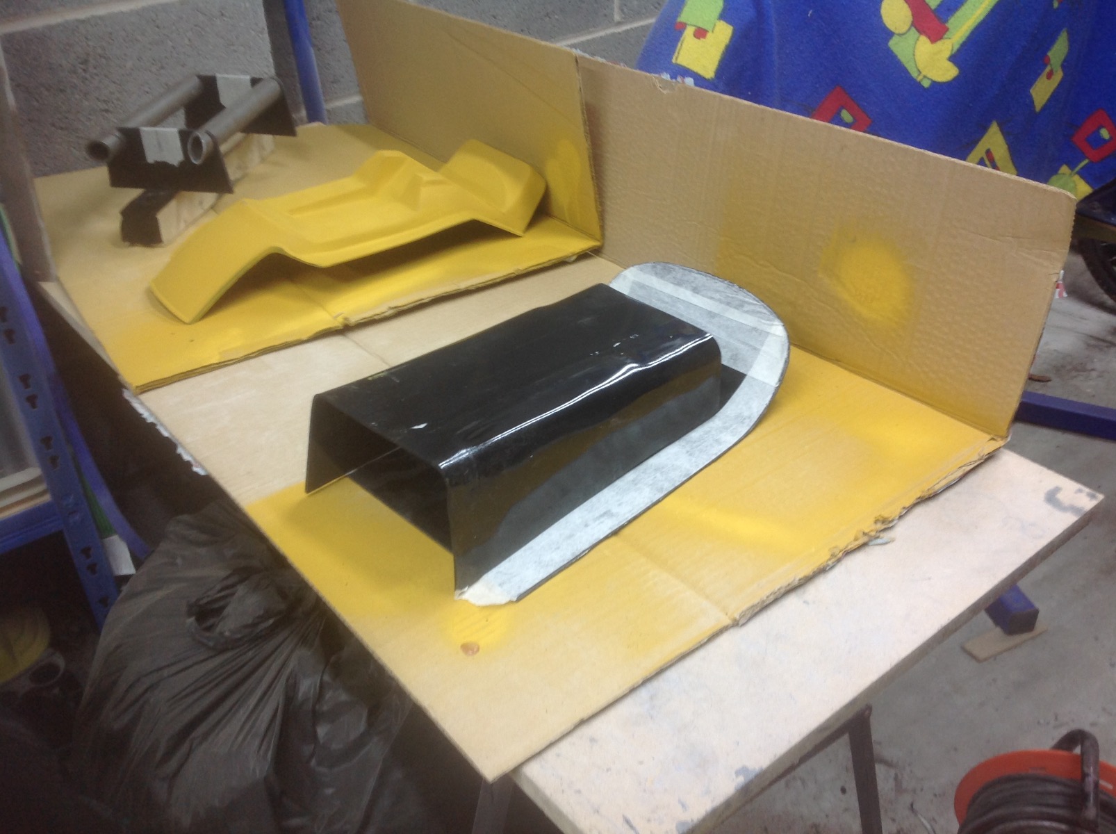

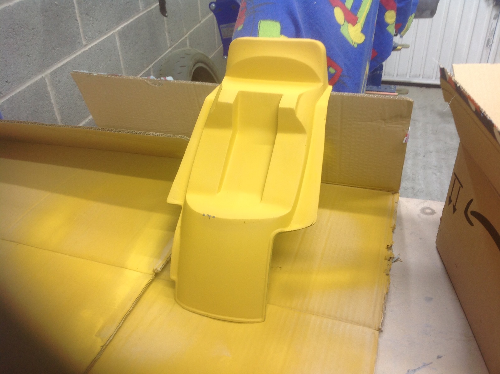

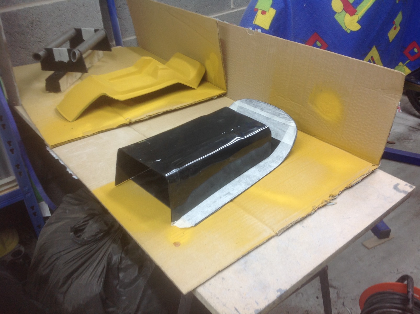

Been struggling to get much time on the bike currently between work and Mrs Wookie (the heating Sprung a leak a few weeks back and the water came through the kitchen ceiling, I have had to decorate the kitchen before the mother-in-law comes for Christmas) so with my duty done I have managed to wrap up the rear inner fender today, I have left in high build for now until I have finished messing with the rear section/closing panel.
A flat panel would have been easier but as I have said before I am trying to end up with something that "could of always been that way"

Re: And finally, Wookie's 82 begins !
27 Nov 2022 12:07 - 27 Nov 2022 12:32
Looks like an original part, impressive!
Your bike will look kind of the Z900RS when done (which I think is among the best looking modern bikes)? Have you thought about color?

27 Nov 2022 12:14I will be more than happy if it has a hint of 900RS about it, at the moment I am thinking Audi "Nardo grey" and "charcoal" with the two shades of grey split by a narrow "Porsche racing orange" stripeLooks like an original part, impressive!
Your bike will look kind of the Z900RS when done (which I think is among the best looking modern bikes)? Have you tought about color?

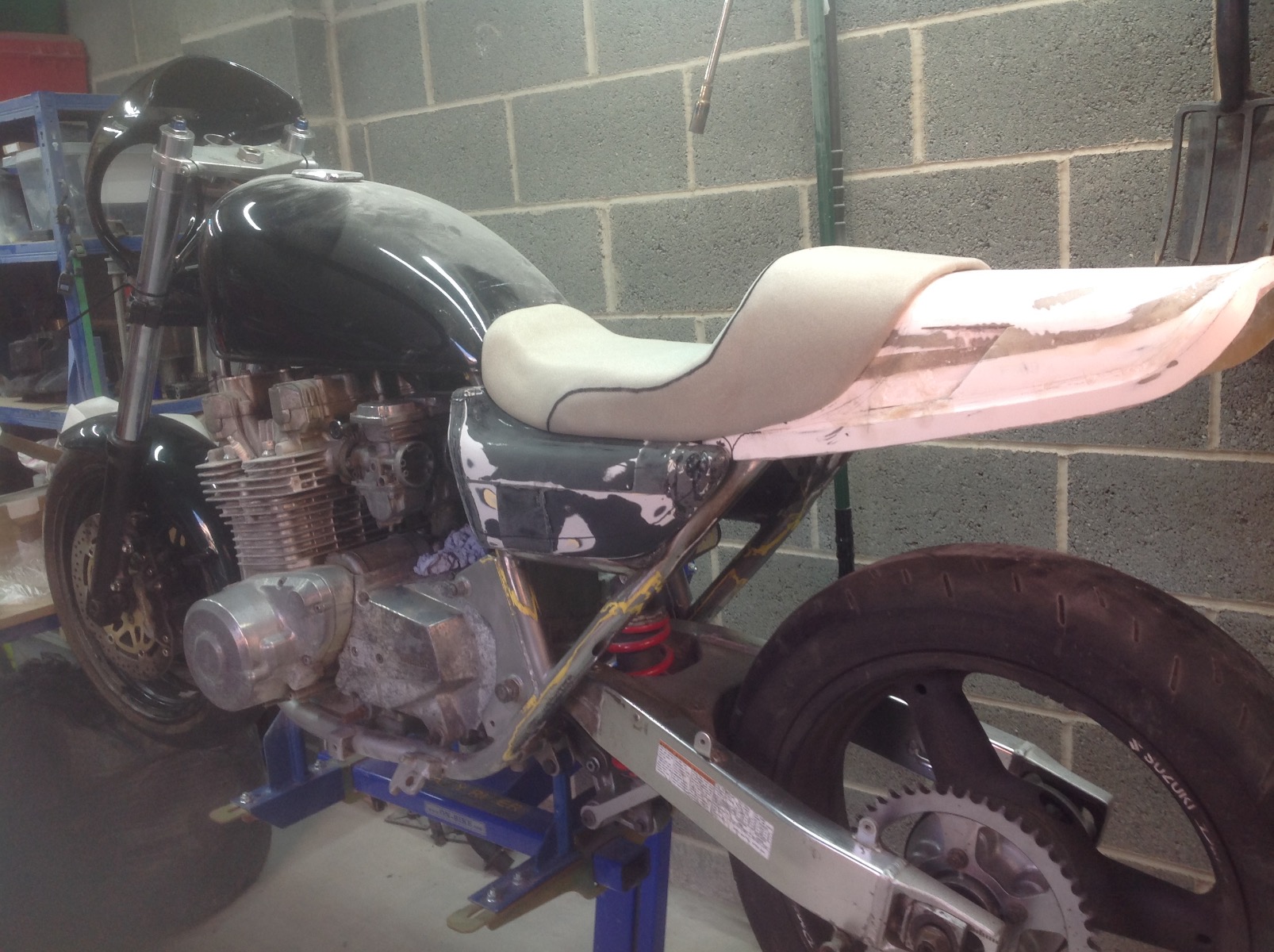

I have been braving the cold today for a few hours (-1 degrees) to make a start bending some plastic for the rear outer fender/light closing panel, also to keep things moving forward I dropped the seat at the trimmer on Friday so in 7 - 10 days I should have the first "completely finished" part

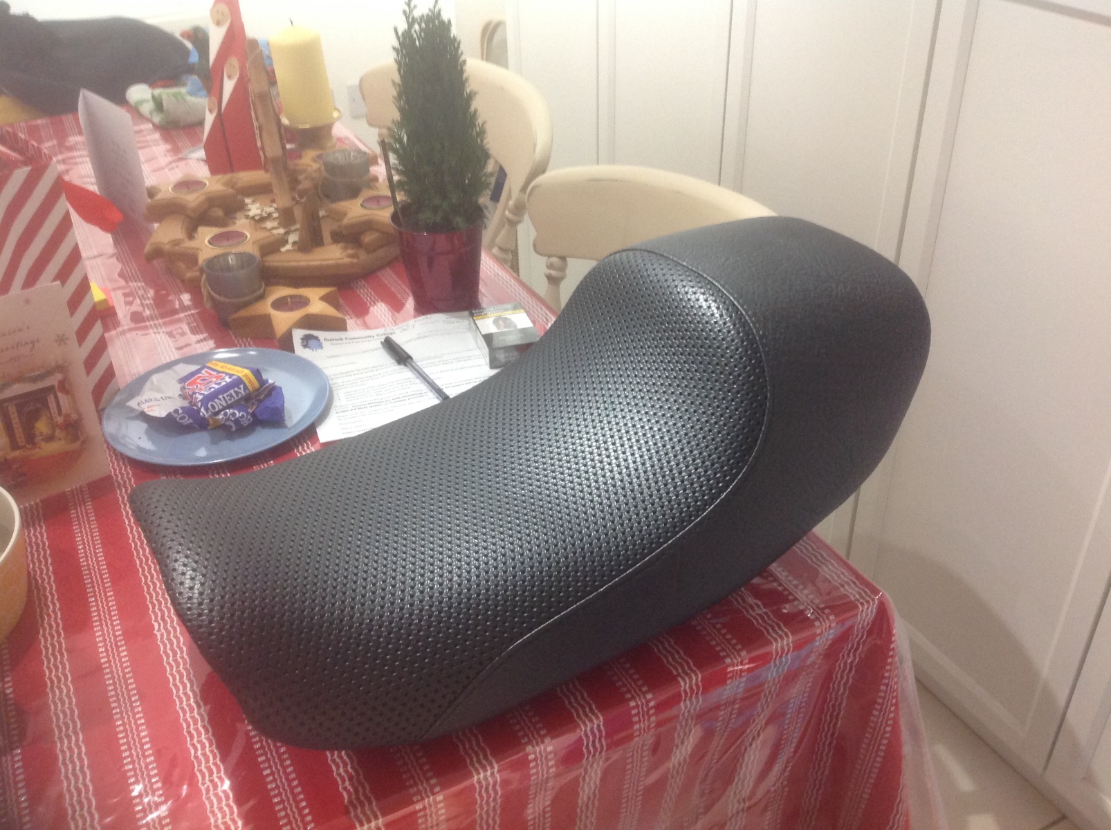

Not getting much time in on the build currently but I did pick my seat up from the trimmer. I couldn't be happier with the result and for a very fair price. Happy to share his details with any UK guys that need seat work. Milestone moment as this is the first 100% finished part
