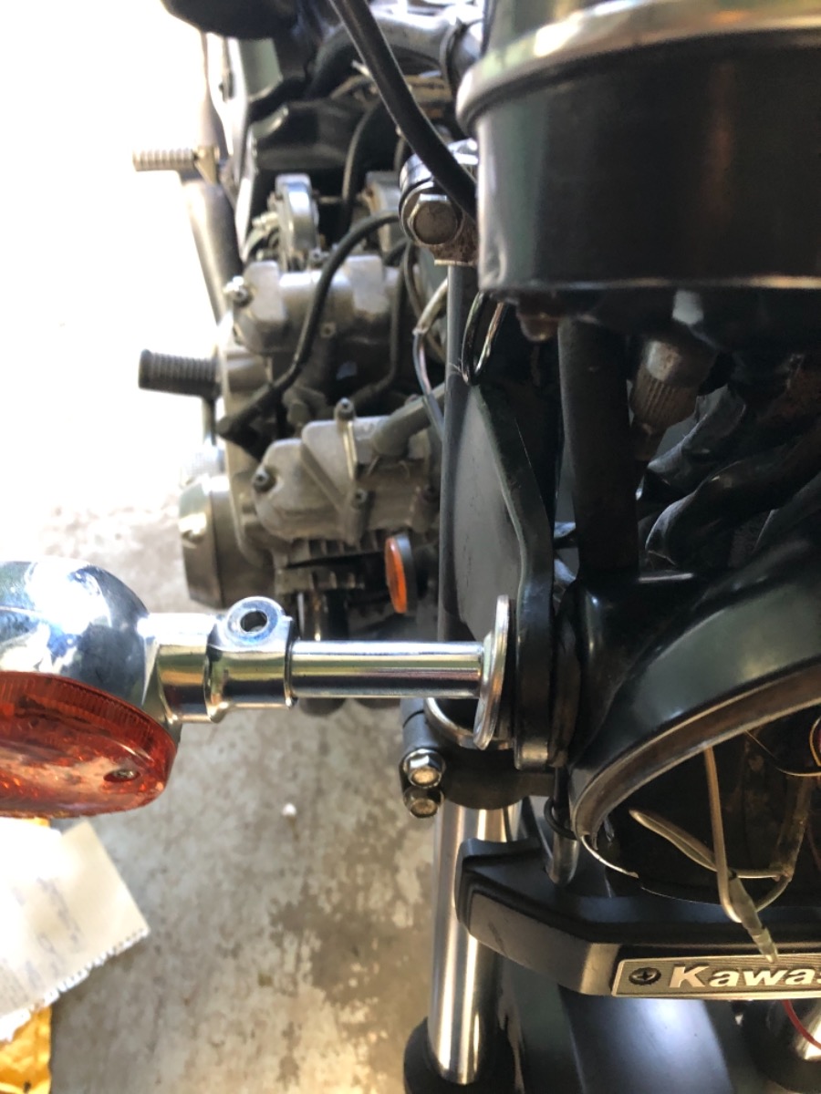

Spent a few hours taking things apart, mostly digging into the cable and control wire routing, and waging war with the headlight bucket.
I LOVE how easy these things are to work on, and how well built everything is. It only gets tricky when you’re trying to undo somebody else’s leavings.
Much as I love the current tachometer, I decided to find a replacement. Turns out a KZ440 tach doesn’t fit: it’s a little smaller and only has one gauge bulb. Oops.
But it already looks like the MacArthur Maze around the gauges anyway, so I took off the tank and started untangling the mess, and of course I found more wrong as I dug in.
The Speedo cable wasn’t routed through its retaining loop at the brake line junction, and the tach cable is on its way out. Throttle cables are old and kinked; PO had strangled them with a cable tie around the top tube.
I pulled off the headlight, which was loose in its bezel. Somebody had missed the Tab A/Slot B part of reassembly, and I had to take it all apart to pop it back together again. This started a long fight with all the rings and springs and tiny screws, though I’d imagine those of you who are into needlepoint would have had an easier time of it.
I went on to the headlight bucket, intending to reinstall the original blinkers, but found one of the stalk mounts broken at the Grounding Wire Bung Backing Thing. So the bike must’ve been dropped or whacked on the right-front at some point, which would also explain the munged tach and bent headlight mount. (I was just going to take off the damaged mount and jump up and down on it until it was about the right shape again, a technique commonly used by bicycle mechanics known as “cold-setting.” And I can probably just thwack the headlight bucket back into shape.)
But all the little rubber bits for the ears were there and in generally ok shape. PO had snipped the blinker wires and used the ends to splice in his own cheapo minis. (Kudos to him for not tearing into the main harness.) Thanks to @loudhvx for posting the wiring diagram; it came in handy when sussing out the mess.

I generally like to keep the front turn signals stock because they are the most important and are protected by the handlebars. The rears I tend to make a little smaller so they don't get knocked around when parked.
Also, If I were you I would ditch that hell-piece of smog equipment known as the Air Suction Device. It can cause all sorts of issues that are difficult to track down.

Spent most of the past couple of days successfully avoiding the carburetors, concentrating instead on running new throttle cables and fixing or rerouting the wiring away from Completely Awful.
The throttle cables needed some sorting. I’d ordered two of them (a “push” and a “pull”); both ended up having the same part number. So the right (return) cable is too long. I’d love to shorten it, but I don’t have the parts or the equipment.
I spliced the broken wires back together and replaced a couple of bullet connectors, stuffed all the entrails back into the headlight bucket and put it all back together, and then routed (and rerouted, and rerouted, and rerouted) the mess of wires and connectors and cables running along the top tube until I was vaguely satisfied.
I had tested the horn when I first bought the bike; it gave a plaintive “bleet?” and then stopped working altogether. This weekend I traced the issue back to the button, so I took apart the lefthand switch and cleaned/greased the contacts. So now it goes “Blatt!” I also tried out an OEM horn from my Versys (which looks suspiciously like the same one that was vin my old KZ550) (“Honk!”) and a Wolo Loud One (“Boop!”)
I’d really like “Boop!” but it doesn’t fit in the stock position, so I’ll stick with “Blatt!” for now. I was thinking of eventually mounting “Boop!” somewhere behind/under the battery box; seems like there’s a lot of space back there. But then again it might be muffled there, and it’d be right under my arse. So I dunno.)
So I think I figured out all the spaghetti under the tank, after a bit of trial and error. (Do the throttle cables go over the tank ears or under?)
Also: I was really excited to try out my new grease gun on the swingarm bearings, and shot in a full canister of grease, but didn’t see any old stuff come out. Then I shot in a second full canister, and then gave up. (If it starts coming out the top of the airbox you know you’ve put in too much.)
