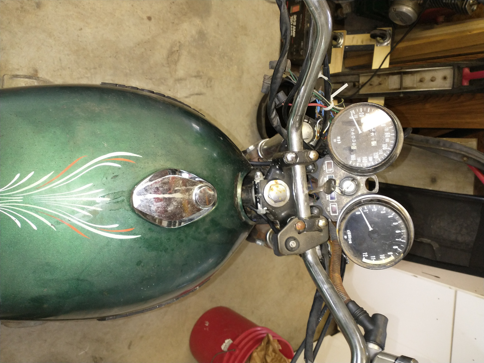

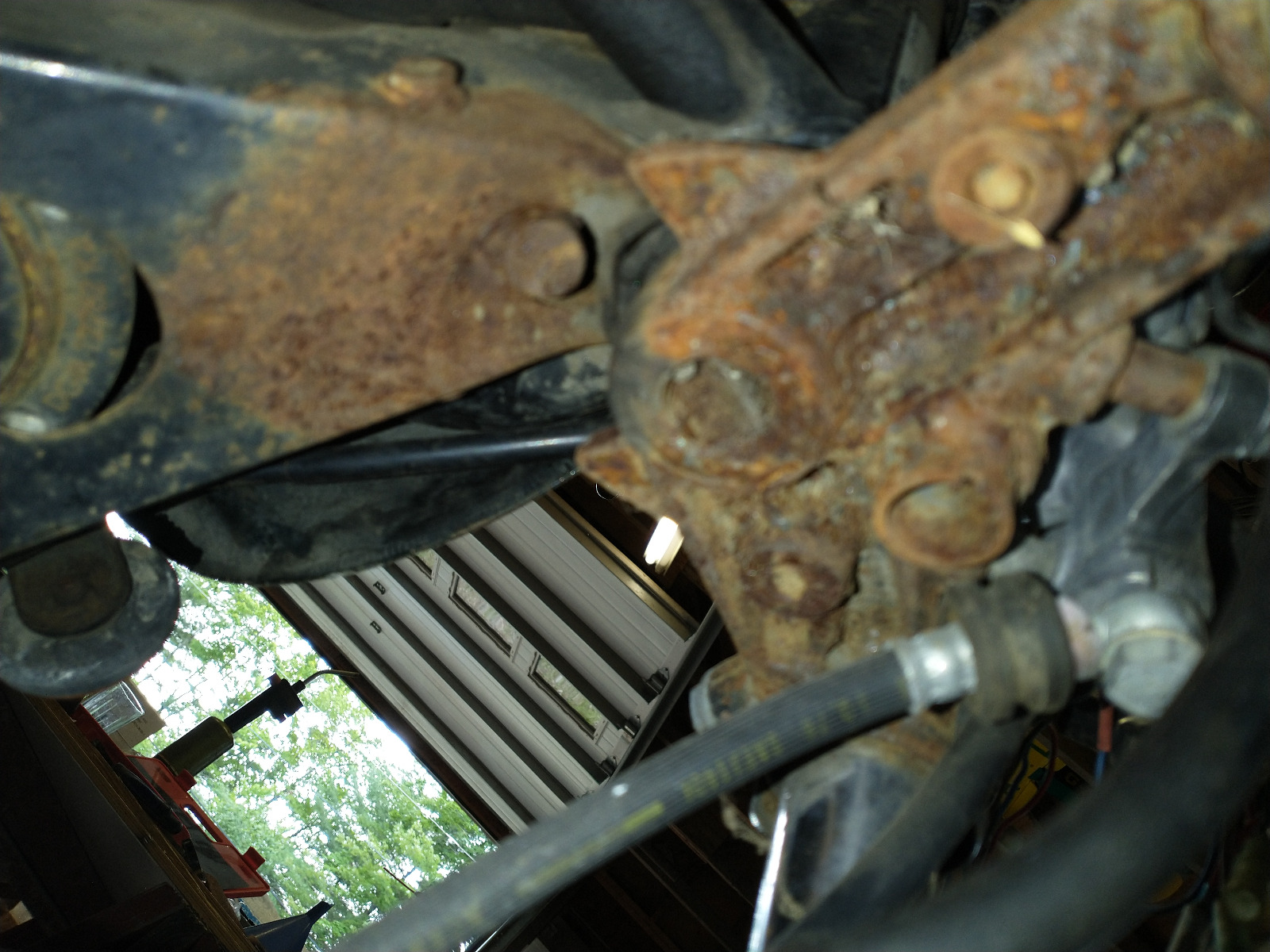

I've had this for a while, won't bore you with details, bike has many issues; bent steering stop, broken rear shock stud,messed up wiring, wrong steering stem head and gauge pods, gutless kerker...It will be a driver (hopefully) not a restoration, but any input will be appreciated

Are those wheels Lesters?

sorry, been thrashing, good thing i took off the rear wheel, brake shoes were un glued.  someone said they were

sorry, yes they are lesters
  • hardrockminer
  • hardrockminer's Avatar
  • Posts: 3118
  • Thanks: 1230
Re: absolutely beat bike
25 Jul 2021 04:30
#852498
It was a common mod back in the day and highly sought after nowadays.

Sorry, meant to post project updates too. Finally got the right stem and head set so I could install correct dash and idiot lights, new tires, mac baffle for my $100 beat e-bay kerker, which sounds amazing. Motor is a 78 kz1000 b2 and carbs which have the 3rd carb vacuum port which I plugged after the first ride. carbs only have pilot air screws on bottom back of the float bowls, looks like the idle air screws are blocked off. The bike runs well enough to drive,but pops once in a while, sounds a little off, btw haven't synced carbs but bought the vacuum gauges to do it. today i will fab a center stand stop so it doesn't hit my chain and work on a horn.
