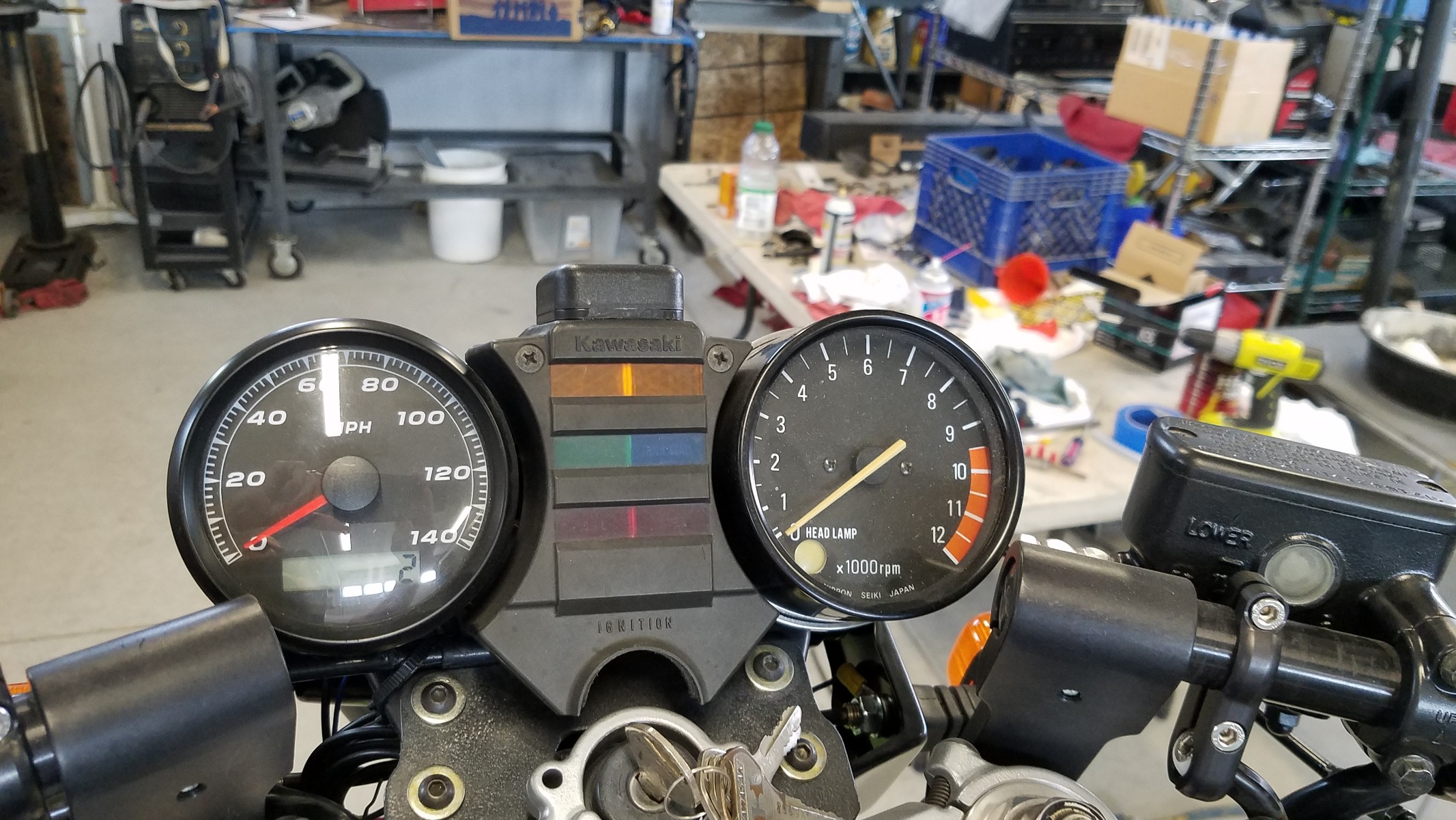

The instrument pod.. tacho/speedo/idiot lights arrived, along with the handlebar switches from Motogadget, which work well with the M-Unit. Finally went for something I've not tried before.. the speed sensor for the speedo works via GPS. No need for any wires/magnets on the front wheel.

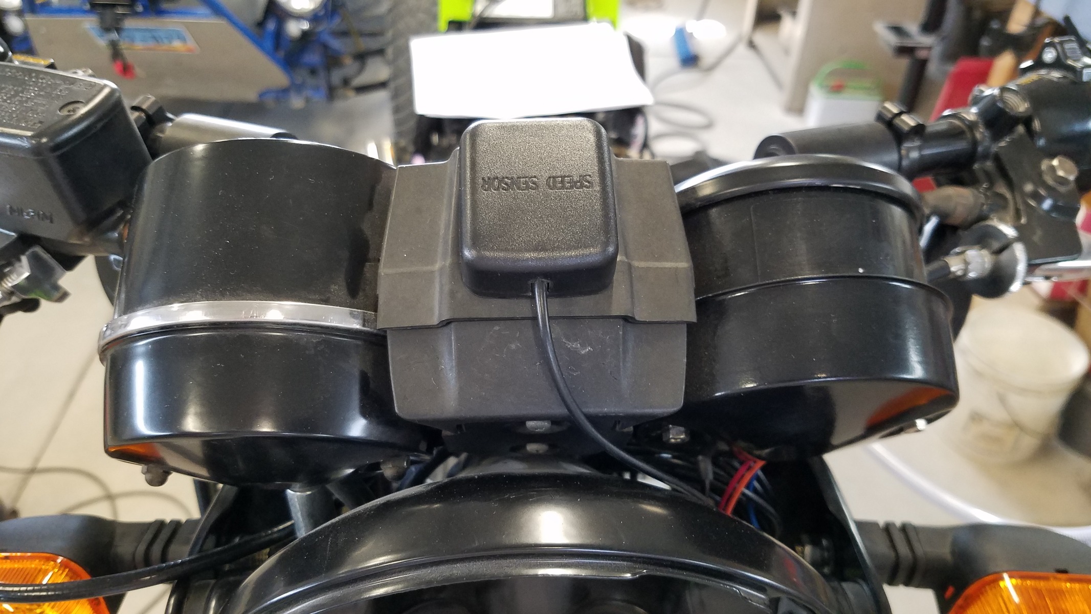

NIce project. I'm curious about the accuracy of the wireless/magnet-less speed sensors.

Me too, according to google.. Under right conditions, such as unobstructed location under a clear sky, it is accurate within 0.2 miles/hour. What this means is that as long as the device has access to the GPS satellite, it maintains its accuracy.
I have also been told, though not checked yet, the the GPS sensor needs a sight of the sky to work, so cant fit it under the tank or seat etc.

The headlamp mounts are 70mm from the fork edge to the centre of the mounting hole. That said, I'm using an 80mm diam. instrument pod, which is smaller than the OE speedo and tacho set up.

Thanks mate, I think mine are 100mm so they should be ok, I'm using later 1984 GPZ gauges, they don't take up as much room as the stockers, My bike is, or was a GPZ 750 R1..

The GPS sensor I have is white, perhaps it could be painted black to help hide it.. something to think about..

I have mounted Speedhut GPS sensors under the tail on my kz1000 and under the side-cover (positioned upwards) on my kz750 and they work in both locations although occasionally the side-cover one takes a while to acquire signal - up to 10-15 min every 30 start-ups or so. It usually acquires signal in less than 5 min. No complaints with the tail mounted sensor
