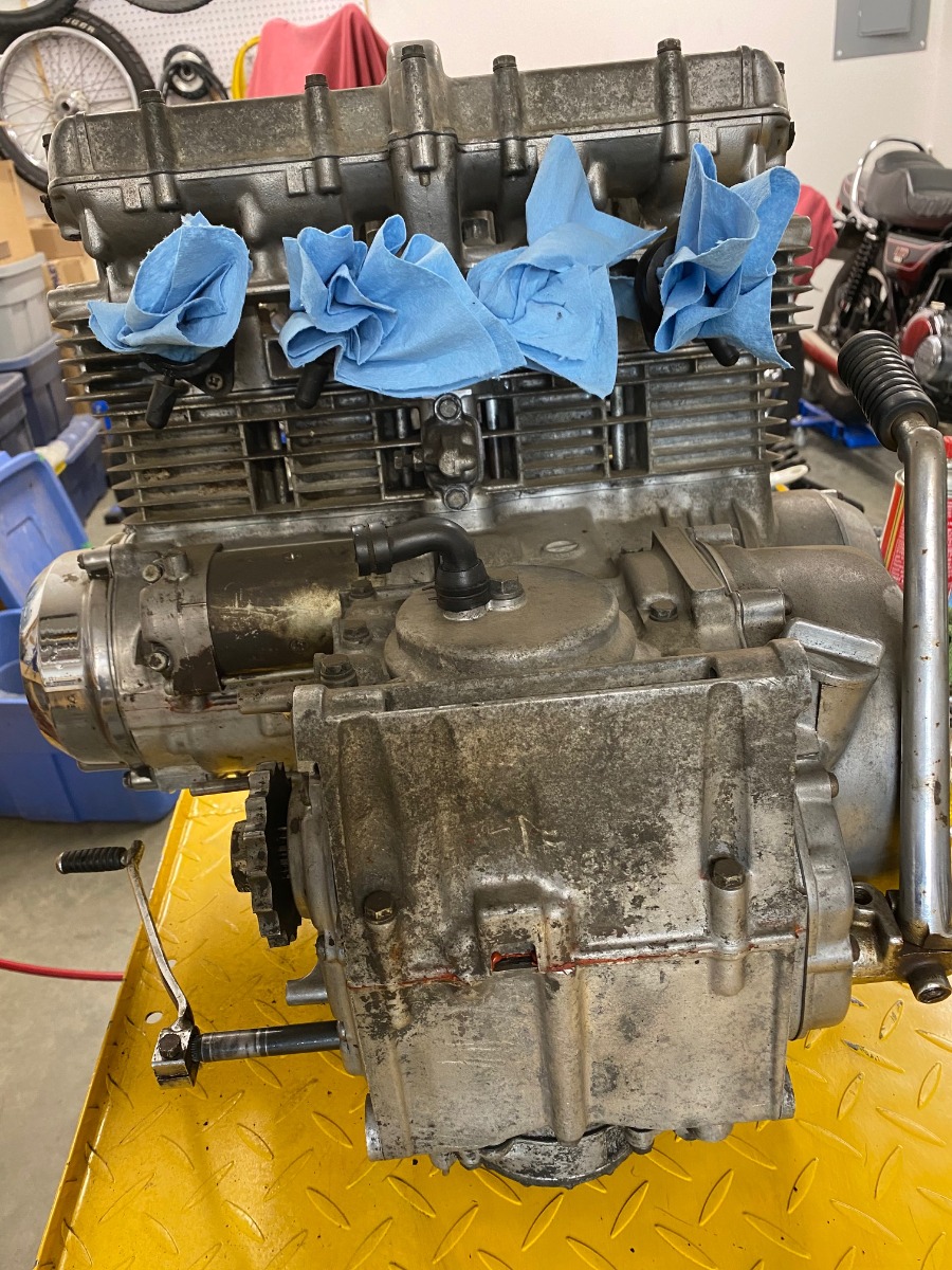

Photo of the back end, showing the dirt left on the engine during the PO's rebuild. He used Permatex on the cases and it looks to be a bit excessive on the outside. Hopefully not the same on the inside...this would have plugged the oil strainer if the engine had been run like that.

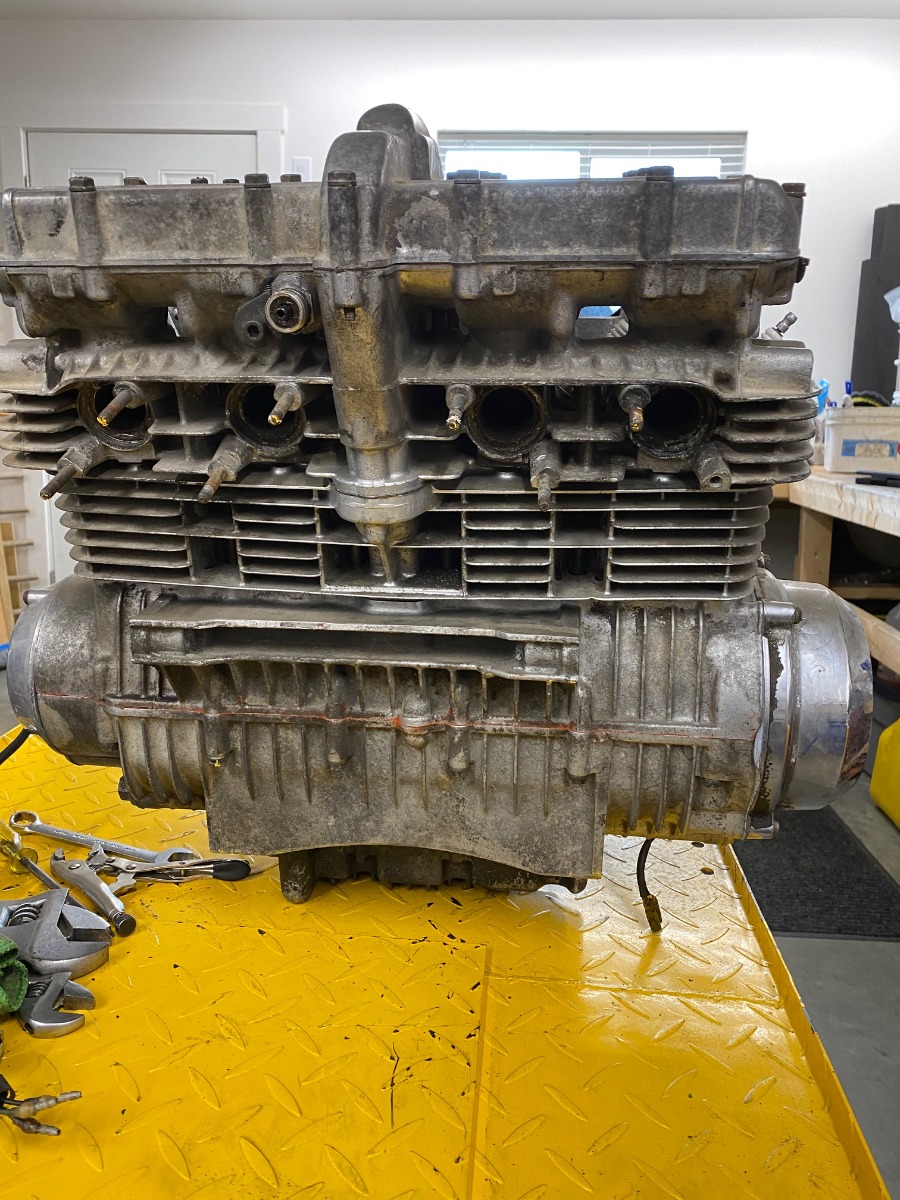

This photo shows the front...more dirt.

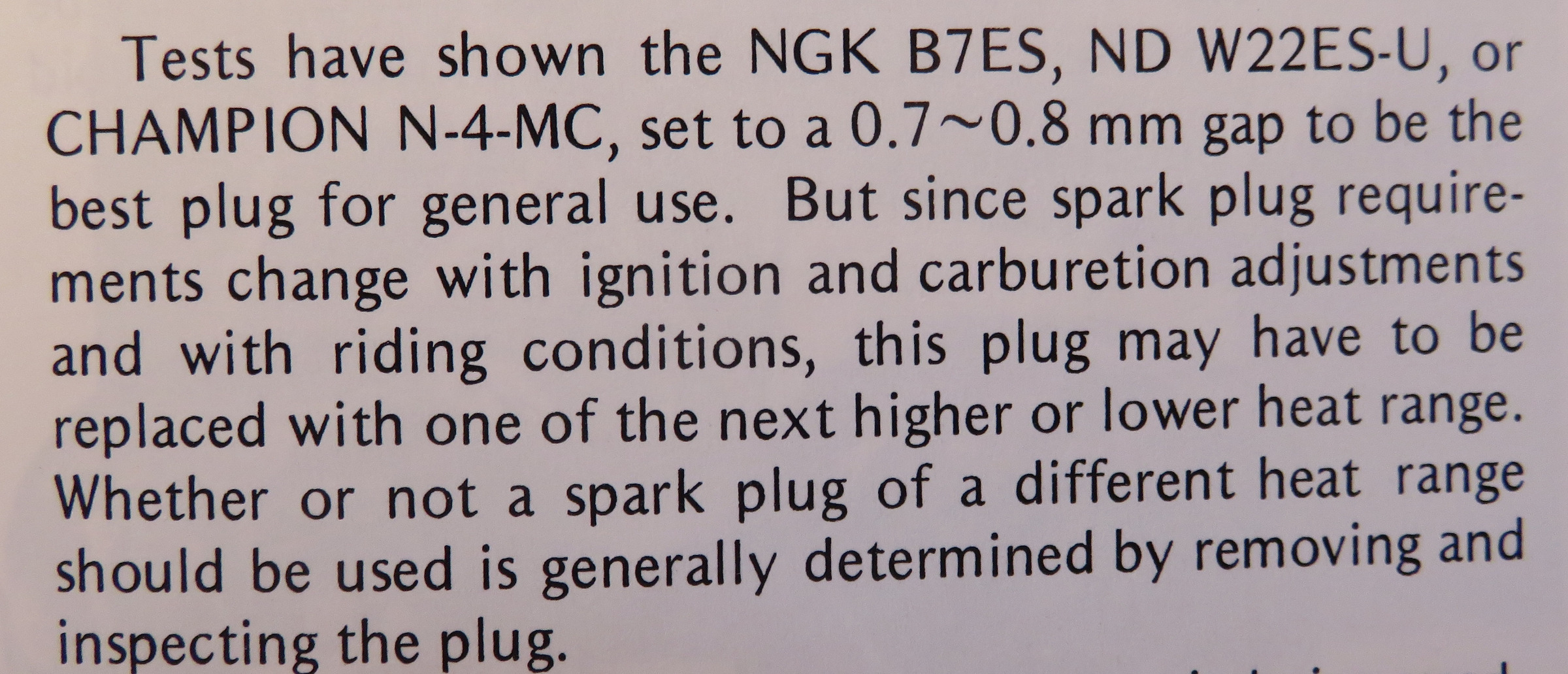

Be very careful about the plugs. The original manual shows B8ES but that was an error. Every later Kawasaki Service Manual specifies NGK B7ES or ND W22ES-U spark plugs. I am very familiar with this issue because I am the original owner of a 1977 KZ650-C1. The first time I changed the spark plugs I used those specified in the original manual and those plugs fouled and had problems. I bought a later manual and found the correction, and after changing plugs to the new specification I never had another fouling problem. I have found that the ND (may be labeled Nippondenso or Denso) ND W22ES-U spark plugs work great in my 1977 KZ650. Ed

Thanks for that information Ed. B7 it is then. The plugs I have are brand new.

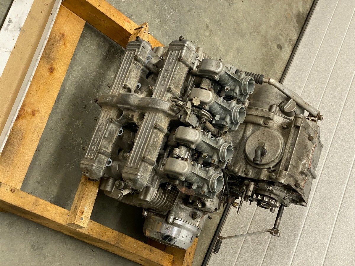

Here are the counter sprocket covers. If they fit one is yours.
If they are not 650, then I’d appreciate it if a member can identify them.
