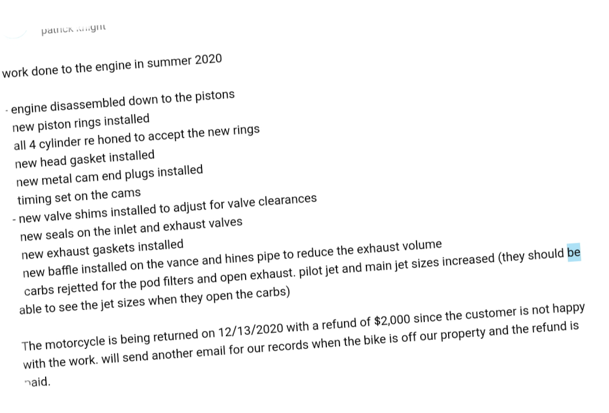

Re: I feeking giveup!!!!
12 Dec 2020 23:48 - 13 Dec 2020 06:46
Last edit: 13 Dec 2020 06:46 by Street Fighter LTD.
- Posts: 3118
- Thanks: 1230
13 Dec 2020 06:22
Basically he bought a set of rings, head gaskets and cam end plugs. Maybe a base gasket as well, because you can't change the rings without removing the cylinders, which means you need a new base gasket. Or maybe he re-used it? Anyway, not a lot of new parts....mostly his labour. Definitely not worth $3,000 in my opinion. But you got $2,000 back so probably the right amount for what he did. Assuming it was done well.
I thought he also rebuilt the carbs? No parts mentioned.
Your problem now is to figure out why the bike doesn't run well. You've already been advised to do a compression test and I agree with that advice. That's the first thing you should do or get done. It's a 20 minute job if you have a compression tester. Martin has provided instructions on how to do it. If you feel like you can't do it then maybe get a friend to do it or take the bike to a shop and have it done.
