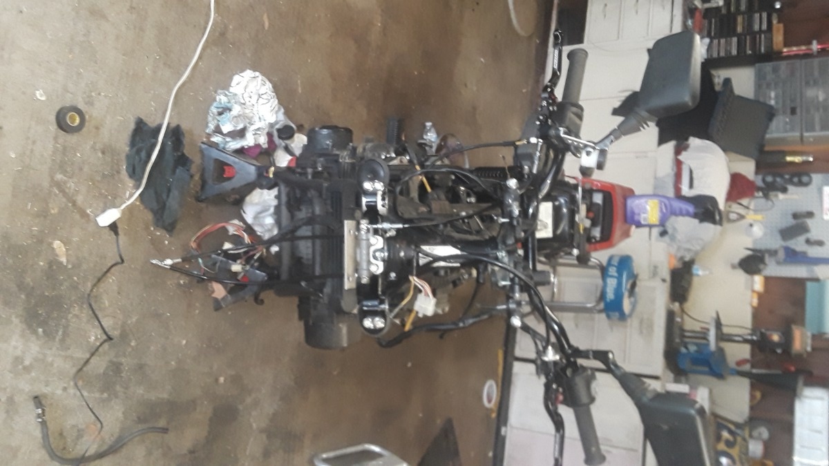

Sorry, no pictures to add yet, but the new (to us) wheels showed up last night and much to my surprise, the original cush drive & rubber fit the new wheels! Woot! :woohoo: :evil:

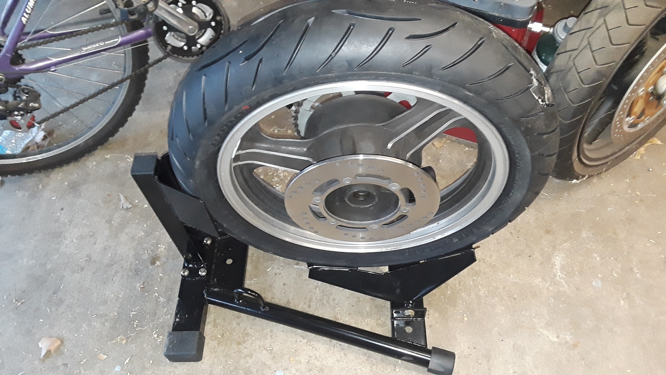

Re: Mrs. slayer's GPz1100 refresh & upgrade
14 Dec 2020 07:46
Rain on Sunday, so I got to spend some time in the garage. Got the rear brakes completely removed & disassembled. Nothing out of the ordinary. The usual quagmire of grime, filth & muck. Air and soaking required to get pistons out of bores. Biggest surprise was the Tokiko name on the (badly worn) rear pads. 1981 originals, was my best guess.

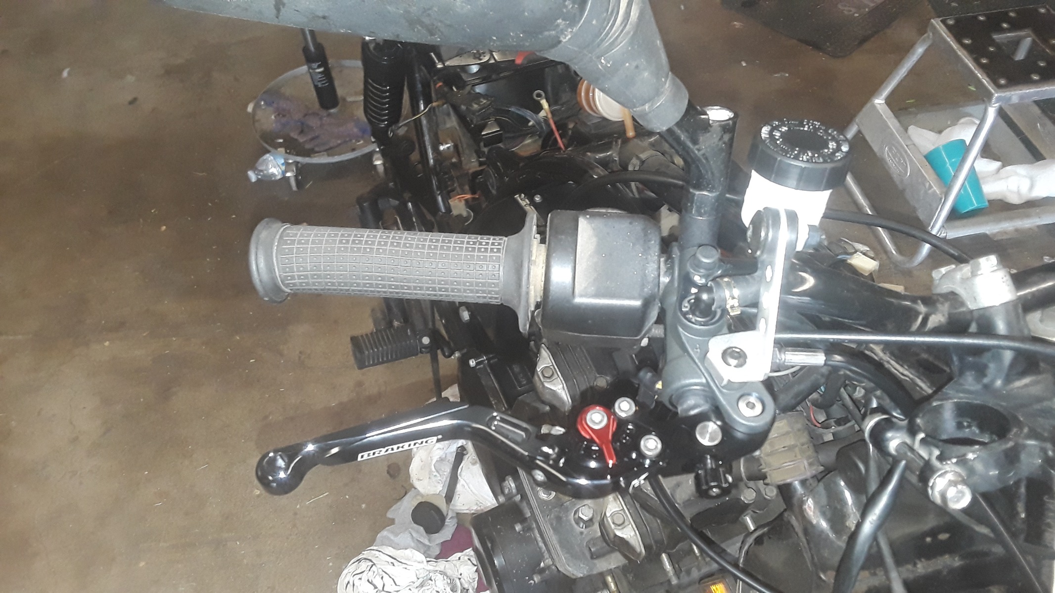

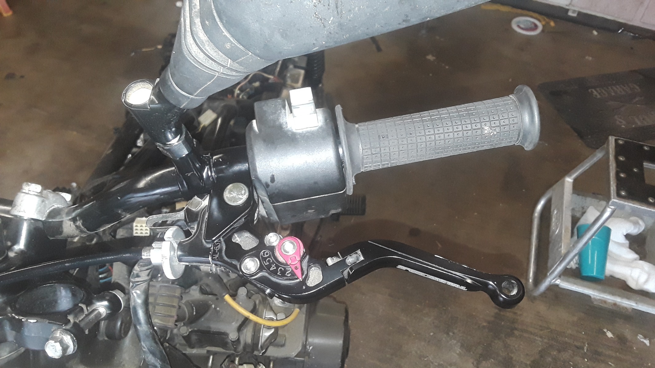

My wife has [strike]stubby little[/strike] shorter than average fingers. As a result she was attracted to my radial master cylinder on the Suzuki. After installing another radial master on her GPz with the adjustable lever, I found a matching clutch lever for her. She is pretty excited about it!

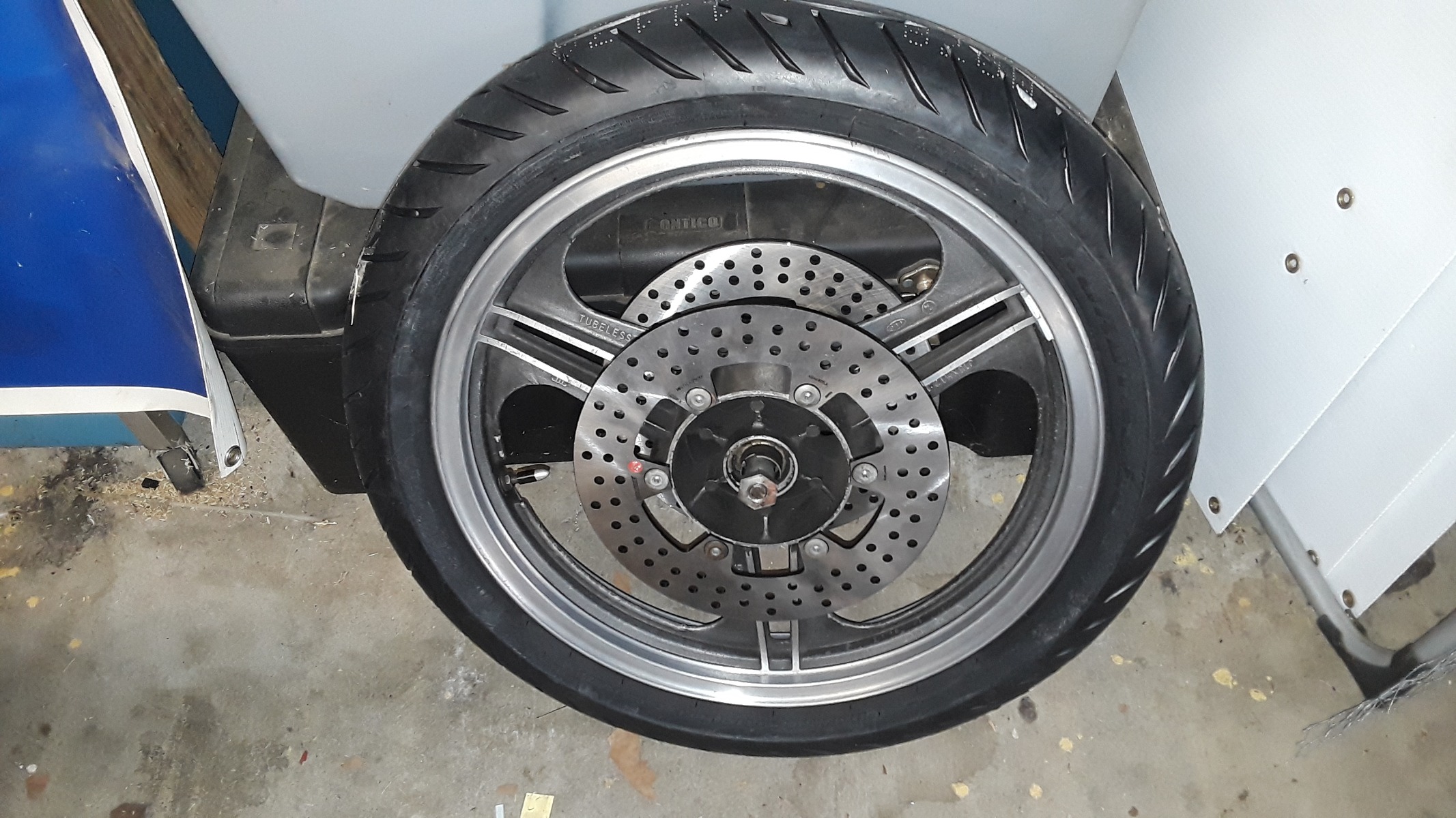

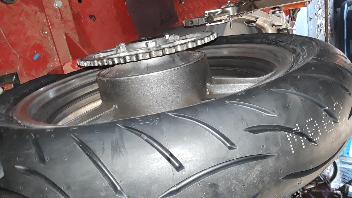

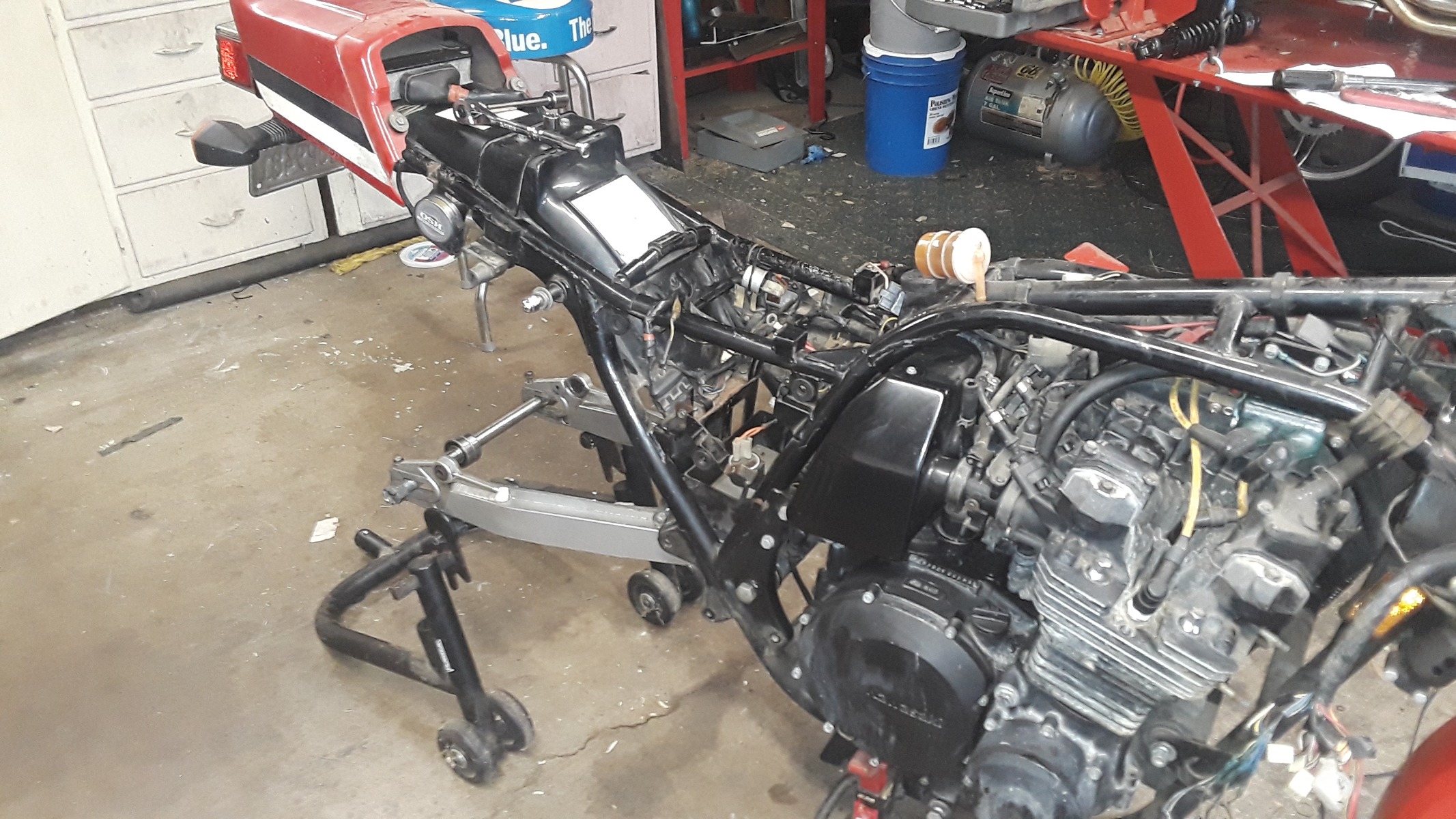

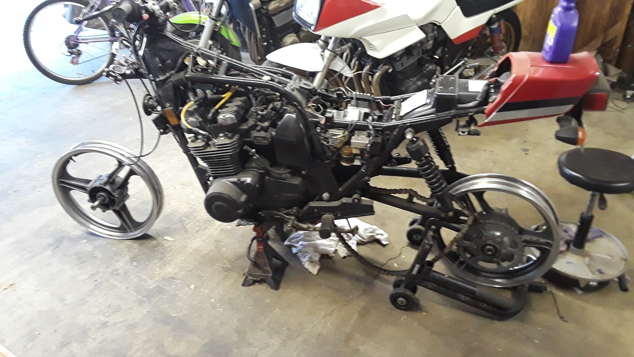

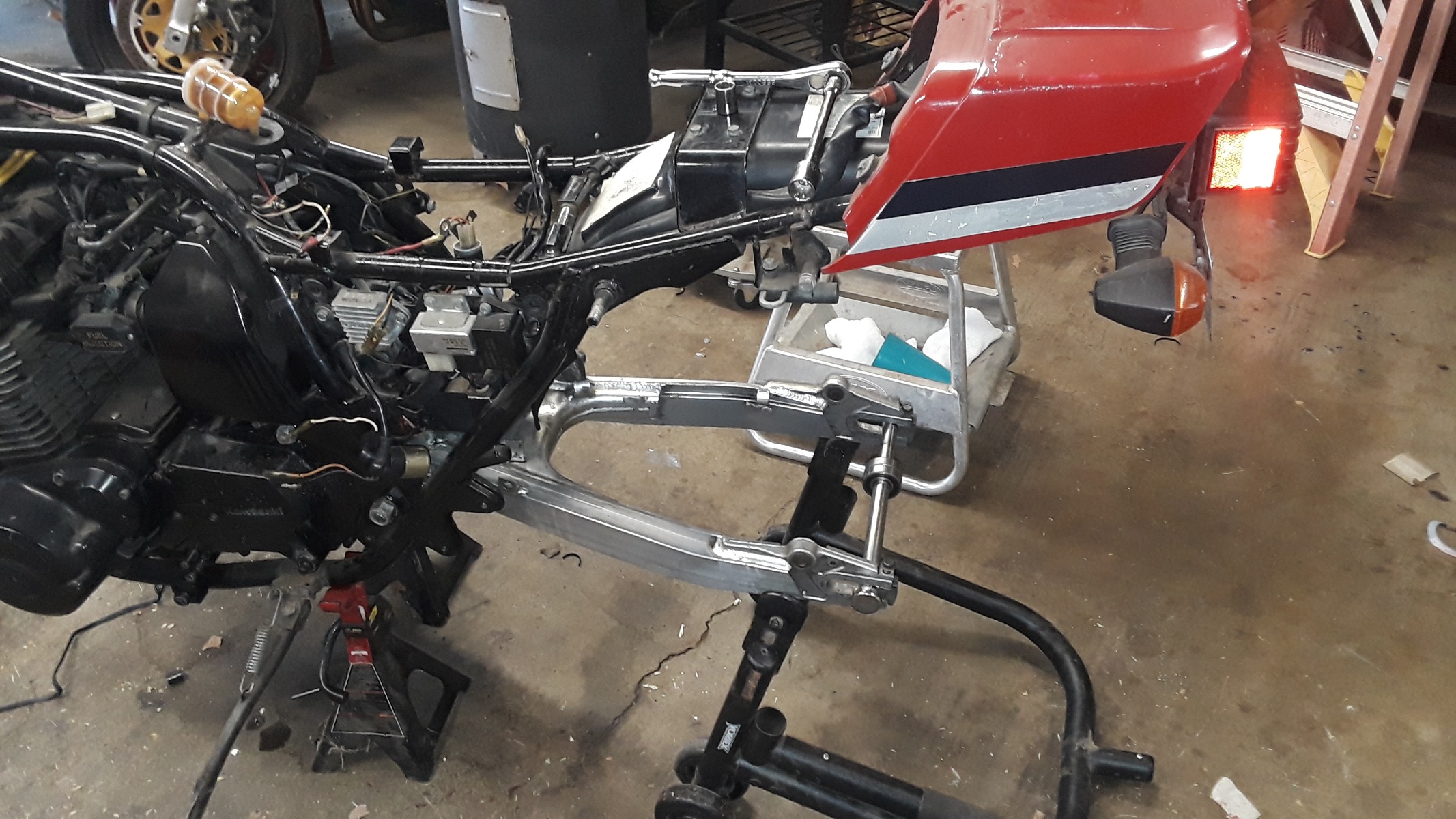

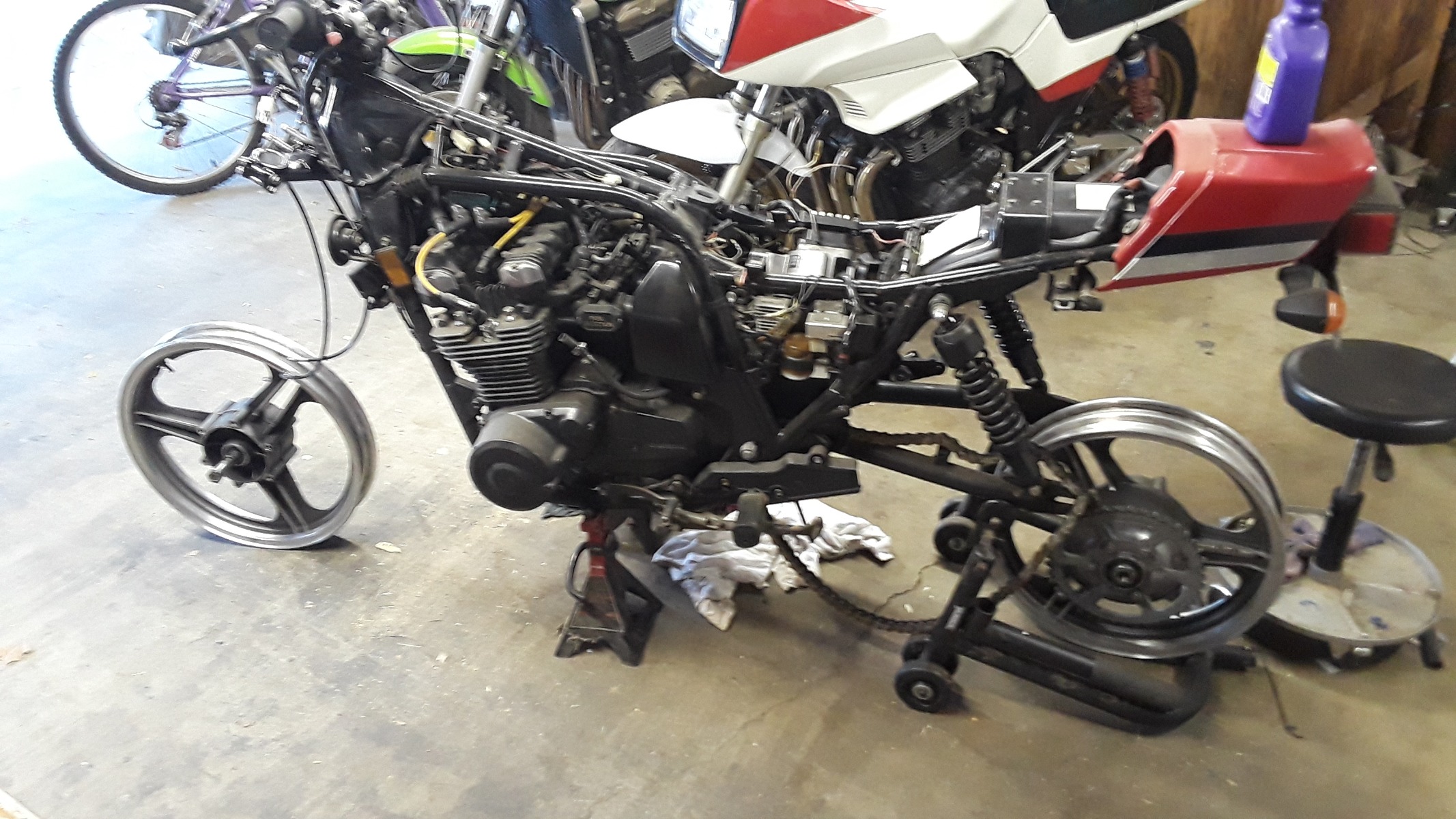

18 Jan 2021 08:18

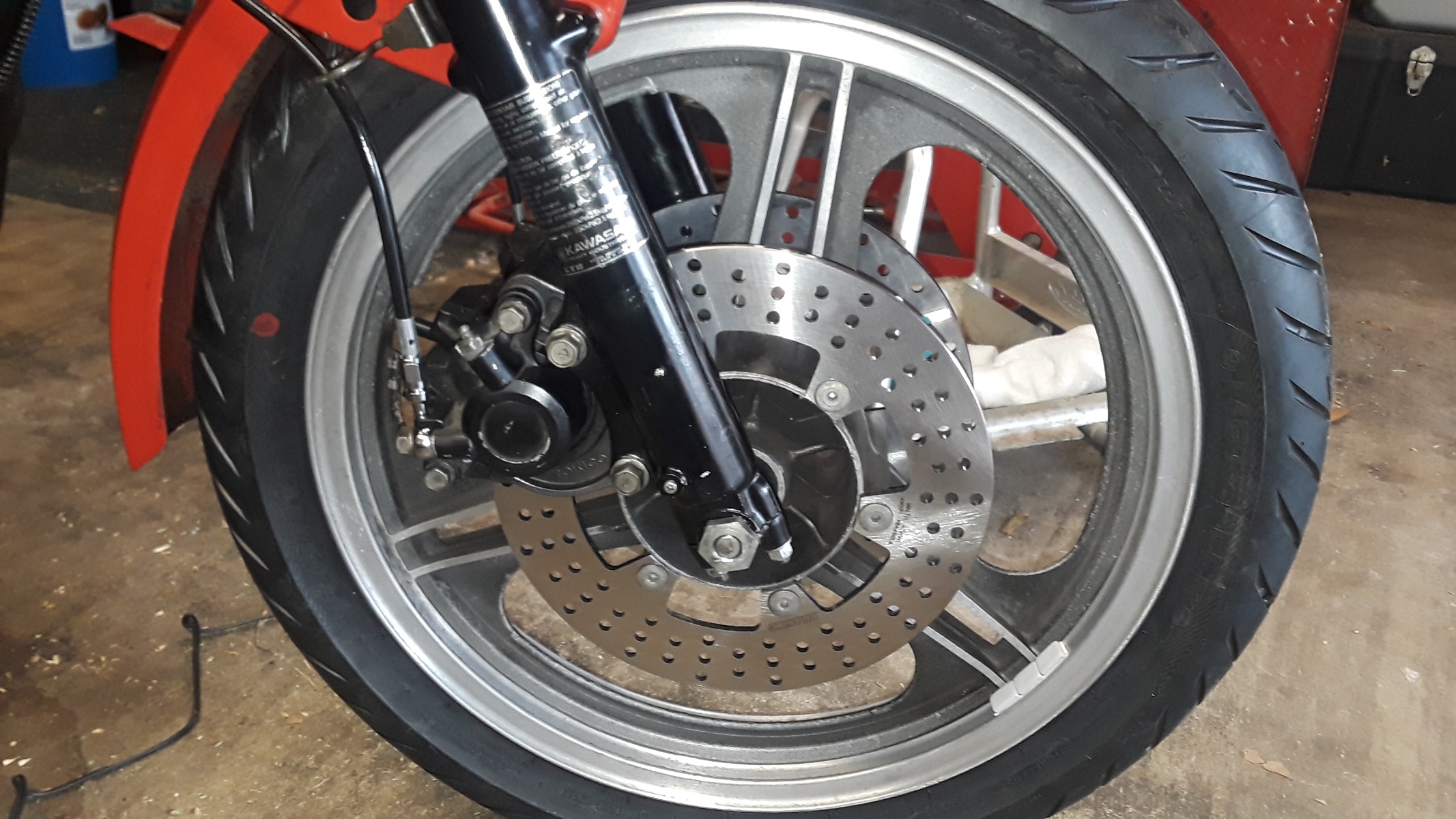

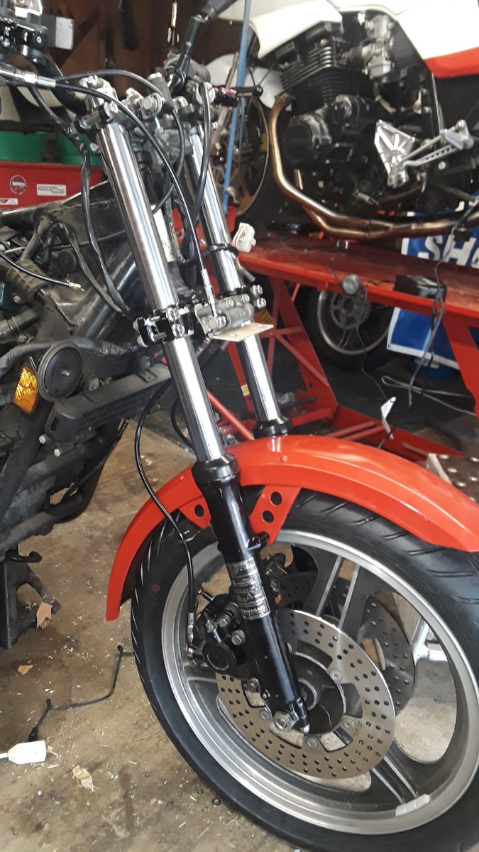

So the majority of the front end components have arrived & dry fitted for the first time. Pretty excited that the wheel & brakes from an '84 bolted right up to her '81. Small issue with the speedo drive, but I'm sure evilbay has what I need.
The fender stands a little tall of the 18" front wheel, but she's not opposed to it. I offered to drop it down a little, but she likes it as is... for now.
Also set the GS swingarm in for the first time. There is a little interference with the battery box/brake stay, but nothing a hacksaw won't fix.
Be safe guys.
Be safe guys.

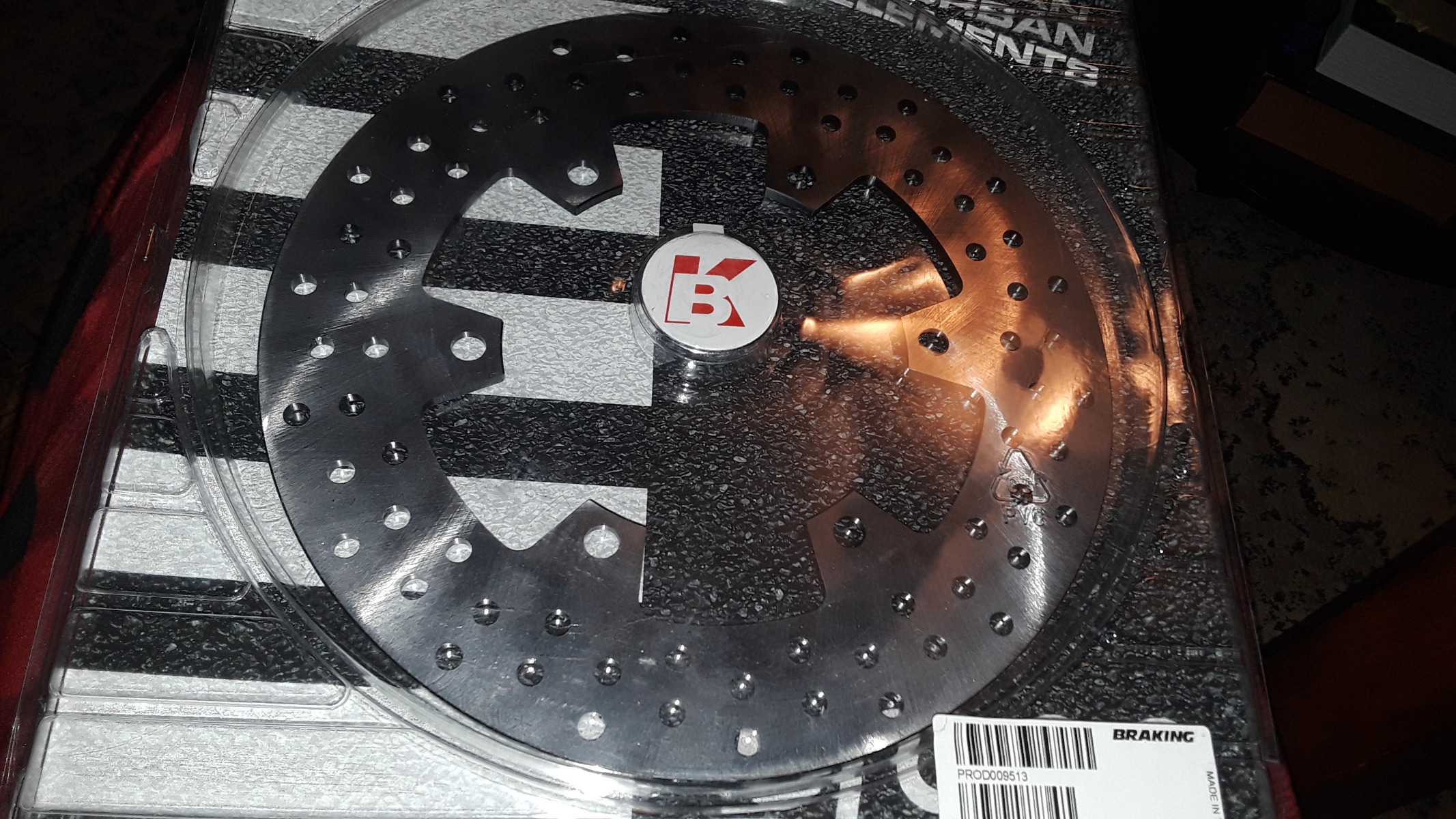

26 Jan 2021 13:18

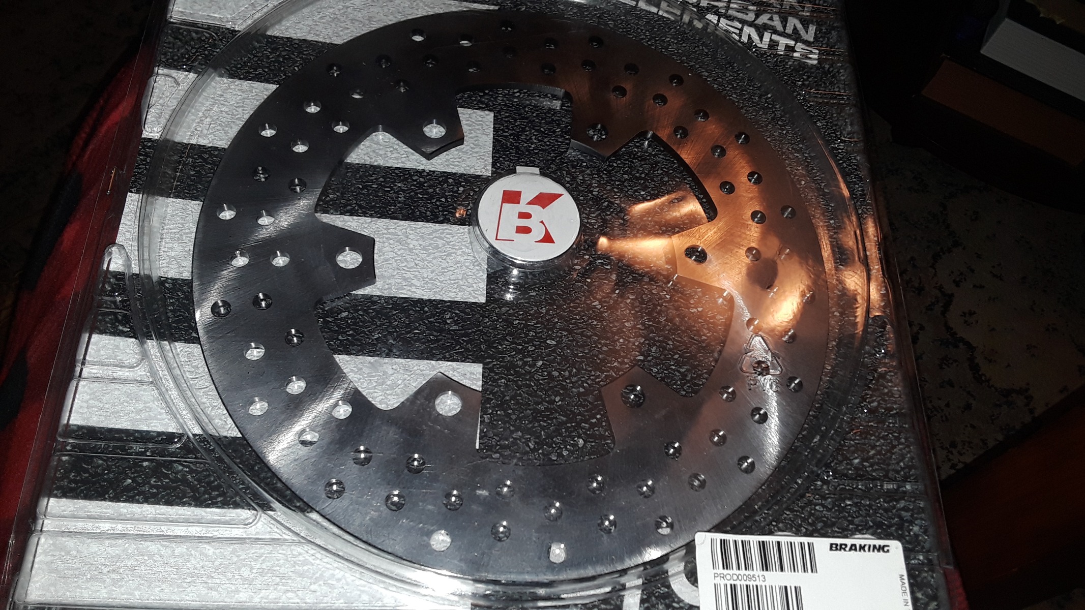

So evilbay came by with another part for the bike. All rotors sourced now
Not noticeable is the front speedo drive that was needed to drive a (future) mechanical speedo.
