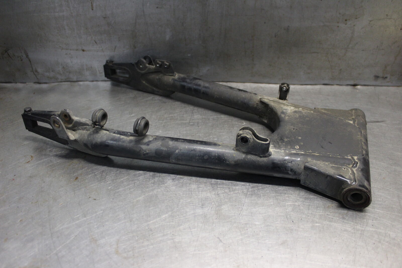

23 Oct 2020 08:15So the longer Suzuki axle arrived last night, it is too big to fit through the wheel! WTH. I thought this was simple bolt-on upgrade?
Whatever... the search continues. Pause to consider... Keep the OEM wheels & put the Suzuki axle in the lathe to trim off a half a millimeter? Or consider other/OEM/Non OEM wheels?? :blink: :dry:

That's one of the many reasons I went to a late KZP swing arm. Still had to fit it and extend the fender.

I'm surprised it didn't fit. About 10 years ago I mounted a GS swingarm on an 80 Kz1000 LTD. I don't remember all the details, but I know I didn't need to do anything special with the axle or bearings. I do recall making spacers for the pivot so it fit tight in the frame.
