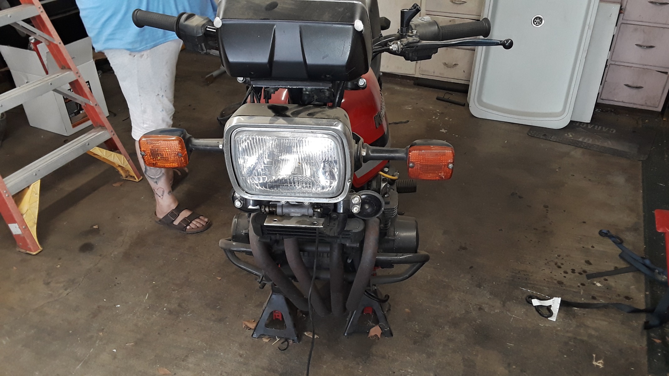

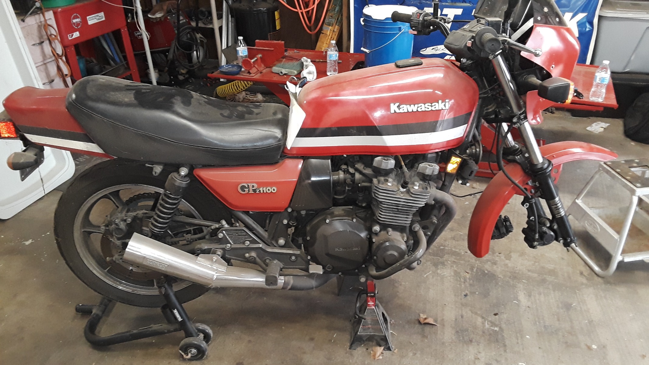

Fellas, I just wrapped up the upgrade on my Suzuki, well, almost... and so the lift was clear for the first time in a long time. My wife has always ridden & owned her own motorcycles & her big GPz is next up on the lift. Plans include a Suzuki aluminum GS1100 swingarm conversion, fresh brakes & maybe a fork swap as well... we'll see how it goes & what SHE wants!
Wow. Somehow doubled up on pictures... you'd think I had done this before :blush:
So the entire front end has been removed & the front brakes disassembled... What a mess. The fronts were horrible! Z1 to the rescue! pads & stainless lines in the basket.
As my credit card is still smoldering after upgrading the GS, This one will likely be spring before completion.
Be safe guys

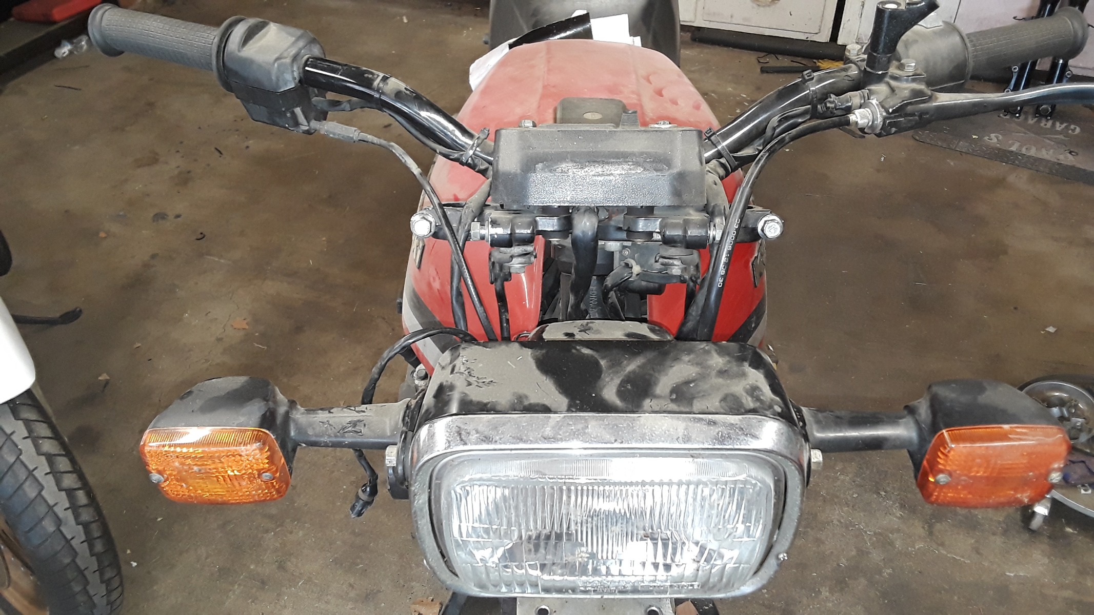

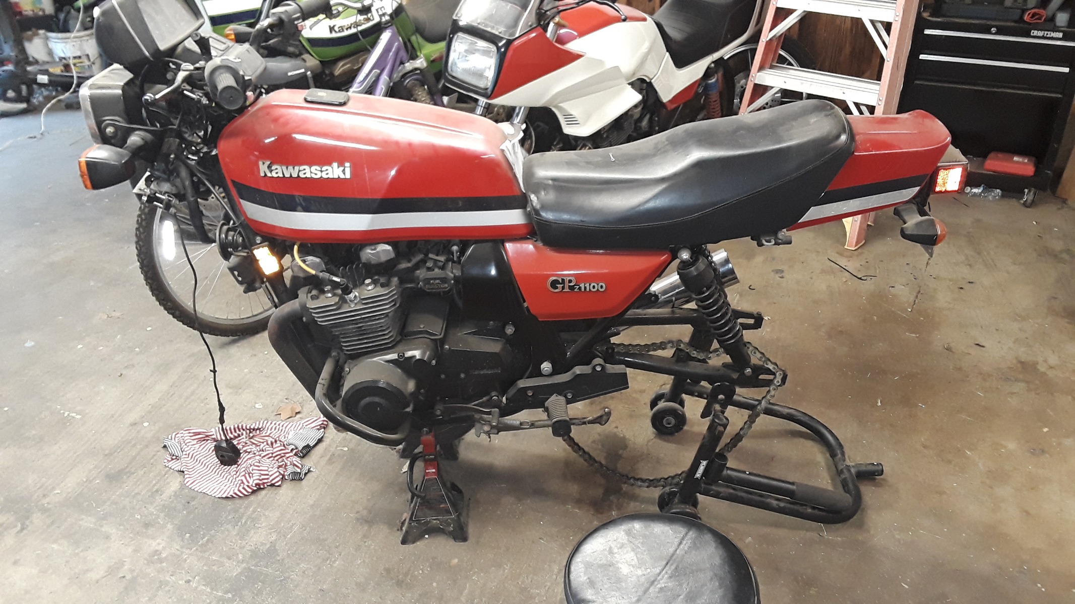

So, a (very) little progress on Sunday morning before the business of life took over.
Got the forks and front end removed (maybe just disassembled... dammit it's hard getting old). Old forks, removed caps & fork springs. Found them to be progressive & will be tossed or re-purposed into wrench holders in the tool box.
Also managed to get the hideous gauges removed from it. Good riddance to you.
Removed the rear wheel for first mock up with new swing arm
Turns out I'm gonna need the Suzuki axle for this as well as suitable spacers made up.

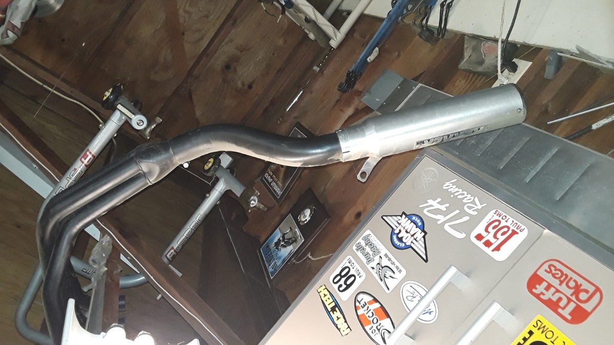

I was also reminded that I have this left-over Kerker from something..... I wonder.....
