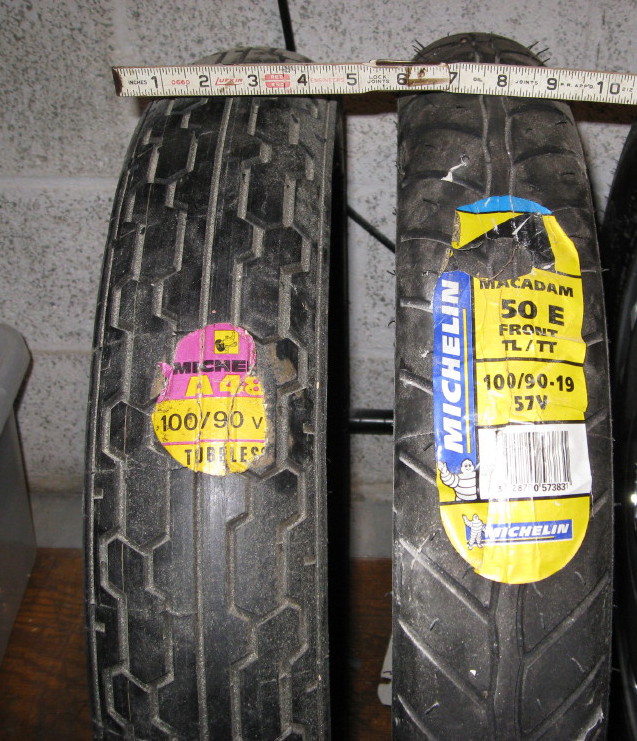

Getting the exact width of the tire from the manufacturer, or better yet measuring it yourself before purchase, is an excellent idea. Some tire manufacturers provide different width tires even though their tire sizes may be marked the same. I know that sounds odd, but below is a picture I took of two different model Michelin tires that were supposedly same size as marked but in reality were different widths. Ed

24 Jul 2020 08:13650ed wrote: Getting the exact width of the tire from the manufacturer
This is definitely critical. The numbers on the side of the tire are only roughly what you'll get. I always look up the full dimensions on the manufacturer site, and I will never buy a tire from a company that doesn't provide detailed dimensions.
For example, even within the Roadrider Mkii sizes, the 130/70 is 133 wide, but the 130/80 is 137. The 120/80 is 120 wide, but the 120/70 is 129.
I run a 120 on the rear of my Z1R, which just barely fits without rubbing on the chain guard. The difference between an actual width of 120 and 129 would very likely be enough to rub on my bike.

650ed - a folding wooden ruler?! I haven't seen one of those since my grandfather was around!

24 Jul 2020 11:41 - 24 Jul 2020 11:41Geez, maybe I'm getting old. Is there some other kind of newfangled ruler available nowdays? :laugh: EdSkidmark wrote: 650ed - a folding wooden ruler?! I haven't seen one of those since my grandfather was around!

24 Jul 2020 16:55650ed wrote:Geez, maybe I'm getting old. Is there some other kind of newfangled ruler available nowdays? :laugh: EdSkidmark wrote: 650ed - a folding wooden ruler?! I haven't seen one of those since my grandfather was around!
I caught that too! (Hee Hee!!) As a miner working underground a folding rule was an essential tool. I don't think I have any around but I know I have a folding degree rule with a level bubble. We used them when driving raises.
