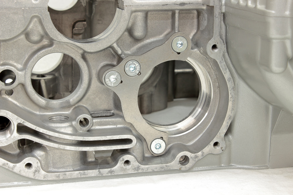

Later type of Kawasaki KZ650 crankcase (starting from C3 and B3 models) has a secondary shaft bearing’ stopper plate with three holes and the crankcase has three corresponding holes for that plate. Two of these points also serve for oil pump mounting and only one serves solely as plate mount point. Crankcase also has an additional hole that serves as the third mount point of the oil pump. In this way the total quantity of holes used to fit the secondary shaft bearing stopper and oil pump is four.

Kawasaki KZ650 of B1 and C1 models came with secondary shaft stoppers of different design. Total quantity of pump and stopper holes was similar to pre-serial crankcases (five), but the number of holes in the stopper plate were increased to four. Of these two holes served to secure the plate itself and two were used also for the oil pump mount. I could assume that along with this change of design also came a notion in the OEM service manual to stake stopper screws heads with punch to prevent them from loosening. Thus, the reason for such change is pretty obvious: the secure fitment of the oil pump. Even with one bolt loose it still was securely fixed by two staked screws (both of which go through long dowel pins).However, four holes in the stopper plate was overkill, since three points are enough to determine a plane (and fix it as well). Thus, no wonder that in later models (starting with C3 and B3) Kawasaki got rid of the fourth screw and its holes in both crankcase and stopper plate.At some point I noticed that crankcase I bought for project is of early type:
Sure, I could have used stopper plate of later type without issues:
