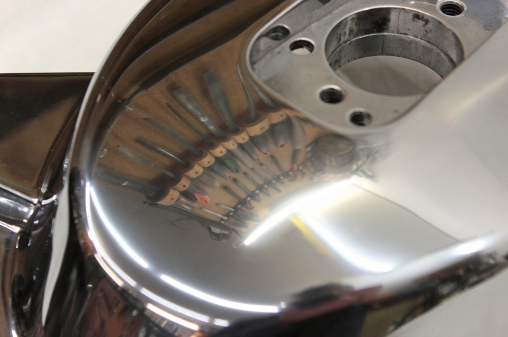

As I already have written I decided to polish KZ650 engine covers before engine assembling. So here we go with a sprocket cover. This cover is more than 40 years old and it wasn’t laying in the box on the shelf all this time. So, no wonder, it is all over scratched and oxidized. Here is how sprocket cover looked after being treated with pressured gasoline and by high pressure washer:

09 Feb 2021 13:17My task was to detect if the cover is not beyond salvation. Well, it turned out that work was within my skills:
Another couple of photos “before and after”:

However, it wasn’t an easy walk, a lot of sandpapering was involed. Here you may see how deep some of scratches were:
But patience did the trick and with some efforts applied sprocket cover started to look more decent.

After courses of dry and wet sandpapering I made the first polishing approach to reveal and eliminate flaws that could be eliminated. Then I made the final polishing.

Same story was with the cover of the clutch adjuster. Initially it looked battered, but fortunately, wasn’t beyond salvation too. Sandpapering and polishing made it look pretty different. Here are photos before and after the work I did on it:

katit: I couldn't say how long it took to finish the cover as it wasn't continuous work: to run the project and workshop I make some parts and do the work to order.
Here is a copy of my answer about polishing:
Polishing" is 90% surface preparation and only 10% polishing itself. The better you prepare surface - the better is result. Usually I do it in this way: firstly I remove cast defects, seams and so on where it’s possible. This work I do with help of sandpaper wrapped around rubber blocks, delta sanders (have two of them) and Dremel. Then I sandpaper dry with sandpaper up to 800 grit manually and with delta sanders and Dremel. After dry sending I do wet sending (up to 3000 grit).
Then it’s time for first polishing. I use various headpieces for Dremel for hard to reach places. For other cases I mostly use buffing cloth wheels installed on bench grinder. Once surface polished all defects (traces of sandpaper and so on) became visible. I remove those of them that could be removed and do second polishing.
Some aluminum parts need to be polished long and in all directions to became perfect, while for other parts long polishing makes no good, as it exhibits tiny defects (like pores). Of polishing compounds I use two: mostly liquid Doctor Wax Metal Polish and solid past (supposed to be Diamond polishing compound , dunno of what concentration, but it works just good ).
