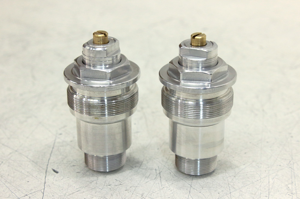

Here is the batch of parts for fork repacking: mostly new in mix with those original parts that needn’t be replaced.
I also refreshed look of upper plugs and slightly modified them. It seems that this very fork have never been disassembled before, but it turned out that lock nut of upper plug in one of fork legs had already stuck. Plug has very narrow ledge for 17mm wrench and when I tried to unscrew that stuck nut, the wrench slipped and slightly damaged ledge. So I grinded ledges on both plugs to fit 14mm wrench (which is common) and I also made ledges wider to avoid issue with wrench slipping in future.
There is nothing special in assembling this fork, except it's outer tubes are highly polished, and a fact that I had to fabricate two "special tools" instead one needed for none-adjustable fork.
To avoid any issues with polished aluminum I assembled fork with outer tubes wrapped in rugs, which in their turn were fixed to rubes with reusable plastic ties. it worked like a charm and further assembling went without problems.
Assembled fork looked great and now it definitely much less resembles front fork from sport bike...

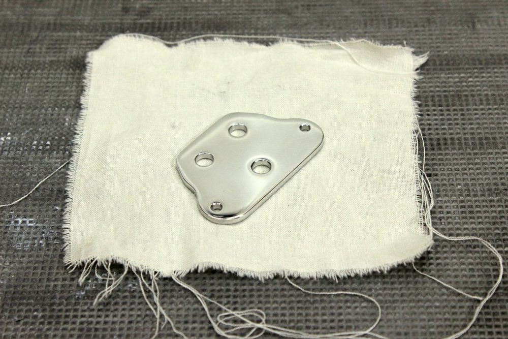

And here is a post about piece of non polished aluminum:)
I have tachometer and speedometer for dashboard, but they have no the following indicator lamps: for oil pressure, neutral, turn lights and high beam. Some of my constant readers might remember how I solved this question in Kawasaki Zephyr 750 cafe-roadster project: I installed custom made LED indicators right in holes for handlebar mount. And as a top yoke for our Kawasaki ZK650 cafe-racer came from Zephyr 750, it’d be obvious that I was thinking about similar usage of holes for handlebar mounting. However, cause I like to make thing better. this time it would be “extended edition”: I designed the plate that covers all unwished-for holes on top yoke and indicated the meaning of each lamp. I made electronic drawing of this plate and gave it together with aluminum plate to one friend of mine, who has homemade CNC milling machine right… in his apartment. Some engine and other motorcycle parts may be found there as well. This CNC milling machine of his is not something fancy and professional, but it definitely does the work for which it was designed.
Here is result of its work, just removed from under the milling cutter.
And here how it looked after I grinded edges and put some “brush” effect on it. Just to show the dimensions of part I put match next to it.
And here is plate for top yoke, ready to be installed. I filled all groves with black paint, then I “brushed” it with 600 grit sandpaper. After this plate was covered with two-component mat varnish. May be I should “brush” aluminum with 400 grit sandpaper to make the effect more explicit under the mat varnish, however this very plate looks great anyway.
And yep, back side is treat as good as front one, even if it wouldn’t be visible once plate is installed.
Some closer photos:
