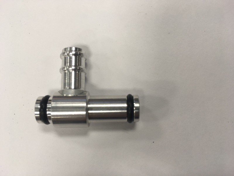

After doing some more searching I found a guy on Ebay selling copies in all aluminum. Measurements match, so for $20 I am going to give it a try. I will report back on the fitment after I get the part in hand.

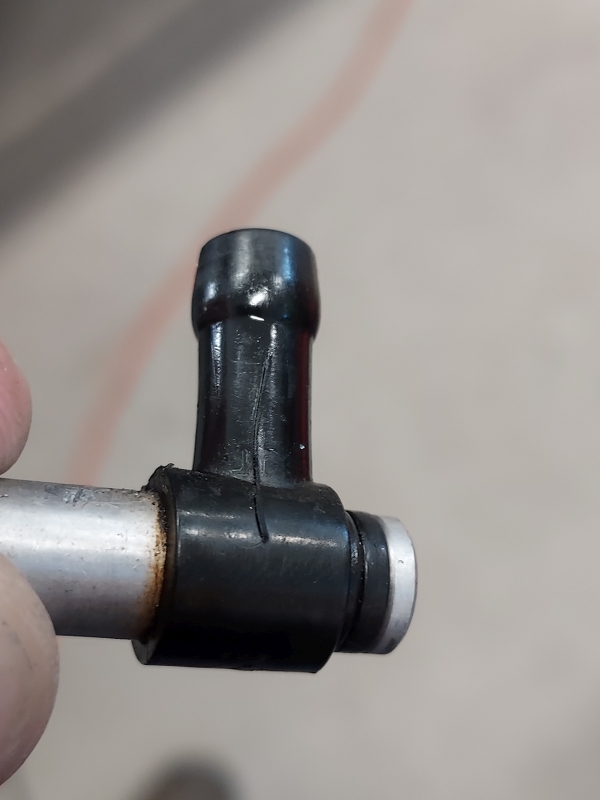

27 Oct 2022 17:17 - 27 Oct 2022 17:18Those O-rings are flat as a pancake. I suspect that's the source of the leakage. Are you sure the Tee is cracked? That mark looks more like a scratch in the photo. Regardless, though, that new Tee should fix things up.

Those were new Buna o-rings when I rebuilt the carbs, what, a year and a half ago? 6 miles on the clock so far. Working out the bugs as I go. Very close to an actual break in, though.

It not a crack,it´s a cut. Some one cut off the old fuel line and cut into the fuel-t rubber. Nessism is right, those O-rings needs to be replaced.

I leak tested the part by putting two neoprene plugs in the ends, put some dish soap on it, and blew compressed air into the fuel line end. Bubbles. Definitely leaks. I have to agree with Scirocco's assessment, though. It does look like a razorblade slice. That cut may have facilitated the crack by introducing a stress riser to the part. Either way it needs replacing. Thanks, guys.
