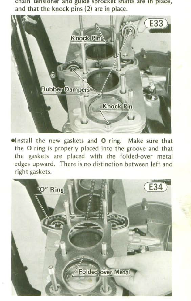

Just to be sure.
If I use a one piece gasket do I not have to fill the grooves where the oil ring used to be?
Eric
Eric

hello wiers
in my opinion one piece head gasket plus copper coat gasket.
in the o-ring area you can use an little thinner o-ring.
in my cold rolled steel company we use "endless o-rings" in different diameter.
these o-rings will cut to the needed length and glued together with super glue.
i would go this way.

it is common practice to fill the o-ring groove with silicone and let it set up then using a razor blade cut it level with the block surface.
then install the one piece gasket .
