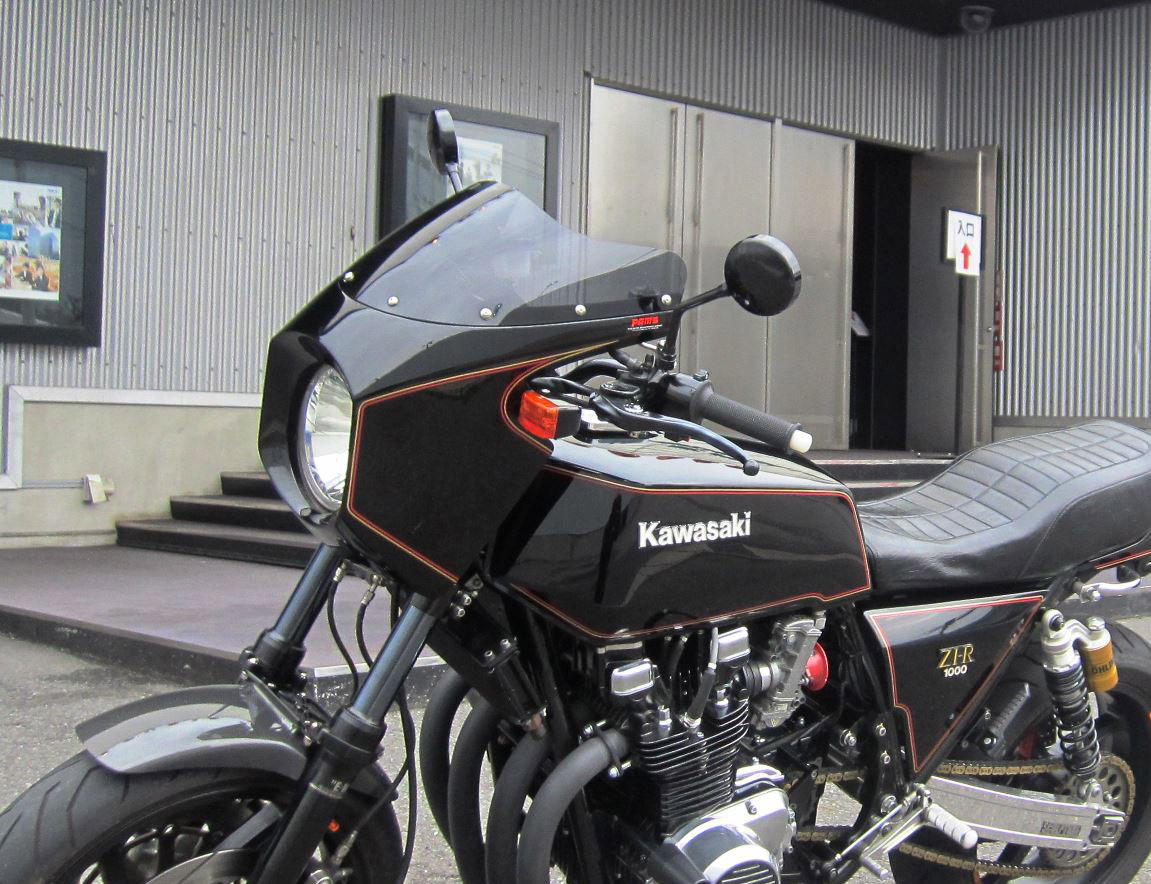

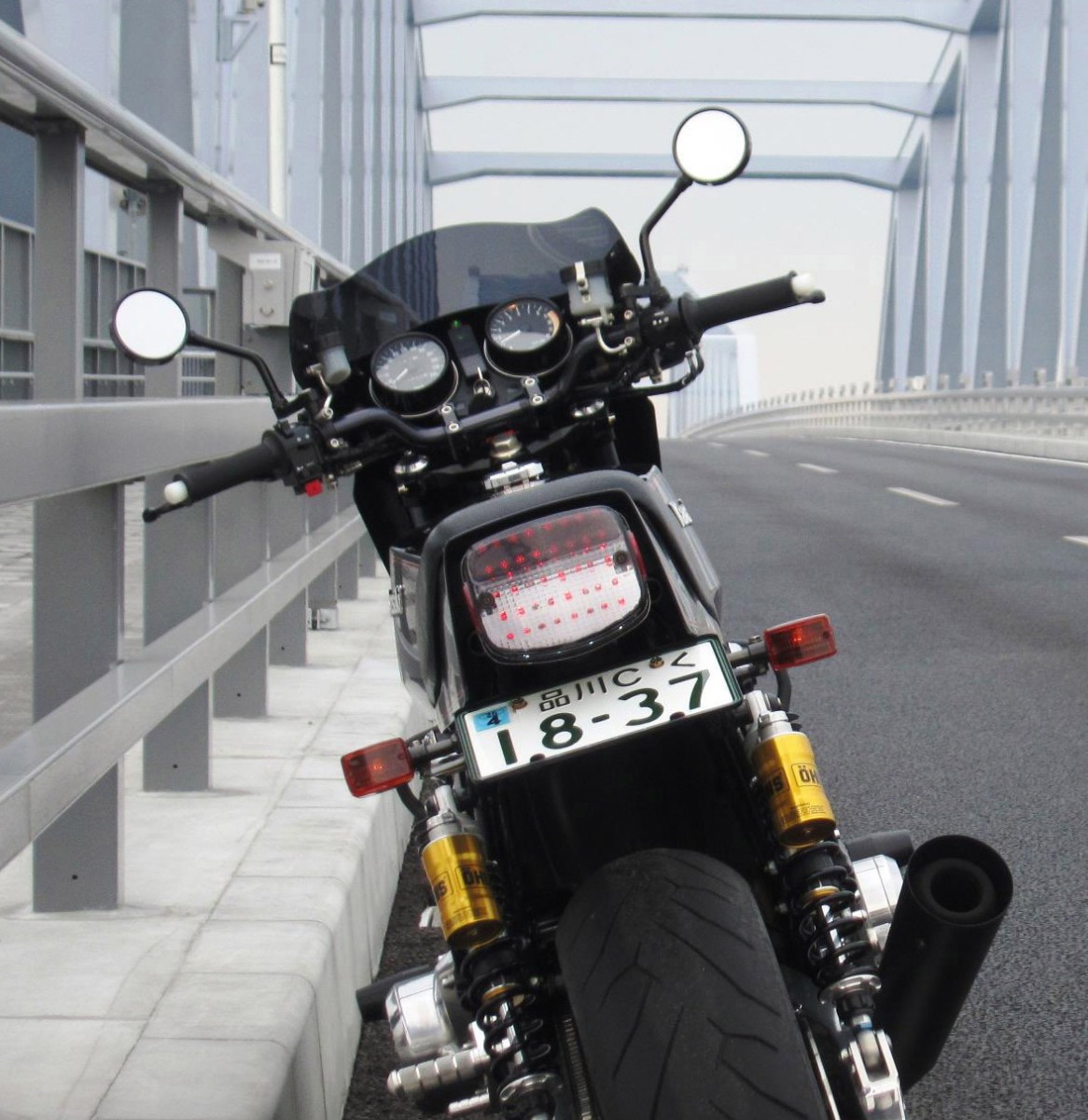

I agree, screen came out really great....here are some pics of my favorites.....but yours is way up there !!!
