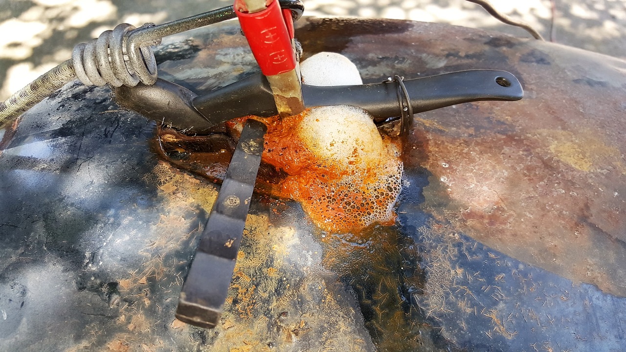

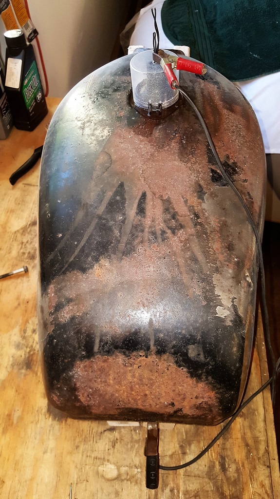

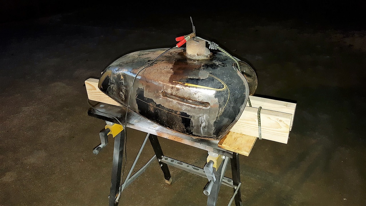

I started the week off with electrolysis investigation for rust removal from the fuel tank which as many may recall, I thought was metallic brown from memory but come to find out it was from so much rusting that my fading memory of 10 years ago made me remember it as brown. :laugh:
Anyway. Here's my first setup:
Yup. Just like all those EweToob videos show... Except there's a ton more work involved to get to this point not shown by all those young guns with gas tanks wired-up in their backyards and that is getting the electrode that goes inside the tank to be suspended perfectly so as not to touch the tank.
Easy! Right?
Um. No!

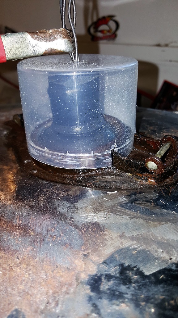

A royal freakin' pain in the wrist is what it is. Seriously! I spent probably close to an hour of diddling with this, trying that, reshaping the sacrificial anode (electrode, wire, whatever) to fit inside and then hang there isolated from the tank. Here's a close-up of my secret to success:
Yes. That's right boys and girls. I cut up a perfectly good throttle grip to make a rubber insulator that fit snugly inside the fuel filler neck and then ran the anode wire through it AND a plastic rattle can lid with some mods to fit over KZombie's tank neck.
Cool! Right?
Um. No!
DO NOT EVER TRY THIS METHOD AT HOME KIDS!
Do you see anything obviously wrong with this approach? I didn't. I was pretty damned pleased with myself when I finally got to hook up the battery charger and walk away, sweat pouring down my forehead and forearms from the extreme humidity we've been suffering through here in central Texas.
So this approach was a complete failure because I only thought about the electro-mechanical issues of suspending an electrode inside a cage that it couldn't touch and didn't put any thought toward the chemical reaction issues that are taking place...
About an hour later.
Me, all pleased with myself. Electrol-er-oh-sizing the heck outta my tank down in the garage. I was combing my hair after a cool shower and getting ready to take my pooch for her evening walk. Staring into the mirror, comb in hand, I hear "Thump..." from downstairs. "Stupid dog." I think to myself. - You know when your dog behaves like a well, I guess, dog. She musta lost her balance and thumped her foot or head or something.
So I continue combing, trying to make sense outta the mop on my head when I hear it again "Thump..... thump... thump...." :huh:
I step down the stairs and peek under the ceiling at my dog to see she is sleeping quietly in her doggy bed by the fireplace and then I hear it again as I'm watching the sleeping dog lie - "Thump" :blink: WTF?
So, I go out to the garage, following the sound that is getting louder.
There across the garage, on my workbench is my tank, rusty colored, saline solution bubbling all over the dang place, running down the tank and across the workbench, down onto the floor! :ohmy:
Yeah, that happened. Stupid is, as stupid does. :blush:
I quickly ran to the battery charger's plug and pulled it from the wall outlet. Whew!
In case any of you, like me, sat in the very back row of chemistry classes, paying more attention to the cute blonde girl outside of the window instead of the chalkboard where the teacher was explaining the finer details of what happens when you pass electrical current through a solution comprised of water which ultimately separates the H2 from the Oh and releases all that hydrogen from it's oxygen...
Yes. I was trying to, without thinking about it, make a hydrogen gas trap between my insulator-throttle-grip and the rattle can lid. Hydrogen. Hmmm. Isn't like hydrogen ... EXPLOSIVE?
Quick! Open the garage door and grab the pooch and head out the front door for the evening doggy walk before the wife gets home and notices anything odd! :whistle:

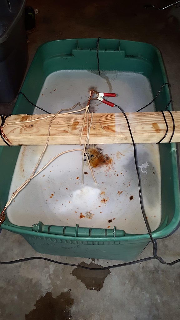

Take two:

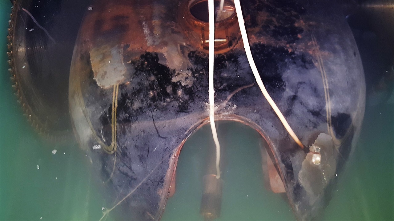

So, more freakin' diddling hours later. I managed to get that sacrificial anode wire suspended inside the tank without the throttle grip-seal-gas-trap. Breathing a sigh of relief, I let'er rip for about 3 hours while nervously watching the television with darling wife. About 11pm I stepped outside and hadda a peak. The sodium carbonate solution still managed to bubble all over the place but the process was working:
That's a video capture of the tank's internals.
It was working! Yay for electrons doing what electrons like to do! :woohoo:
Only problem is, the reaction was limited to the area immediately around my hand-fashioned electrode, which was simply some bailing wire twisted up and bent into a single length that reached from filler neck backward to about 3" short of the back/inside of the tank.
The results were kinda' disappointing considering all the hoops I hadda jump through to get to that point. All the time spent figuring out how to hand a wire inside the tank without touching the tank and the running around town to find "sodium carbonate" (NOT sodium bicarbonate! - which it turns out was discussed in another chemistry class I musta' slept through).
So the concept works but my implementation was underwhelming at best.
Take three:
So another day. Another attempt... This time I made a crazy, freakin' difficult to imagine, multi-pronged, electrode that required fitting and fitting and testing and trials. Basically, a four pronged probe with ends that reached out to all corners of the tank, counter balancing each other so as not to touch that tank internally for fear of shorting out - "ZZZZZZZzzzzzzttttttT!" and possibly frying my ancient, dumb battery charger.
I twisted-up lengths of bailing wire again and finally twisted the four probes into one neat but ugly knot at the filler neck where I connected the charger's positive lead to.
And it worked!
Worked great even! :woohoo:
I left it to run for almost a whole day out in the driveway as I wrenched on KZombie in the garage. Randomly checking on it to see the meter of the charger was acting normal and not showing signs of dead.
It ran this way from 9am until 9pm and when I finally shut it down and went to extract my hydra-headed anode, all I pulled out of the tank was rusted bits of wire, no longer than a couple of inches. The anode had essentially disintegrated into nothing. The bailing wire it seems was just not sufficient for that many hours of chemical reaction. I probably could have stopped it around 4pm in the afternoon given what I removed from the tank at 9pm. :dry:

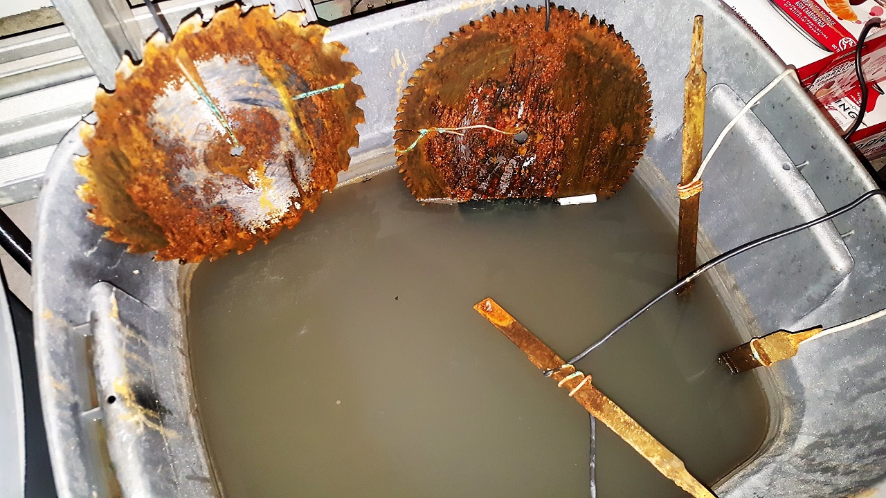

Take four:
Oh yeah! That's what I'm talking 'bout!
Look at that!
Doktor Von Frankenstein would be proud!
I decided to forego the problems with suspending electrode of flimsy wire inside the tank and just submerge the whole dang thang! :evil:
I soldered the cathod connections directly to the bare steel of the tank.
I created a maze of heavy iron and steel anodes that surrounded the tank, inside, underside, side, overside.
These anodes were going bombard the crap outta of the tank from every angle and with two cathode connections soldered to the tank at both ends. Well, A freakin' superhighway of electron flow was about to commence!
An hour or so later
I actually made a video of this in process and you can see the bubbling, watery, electronee, action in all it's goodness. When I plugged in the dumb charger, instantly a cloud formed between the two big 10" saw blades and the sides of the tank! Awesome! :woohoo:
The worn-out, old, files I used also started their efforts and bubbles started forming throughout the solution.
Turns out the bubbles were mostly because I used "Arm and Hammer, Washing Soda" instead of straight-up sodium carbonate. So I got some sudsy washing bubbles but as the wife pointed out later - "this is the best your ratty old bike has ever smelled!" :laugh:
A few hours later:
Super! More bubbles! More rusty goo! Awesome!
In short (no pun intended) this setup worked so dang good. I was impressed. So where's the results picture?
Yeah. About that...
More chemistry class we all shoulda' been paying attention in.
Sodium...
Sodium (anything - carbonate (good) - bicarbonate (not good)) and raw metal. Well, anyone that lives in the north east knows what happens when salt meets with your automotive pursuits - Rust!
Wha?
But isn't that exactly what this whole experiment was supposed to remove?
Yup.

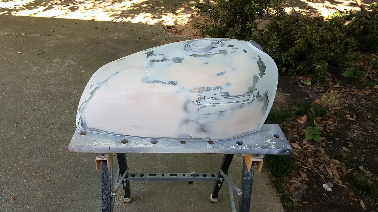

Problem is, the second, that raw, clean, metal tank hits the air outta the solution, it begins flash rusting all over again. :ohmy:
Additionally, my tank was still sorta' painted when I dunked it into the electrocution tub from hell.
When I pulled it out several hours later (8 hours total time BTW) all the paint still on the tank had begun to bubble-up. You see, even the teeny rusty pimples under the paint and primer were no match for my pyscho electron bath. However, all the paint lifted off too. I used a flat razor and simply scraped across the whole of the tank and big flakes of paint fell off like they wanted to get away from that tank.
The rusting began instantly too. I hadda wash-off the sodium solution and fill the tank with water from the garden hose just to rinse it all out from inside and in less than 30 minutes my tank looked almost as bad as when I put it into the Frankenstein tank:
Janet! Dr. Scott! Janet! Brad! Rocky! Uh! :laugh: :laugh: When Eddy said he didn't like his Teddy, you knew he was a no good kid.. :laugh: :laugh:

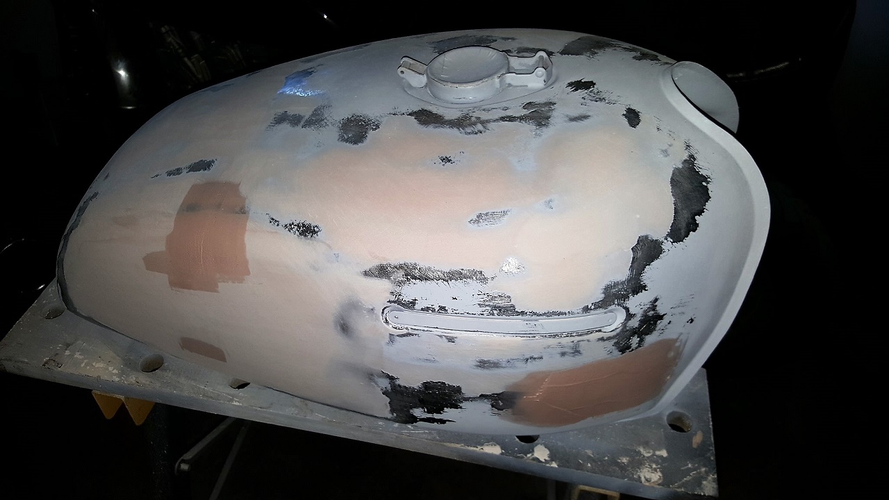

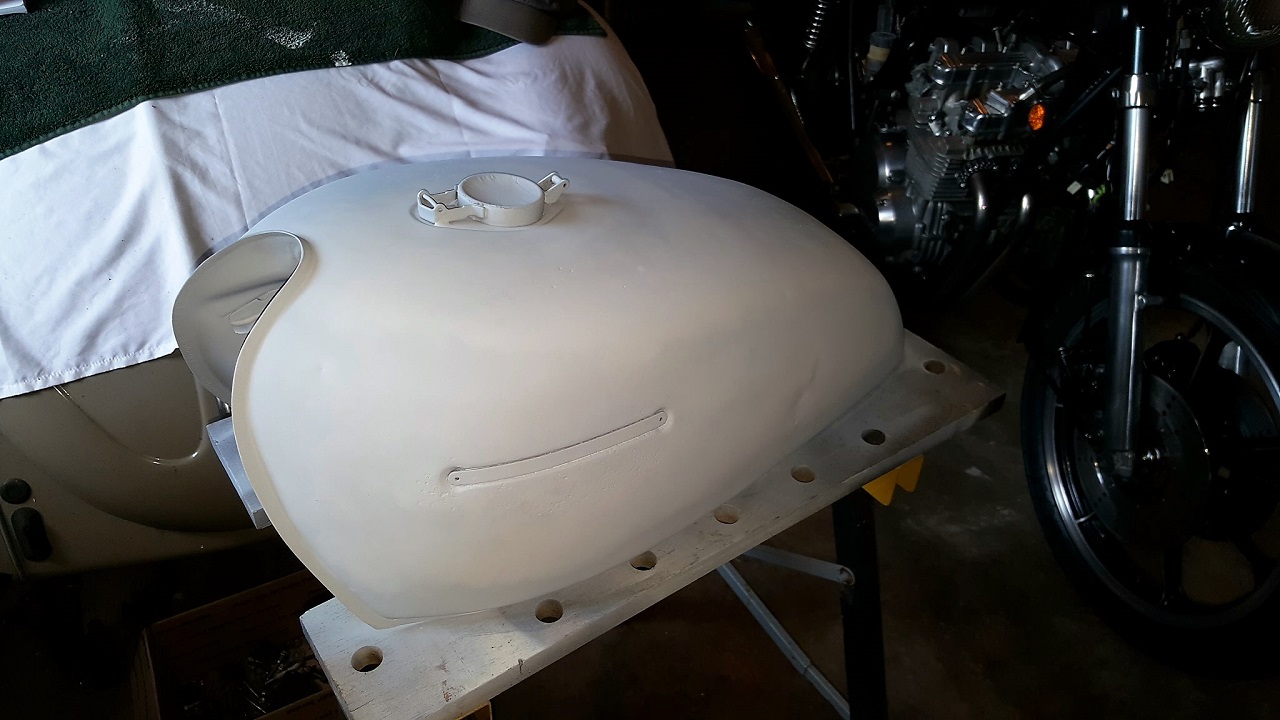

So. I ultimately had to hit the whole tank with a wire wheel on a drill and zap all the flashing rust from the surfaces. This worked out to be a good thing anyway because all the heavily pock-marked skin held rust in the deeper crevices and that hadda go!
Within an hour, I had sanded, wire-wheeled and primed with etching primer the whole tank:
I dunno if you can see it at this resolution but look closely at the tank skin near the Kawasaki badge mount and you can see the pock marks left from rust removal ala Frankenfurter :silly:
Here's the tank afterward:
Pretty! NOT! Those rusty saw blades are THICK in rust too. The oxide layered up upon itself to nearly 3/8" thick. Crazy!
So that's electrolysis ladies and gentlemen!
I think it's cool. Certainly fun experiment. Probably really useful for cleaning up old tools, hammers or whatever. Smaller objects that are easy to tank-dunk.
I think it's completely a waste of time for motorcycle tank cleaning. Waaaay too many hours sunk into this now and ultimately, I had to resort to mechanical rust removal - flap discs and wire wheels, just to counter the flash rusting from sodium exposure. Guess what the inside of the tank looks like now?
I dunno. I was too afraid to look. I rinsed it out and let the tank dry off. Then masked it up and started flap disc'in and wire wheel'in so I could get it into etching primer coat quickly. I thought about spraying oil inside the tank but that's counter productive to priming, painting or even body working.
Thus, I will ultimately have to fill the tank with some metal etch cleaner and probably sealer anyway.
Easy! Right?
Um. No!
Cool! Right?
Um. No!

Take four:
Look at that!

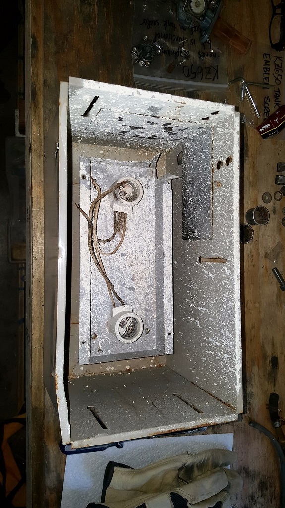

An hour or so later
A few hours later:
Yeah. About that...
Sodium...
Wha?
Yup.
Fun!

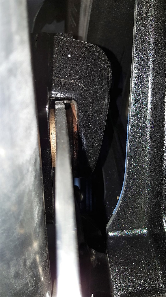

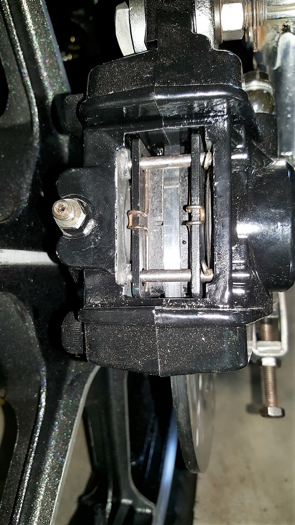

I had a few hours on my hands last week between risky, unworthy moments of near electrocution and a recent shopping list of parts had begun to pile up so while the tank was be blasted with electrons I set to putting more of KZombie together. I found a good deal on complete stainless steel, brake line kit on eBay and was pleased with the results:
These brake lines were optionally colored with various options for the banjo fittings and the lines so I got real creative and chose black and black. The kit was complete with all washers and new bolts and I was able to install all four lines in about 30 minutes. It felt like it should have gone faster but I found the banjo fittings were pressed on being ... parallel to the opposite end and this presented a little more challenge when installing the line from front Master Cylinder because the stainless line wouldn't twist much. I did finally get it though.

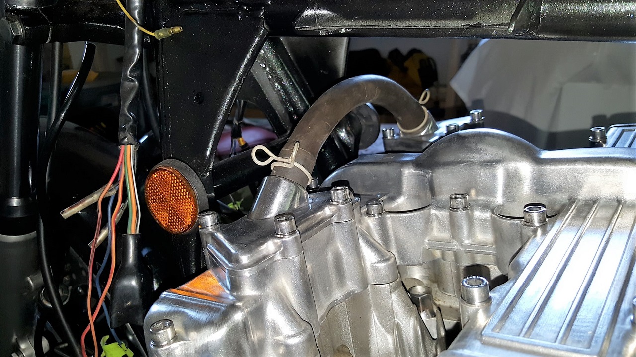

Incredibly, KZombie still has the entire emissions setup but since I wasn't putting it back on, I chose to take a short segment of the original air hose/plenum and install it between the two reed valves and secure it with the stock original clips:
Yeah. That sure as hell ain't pretty but it is an original part so I'm happy with it!

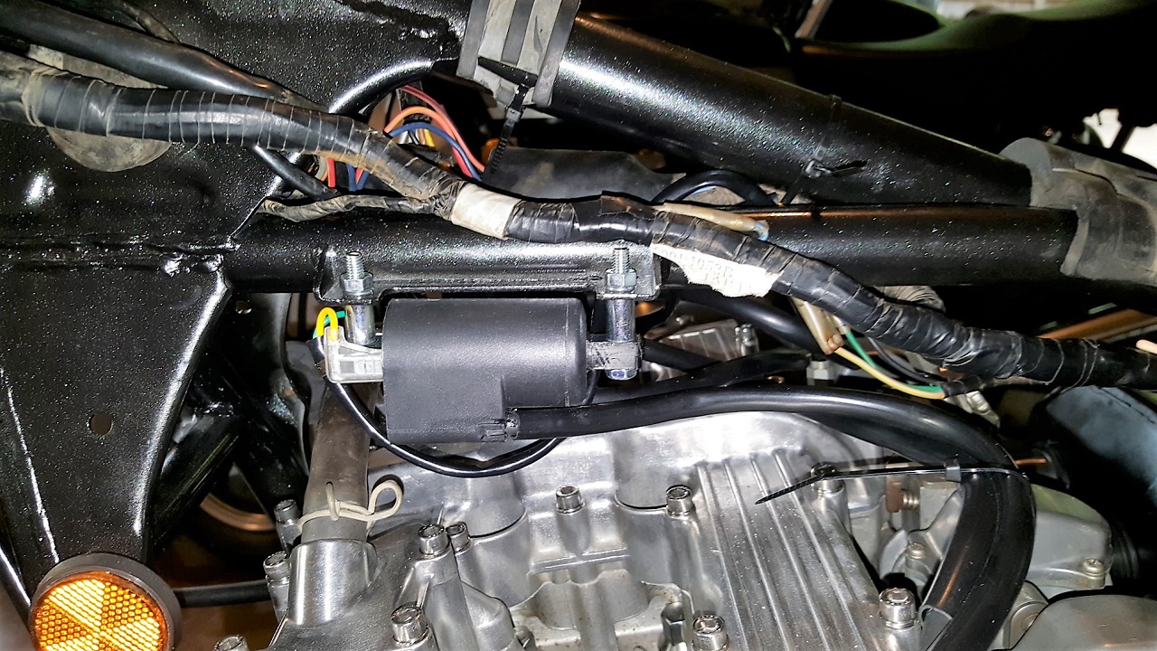

So it was on to another newly arrived part. The ignition coils:
Pretty straight forward I guess. Thankfully, the colored primary leads are hard to screw-up and other than leaving the HT leads at full length for the time being, it's done.
All that was left was to install the battery and test out my handy super-sleuth work. Of course that went sideways because my battery while new, was not charged and my battery charger was committed to electron bombardment duty with my tank :dry:

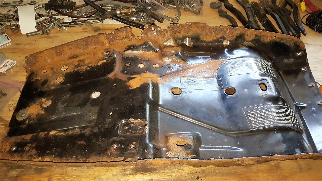

Onto one of the last things in my shortening list of tasks - the seat. You can see in the first pictures of this thread what the original seat looked like... yeah, pretty much a horror show. I broke out the razor knife and had at it. Spared nothing it gutting the seat back to it's pan for which I had already ordered a new seat "kit" with foam and cover. It's not a stock looking seat and I reckon most of you will say "WTF are you thinking?" when you ultimately see my seat finished but it had a few things going for it which I find attractive:
(1) - I could afford this option.
(2) - It provides a slightly lower seating position than stock
(3) - I SUCK at online shopping (or did I already mention this?)
Number 3 is the main reason I chose the seat kit I did because I found a near perfect, original KZ650 seat on eBay and I really wanted it but it was an auction and not a [Buy it now] sale. Of course when the time came for the auction to end, I was at work, up to my elbows in another restoration and totally forgot. It didn't matter anyway because the auction went way up over my budget.

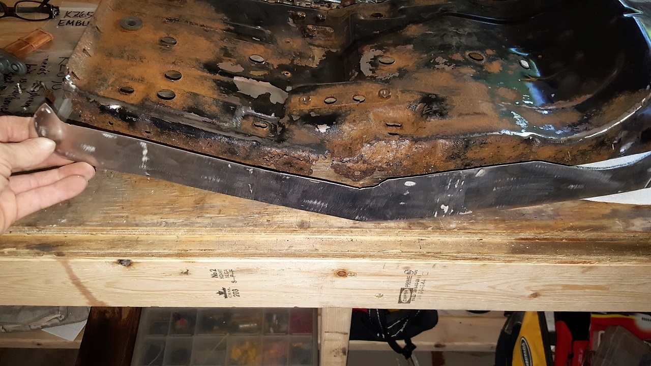

So back to my original pain, I mean, pan. No I mean pain:
Ain't that a beaut? Ah heck, it's only going to need a little buffing and should be good to go; no?
Back to the drawing board. I already have the seat kit on it's way and it's made to fit the stock pan. I checked my pan options online and they're pretty much non existent. Closest was an eBay seat which looked good but reading the fine print said "pan is damaged beyond use as the seat was ripped off the bike frame". Doh!
Thus, the seat is going to, for lack of a better term, take a back seat for now. I'll cut up some steel and fabricate the side sections which are so important to a seat recover because they contain all the cleats or points which secure the new cover. KZombie's scheduled rise from the dead just has to slide back a bit.
The weather here has been up and down like a toilet seat of late. Some days are awesome and perfect for painting while other days I don't even want to step foot in the garage due to the heat index or humidity but I have plugged a few minutes daily into the tank and skins in prepping for paint. These will all someday be metallic blue (the darker, stock-esque, color blue). The tank by this point was outta the electron bath and I commenced to body working it. The tank had been "pinched" - usually the result when a rider says something to the effect "What this!" and shortly after, things don't go as planned and they're body constricts like a boa around a field mouse. KZombie was no exception. I have a dent puller in my shop which I used on the tank 10 years ago and got most of the minor/easy dents out but one of the two pinches (right side) was reluctant to pull out. The weld-on anchors would simply rip off. Yet the dent was still too deep for just slapping body filler on it so I developed a method which I used on cars before. It's akin to leading (as in lead sled body working) but I use my MIG welder. Drawing short lines of weld along the deepest area of the dent on KZombie's tank to essentially fill the dent with steel instead of bondo. Of course this tank had the added need to fill in all the pimple sized pock marks all over from the rust pitting too. I have to say of all the phases of automotive restoration, the one I groan the most about is body working. Sanding. Ugh! :pinch: Still, it's a necessary evil:
The tank is about 95% ready in this pic. I missed a small pock mark up front there and the back is a subtle flat spot. It's always been my method to smear the panel from front to back with bondo and then sand back, what doesn't belong. I have found that approach most successful personally, versus spot puttying here and there and here and there. Unless you are a genius at mixing body filler consistently then spot puttying is difficult because some spots will be harder than others and when you block sand it, the harder areas wear down slower and ultimately (again, in my experience only) I end up with a wavy panel. So just smear the whole dang side and then sand off all that isn't needed. You can see the bondo is less than the thickness of a credit car in most places.

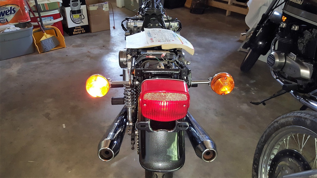

Well, the tank being finally into body working phase meant my battery charger was liberated from evil duty and I filled KZombie's battery with acid and got it charged and installed into the bike. Yay! So close. So close!
Ba da bing. Ba da Boom!

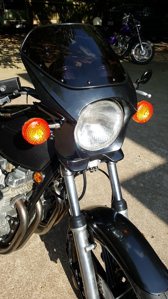

Lights and action!
I had to replace the old flasher relays of course and new bulbs and a slight custom change to the front turn signals which are currently only signals and not running lights too. This will change later as I have the bulb holders that support both running and turn but the holders were not present when I found KZombie and so it's been a collecting of absent bits thing. The front turn signal housings are made for a late model (I think it said 90's era) Kawasaki so they look the same but must be for a European market.
The only things KZombie hasn't done electrically yet is:
- beep it's horn (don't have one of those yet)

First the details and pics of the past week's efforts on KZombie which carried on with the tank's body work. I think I've mentioned previously my absolute love for block sanding haven't I?
No? Well, I lied. I hate it. I hate it even more when it's near triple digits outside which is where I have to do all the block sanding. Still I persisted and finally got to what looked acceptable and ready for priming and paint:
That picture there represents about five evenings of body working and block sanding on that tank. Geez, I hope it's worth it all in the end! By late week I was able to get the tank into primer and ready for color:
So now, the tank had caught up with all the other panels - sides and duck tail and lucky me, a new seat kit and something special I ordered with it showed up on my front steps and you'll get to see some of this a bit later, however, I had stripped the old seat down early in the week to discover it had a lot of rust termites and new I was going to have to resolve the pan. While at work on Friday, I happened to notice this 1950's era double bulb, ceiling heat lamp assembly that was tossed in the trash. I picked up the fixture and realized it was made of some stout metal about the same thickness as my seat pan so I chunked it in the back of the truck for later consideration. I got home that evening and immediately set it on my bench:
Definitely not pretty but that's okay, it only needs to be strong and I cut it up with my angle grinder removing all the tabs and flattening it out into sheet stock, then slid my seat pan on edge along it and traced the good side of the pan onto it:
Good fit!
It took me about 30 minutes to cut out the shape I traced and transfer it to the rusted-out side of the seat pan:
You can see how rusted-out the pan is along the mid-lower section but the reality is the entire side was weakened and needed work which is why the patch panel I cut from the old ceiling lamp is so long. Well, I didn't have my MIG welder setup yet so that was it for the night.
Saturday morning I rushed into the garage to prepare for painting the panels and tank and a little something else that needed some quick, minor attention. The idea was to get the painting all done before noon when the heat would be too much. And so it went. Smoothly even! By noon I had all the panels painted and clear coated. Here's some pics of the first stage before clear was applied:
Ooooh! What's this? This ain't stock?
I've always liked the look of the speedy, smaller fairings and saw this one when I was buying my seat kit online and took the chance on it mainly because it looked different from most yet still small and worked with the stock 7" headlamp.
In the bottom right you can see the two side covers and through the headlamp hole is a tall box that contains my new seat kit
Here's the tank. Not bad. It came out pretty straight if I do say so myself. But what's up with that blue metallic? Yeah, about that. When I test fit the new fairing the evening before, I had a change of heart on the color. The metallic blue is beautiful and pretty close to the stock color KZombie was born with but adding the fairing worried me it might be too much. I checked my paint supply and I had 2 cans of the metallic blue and 3 cans of the black pearl metallic. Hmmm? Do I chance it?
Nah!
I shot everything in the black pearl metallic because I knew I would have enough vs the blue which I just might not. In the end, I used every ounce of the black paint so it was a good decision or I wouldn't have been able to complete all the painting. I guess, I'll save the metallic blue for the 1000 CSR project.

The new fairing worked out great although I must say it is a tough installation that required extra hands ala my darling better half to hold things while I fished wires from the front turn signals through it, the fork ears, the headlamp bucket etc..
Yeah, yeah.Shut up and show us the pics already.
The new fairing installed and functional (although I need to fab a small bracket for the bottom):
Nah!
