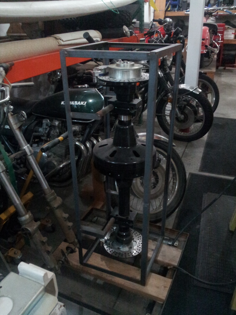

Yes I have a 76 900 frame and engine I'll be using. (Not the one in the picture). I don't have any thing to go by. I suppose I'll start by welding the swing arm to some sort of carrier that bolts to the transaxle. I'll need to add some bracing and move the shocks outboard to minimize the twisting forces.
The Transaxle:
Close up of the hub:
I'm looking for a pair of wheels and tires that pretty much match the diameter of the stock KZ rear wheel and are as light as possible.

Bill that looks to be an old HD servicar axle used in the police trikes from the late 40's early 50's.
with a disk brake swap.
For the rear susp. maybe a control arm setup like used on the 60's early 70's chevy truck's
would be worth looking at. Two arms with the correct bend use the axle blocks that are on it now
with heim joints at the swing arm pivot bolt.

just my .02 but i would build a custom swing arm with the tubes stacked to match the through holes in the mounting blocks of the rear end you have.those blacks clamp to the stacked tube of the arm.
it could also be done to a modified stock arm.
exhibit a-
exhibit b-
hth,
exhibit a-
exhibit b-
hth,
