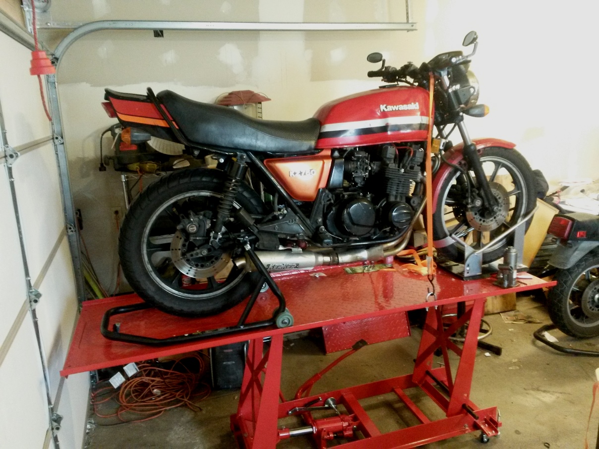

04 Apr 2016 07:12 - 04 Apr 2016 07:27Bowman wrote: Truly the stock side covers on the 750Bs are a crime against design IMO.
+1
I'm "retroizing" my GPz with E side panels a direct fit. I'm going to modify them slightly by the time I'm done to get a look more like yours.
Is there a write up on your keyless system?

Not sure what you mean by write up. I got mine from Spiegler.
spieglerusa.com/gauges-instruments/elect...d-ignition-lock.html
It comes with a manual that's not great but it does the job. Odd, because it comes from Germany and it's not cheap.I found this YouTube that does a pretty good job of explaining how it works and how to install it.
HTH

those 750G/LTD covers look great on there. i never did like the 750B covers myself. did they fit in the B side-cover holes?
Last edit: 05 Apr 2016 13:33 by DoctoRot.
The following user(s) said Thank You: Bowman
- Bowman
- Posts: 284
- Thanks: 36
Re: 76 KZ750 B1 Twin
05 Apr 2016 14:12DoctoRot wrote: those 750G/LTD covers look great on there. i never did like the 750B covers myself. did they fit in the B side-cover holes?
The G side covers snap right on. They only have 3 prongs so you can nip the bottom front tab off the B frame if you wish.

It lives!
Fired right up on the second attempt on the starter button after sitting in the garage for 18 years. Amazing.
It will only idle at half-choke so far. Time to drive myself crazy dealing with tuning it especially with the dreaded pods. Good thing I'm only 61, good chance I'll be able to ride it before I die.
