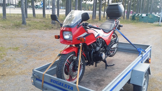

I made a 200 klick pilgrimage trip to the city of Sandviken today.
Sandviken is the home town of the Swedish company Sandvik, makers of Sanvik Coromant. Probably known to a lot of you, and for those of you that hasn’t set foot in at metalwork, Sandvik is renowned for being ”tha shit” in metalworking cutting technologies.
Once there I found this neglected little thing, almost original Gpz750A1 -83.
80.000 km on the meter, all parts intact (except exhaust) all the know problem, sweating oil around the cylinder head gasket, small crack in one side panel and the main fairing, running foul when cold. Just what you expect of a bike 30 years old.
Who was I to look away from this poor thing that has been sitting on the Swedish equivalent of Craigslist since 16 Aug? :kiss:
In need of carburetor love and probably new valve seals, something that can be taken care of when changing the head gasket. Best of all, it doesn’t have to happened this winter, so if I don’t finish my 82 R1 by spring, I have a backup.
I paid 800 USD for here custody, which was probably 100 USD too much, but what a heck.
So those of you, who drove these bikes when they were new, probably get it when I say I am working on my New Gold Dream

All loaded up and on the way to her home.
Wonder what will become of her when she grows up? a WRR? :laugh:
