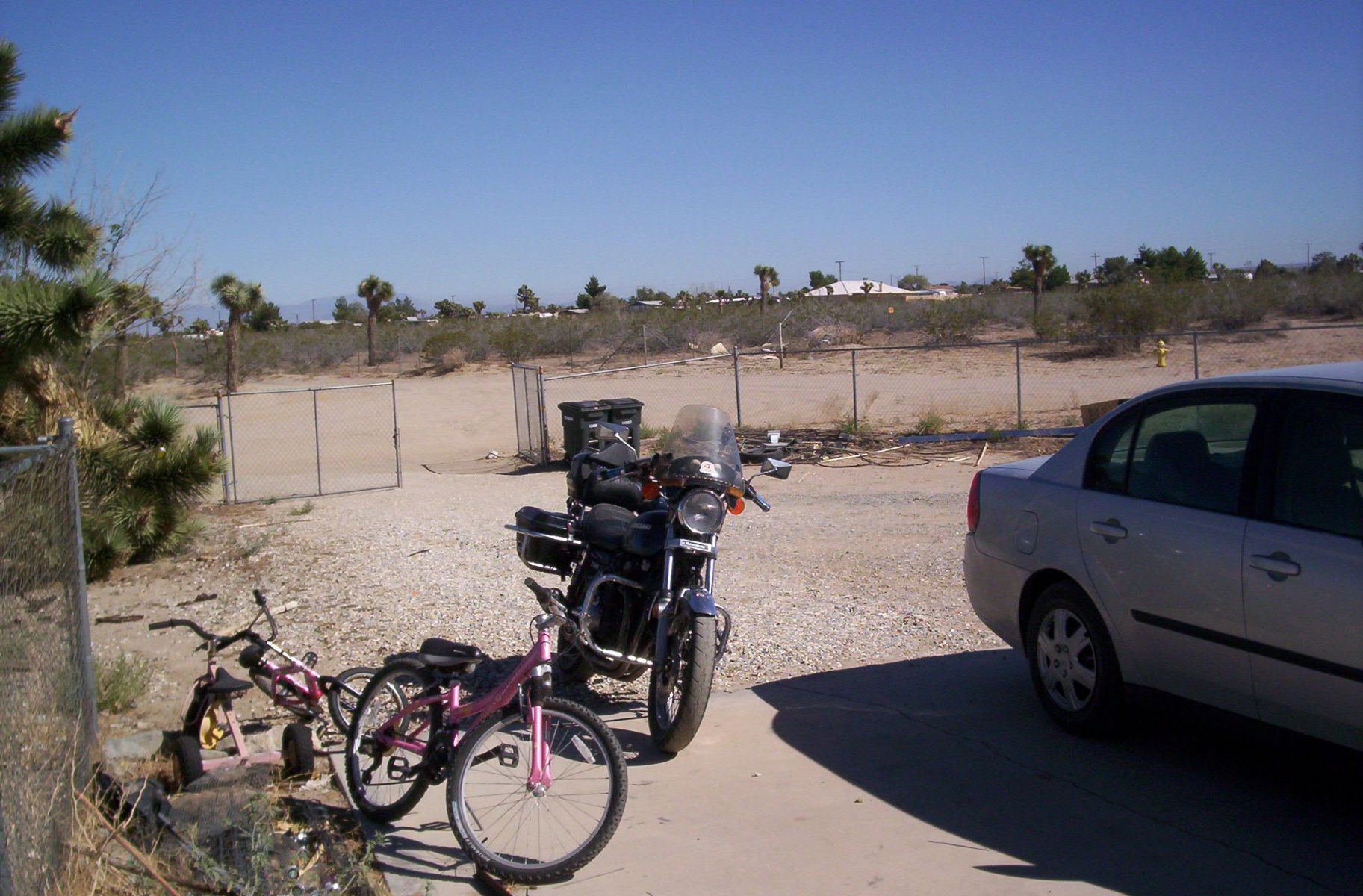

A few more pics of the bike on the day I picked it up much to the chagrin of my dear wife. I thought it was beautiful (being my very first motorcycle) and something I could work with. She said it was a piece of junk - she was right. But not only was I looking for a bike to ride, something I could learn on, I was also looking for a project, a hobby.
It was cosmetically challenged, missing seat cover, a side cover and lots of other stuff but It ran... mostly. It was in much need of cleaning, which is why it earned its name Grimey. I think I spent two days cleaning build up oil and grease from everything. And I would soon learn that it needed a lot of maintenance stuff done too. Tires were old, carbs needed a lot of work, front brakes were sticking, threads on front axle were stripped (nut was just hanging on), most of the cables needed replaced, both clutch and brake levers needed replaced, coil was iffy, fuses looked like the originals that came with the bike. The only wear items that were in good shape and that I still haven't touched were the chain and sprockets.
After cleaning it up one of the first things I did was cover the seat. I found a long girl's black leather jacket, made of some nice thick leather with a lot of character, at the local Goodwill. I used that to cover the seat. I found that someone had already tried trimming down the stock foam a bit but did a poor job, it was pretty lumpy in places.
I also discovered the original owner's manual and warranty book in the comparment under the seat. Bonus!
