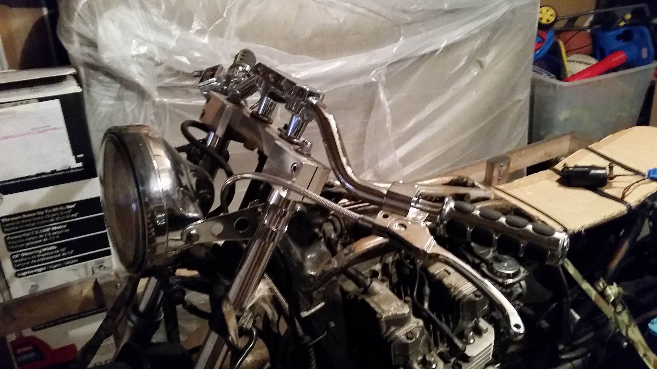

The bike when I first picked her up ... has aftermarket Harley spec top clamp and handlebar/controls with Dakota Digital Cluster, shorter/adjustable rear shocks, extra 4-1 exhaust, stock KZ LTD tank, factory fenders/side panels and a totally frankenstein'd wiring harness that has everything stripped out but the front/rear lights and essential wires to run. (in box). The running boards had been cut off, as well as everything behind rider seat and any and all brackets for coils/etc.

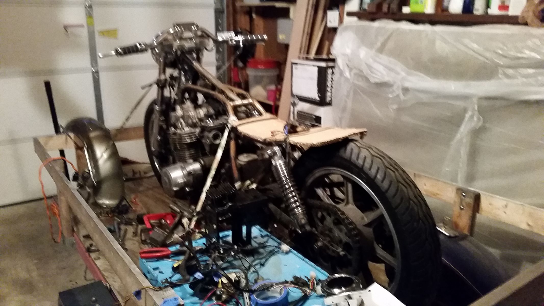

Used the trailer as a work bench for now until I can get some space made in the garage... This allows me to move it if I want and also it's at a workable height. Had to buy a new automotive Ignition switch 'cos the key wasn't there. Also no hand control switches, so everything's relocated to under the rider seat to be hidden.
Had to splice in some new wires to the Generator/neutral switch/oil pressure 'cos they were so brittle and just crumbled in my hand. Bled the front brakes and got them working. Need to do the foot rests and controls figured out next. However, the main goal is to get the harness cleaned up and the bike started, then I'll get to all the framework/mounting tabs and painting it all.
draped the harness on the bike and with a new ignition switch, I can now power up the accessories and even crank the engine over. Has good compression. Now to figure out of all the other wiring like the coils/etc. are good and try to mount the battery/electronics in a custom box under the seat. Why the pic came out upside down, I have no clue

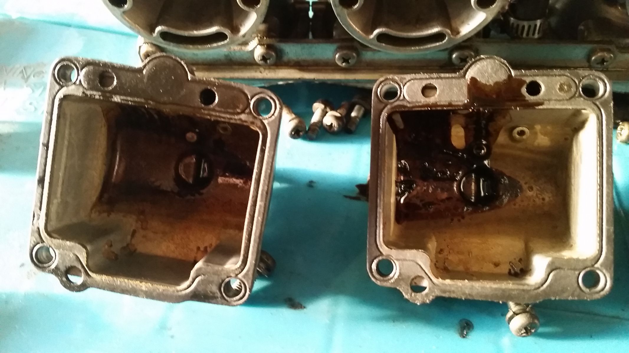

Found the carbs to be in need of some serious cleaning, so I'll take them down to the guy at the local salvage yard/workshop to be rebuilt along with the front brake calipers that get stuck clamped when the brakes are applied; relieving pressure didn't do the trick.

got a can of carb cleaner and did the cleaning myself. it was only the bowl and jet that needed cleaning. Next, brakes.
