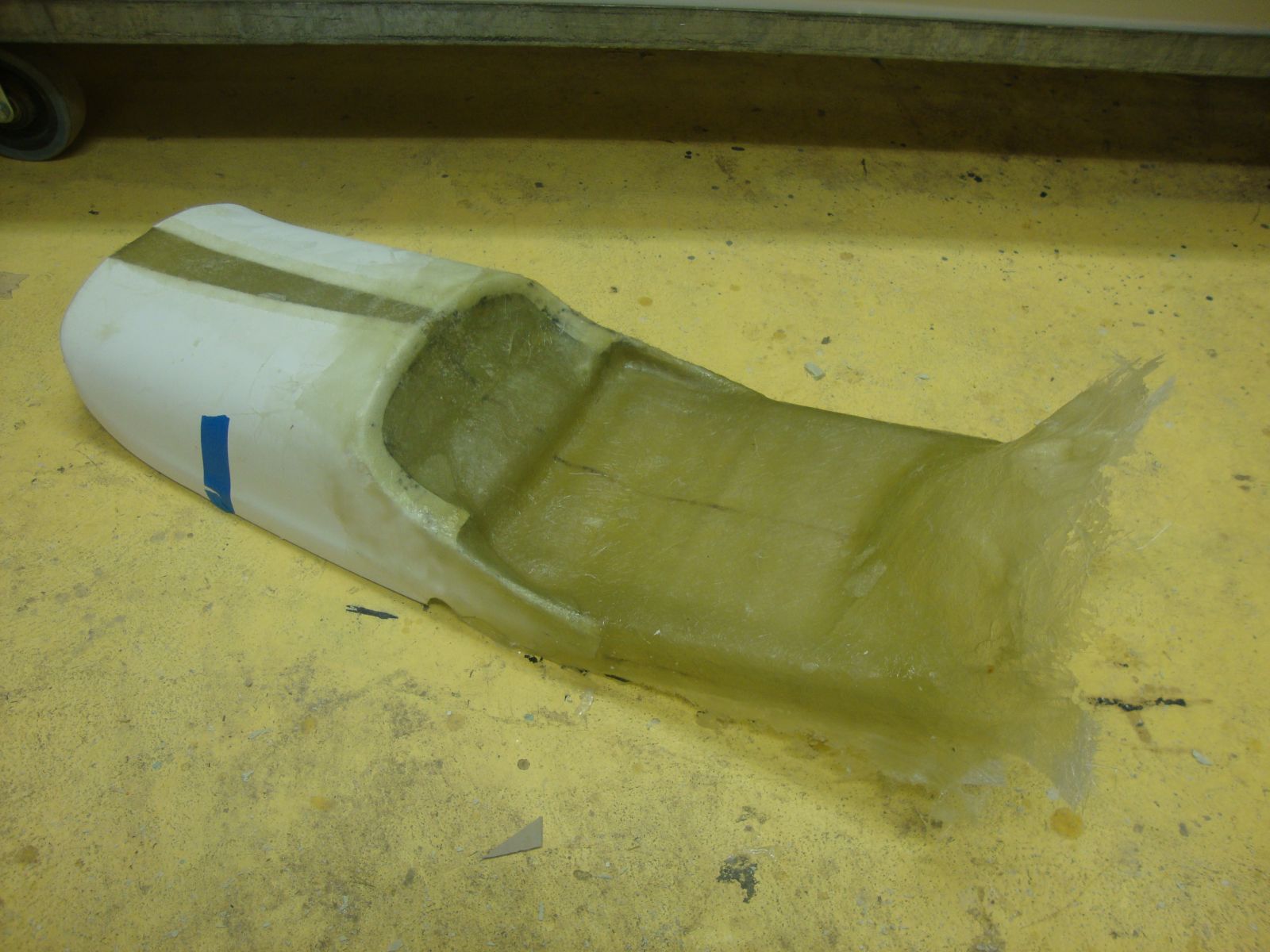

I bought a mask last week and it worked fine,the smell wasnt nearly as bad as I expected. For the sanding,I just used a regular dust mask. Gloves of course. No overalls,so my clothes were covered in fibres.Threw everything in the washmachine as soon as I got home and it all seems ok.
Part the 2th
Well,I went down to the workshop this morning and everything was nicely hardened up.Popped off the frame no problem (I used vasaline as a barrier)
A bit of a trim with the jigsaw and some rough sanding brought me to this
Not too bad for a first attempt. It will need some farting about with . The back rim is not quite right
and some filling required
I had to join a bit on here as the line was a bit high. The front part,the 'tank hump' Im still not sure about. Ithink ill have to cut it out and remodel it.
But thats it for now. Im happy with how its going and Im pretty confident that itll all work out and Ill end up with a nice tail/seat unit. Itll all have to wait for now though as I ran out of goo and Im busy this week with work.Ill be back to it next weekend.Fine tune it and get it sanded and filled.

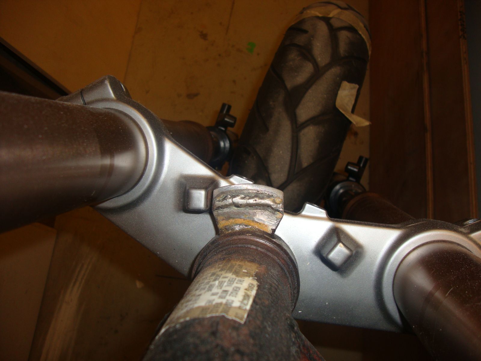

Then I had a day off work and stared at it all for a while. Ive been getting frustrated with having to farm out a lot of the work,not just because of the money but because of the fact that,all these skills are things I want to learn to do myself.So I thought 'Fuck it ,Ill have a go at welding it up myself' i found the welding machine ,a mask and some rods and got stuck in.
My first weld
Not too bad eh? The rest didnt go as well
Anyway,It turned out that I was using stainless steel rods,which is why it went so easy. So to cut a long story short,I had another go,using a mig welder.That also didnt go so great so,I took it to my local Bike shop and they did it properly for me.
Nothing ventured,nothing gained
