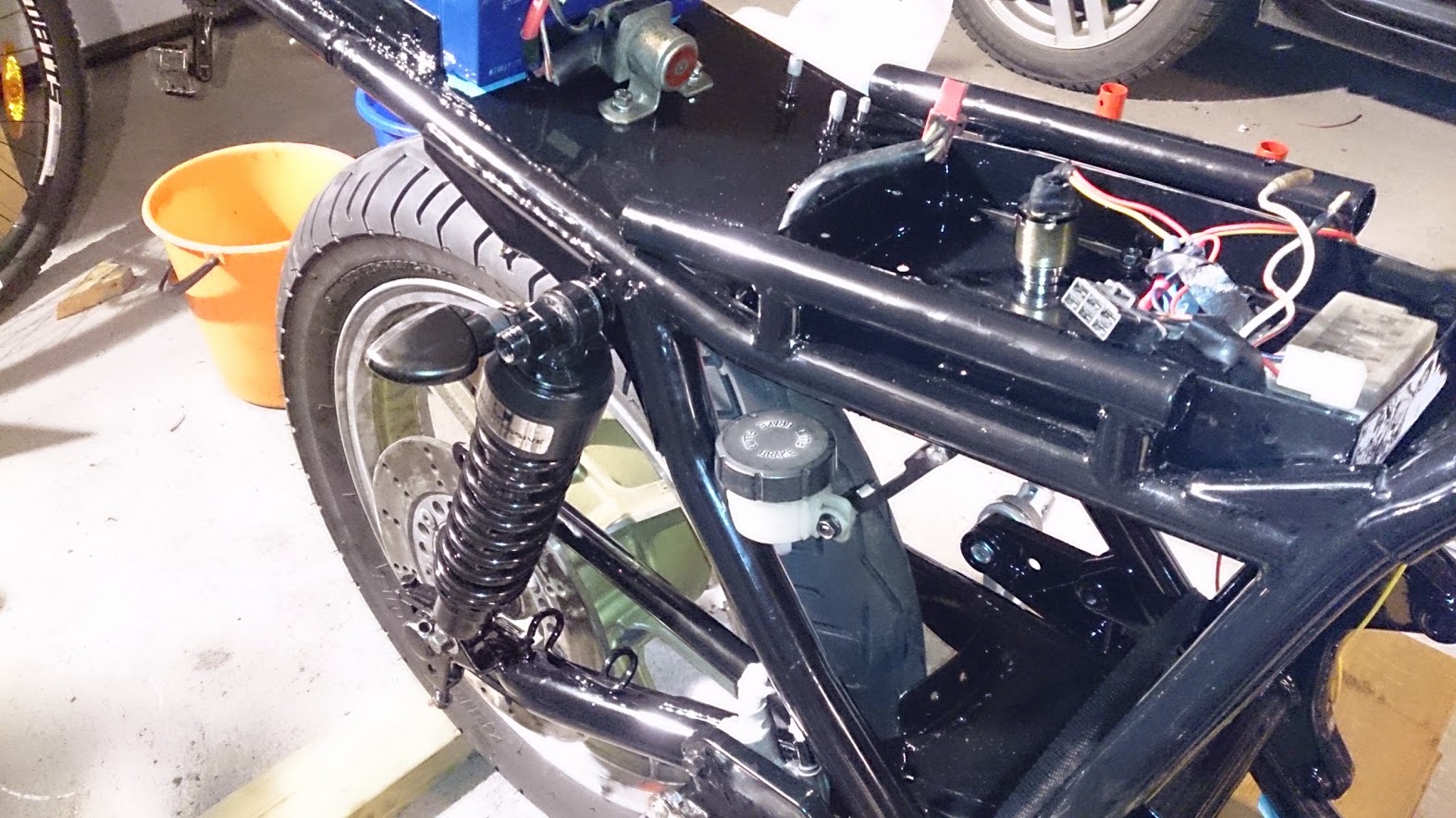

Next thjing I did last night was trying to find a way to mount the rear brake fluid reservoir. I kind of cocked up not making a bracket before powedercoating the frame. I was looking through some brackets I had lying around and found a couple of caliper spacers from my mountain bike that I am not using. They fit well for mounting the reservoir, without the need to drill the frame
Doesn't come out too shabby I think?

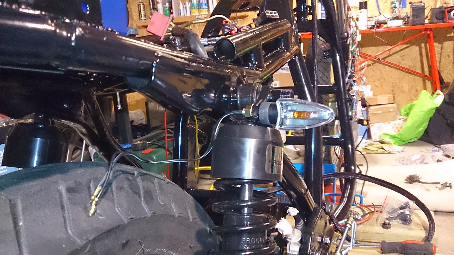

While I was at it, I needed a way to mount my rear blinkers. I also cocked up not making any tabs on the frame before powdercoating and needed a place to mount them. On the shock mounts is a good position, and I needed a bracket. I came across a rear derailleur hanger, also from my mountain bike. With a slight mod. it will fit like a glove:
So this is how the reservoir and blinkers will be mounted. Any other bright ideas on how to do this?
