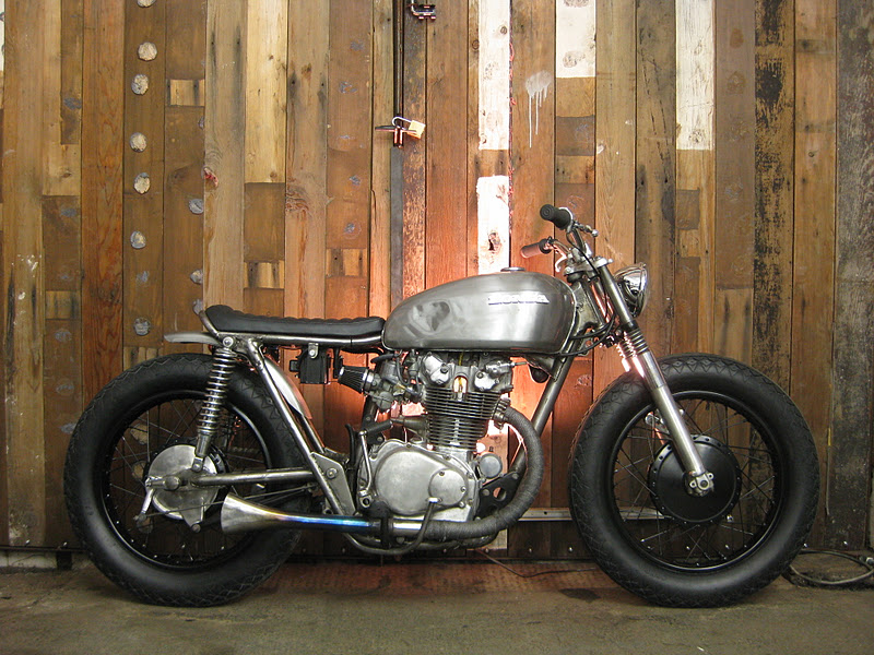

As far as the end product goes, I'd like to emulate this CB450 by Holiday Customs ... but with a bit more rust & raw.
