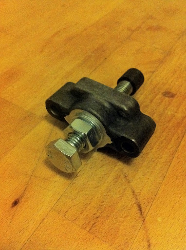

Re: KZ1000 frame off project.
15 Feb 2012 23:47 - 15 Feb 2012 23:47
#504298
Here is todays tweeky project.
Converted my stock tensioner into a manual one.
1980 (mostly) KZ1000

notaduc wrote: Here is todays tweeky project.
I like that. Is that Delrin on the tip of the bolt? Looking good duc.
16 Feb 2012 01:54
#504333
Ya, acetal. Love this stuff.
