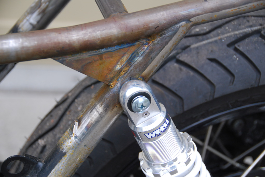

well its been a while since i got to post some progress in here. I got my frame back from the straightener and was able to get Eric to help me out a bit yesterday. I fit all the gussets and he welded them in. It started raining on my way back home so everything rusted a bit.
We also started on the shock mounts, unfortunately we only had enough time to get one done. eric turned a new mount, and changed the design slightly. It now has a bolt going into it. cleaned up the design a bit, I think it looks good, gotta get a cool fastener for it though. I still need to fit the two cross braces and two braces for the steering head. Hopefully I will get to that this week. feels damn good to be getting some progress done after sitting idle while it was at the straighteners

16 Oct 2012 10:37DoctoRot wrote: We also started on the shock mounts, unfortunately we only had enough time to get one done. eric turned a new mount, and changed the design slightly. It now has a bolt going into it.

The gusset work turned out good. Havent followed this build much but it is looking good so far

So many cool things - great work on the composites, nice details like the spedo/tach faces, and a killer job on the frame bracing! Overall excellent eye for detail! What a great build!!!
