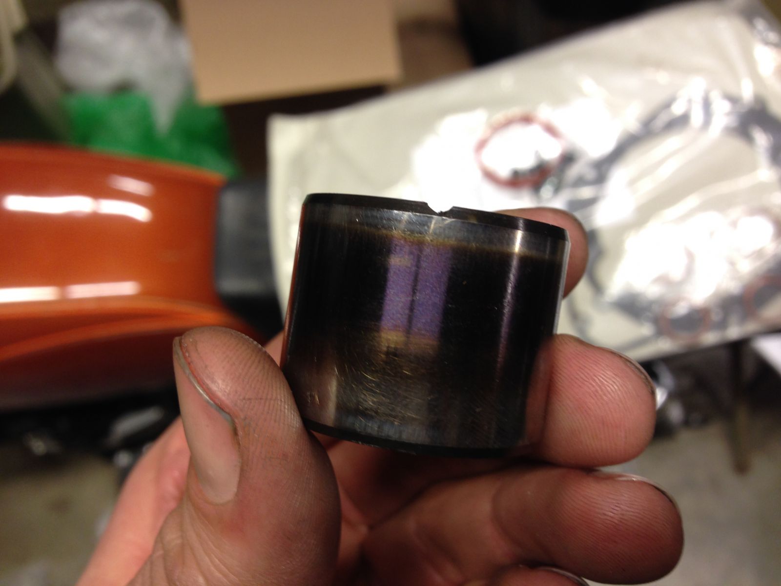

I cleaned and inspected the shim buckets before i put them in the head and 2 of them are dinged up and cracked.
What is a good starting point for shims on a fresh head? The shim sizes i was running on break down were 285-290 for intake and 305-310 for exhaust.

- Posts: 7442
Re: DoctoRot's '78 KZ1000 build
16 Mar 2015 06:44 - 16 Mar 2015 06:45
do you have plenty of shims?
if so i would prolly install all the smallest shims i had and start measuring from there.

- DoctoRot
- Posts: 2622
- Thanks: 785
16 Mar 2015 14:15
a fellow member here has got some new shim buckets coming my way. Leon- those are the only shims I have, should i get thinner ones?
