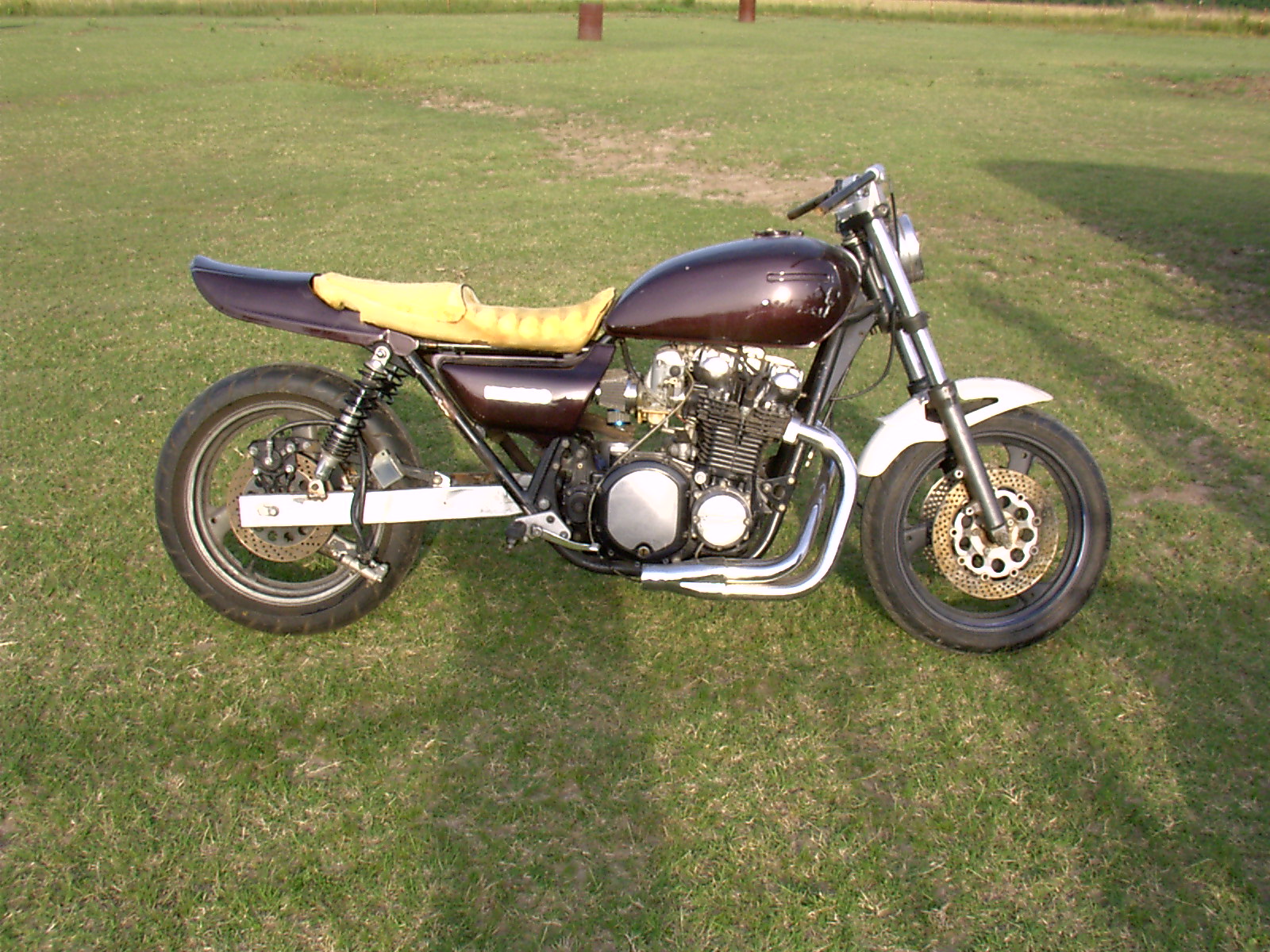

soo... i have slowly been obtaining parts to "upgrade" (in my eyes) my 1980 KZ1000 ltd... i know i am missing a few things such as clevis style shocks, chain, rear axle and some spacers, and rear tire 160/60/18... i was wonderring if anyone had some tips/advice/parts or anything that might help me in this process? also what length chain are you using with the gs1100 swing arm? heres a few pics of what i have...
parts list: suzuki gs1150 swing arm/1987 kawasaki ninja 750 rear wheel, hub/sprocket, rotor, and rear brake system

The Katana stuff is pretty much bolt in.
Conversion bearings for the forks, a little clearancing so the swing arm fits between the frame rails.
Add shock mounts and get the chain sorted out, and you're all set.
The swing arm is about 4" longer than the stock KZ1000 swing arm.

19 Jul 2011 15:17tachrev wrote: The Katana stuff is pretty much bolt in.
thats exactly what i was looking for! thank you... so for $250 i got the front forks/brakes/wheel/tire and the rear swingarm/brakes/wheel/tire and still have the rest of the bike to play around with parts or sell and get some if not all of my money back! i believe allballs.com would be a good place to find conversion bearings? anybody know of a better place that they have used with no issues? also from what i have found online it appears that the katana swingarm is steel not aluminum? is that the case? if so then perfect cause i can weld to steel not aluminum!

Sorry, I missed this post. The swingarm is steel and easy to weld.
Also, AllBalls is the perfect place to get the bearings you need.
