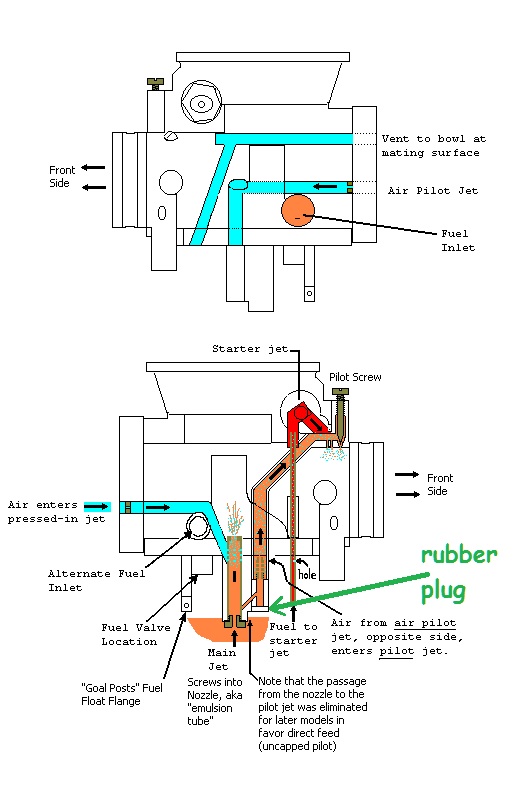

09 Jul 2011 15:06 - 09 Jul 2011 15:07freebyrd24 wrote:No gas on the plugs :dry:Patton wrote:Immediately after an unsuccessful effort to start the engine, is there any sign of fuel on a removed spark plug?
No gas on any plug is puzzling, because it suggests a malfunction common to all cylinders.
Given acceptable compression, and presumably correct cam timing, would presuppose that all intake ports are appropriately "sucking" from the carbs, but not pulling any fuel mixture.
All of which suggests a malfunction common to all carbs.
If the carbs at hand are supposed to have rubber pilot jet plugs, are the plugs correctly fitted, and in good condition?

Re: Freebyrd's 81 KZ1000 Build
09 Jul 2011 15:21 - 09 Jul 2011 15:24
This link might be faster and easier to navigate:
www.thegsresources.com/gs_carb_04.htm
Here's the 043 Pilot jet plug:
Attachment 043_Pilotjetplugpointedout.jpg not found
Last edit: 09 Jul 2011 15:24 by Patton.
