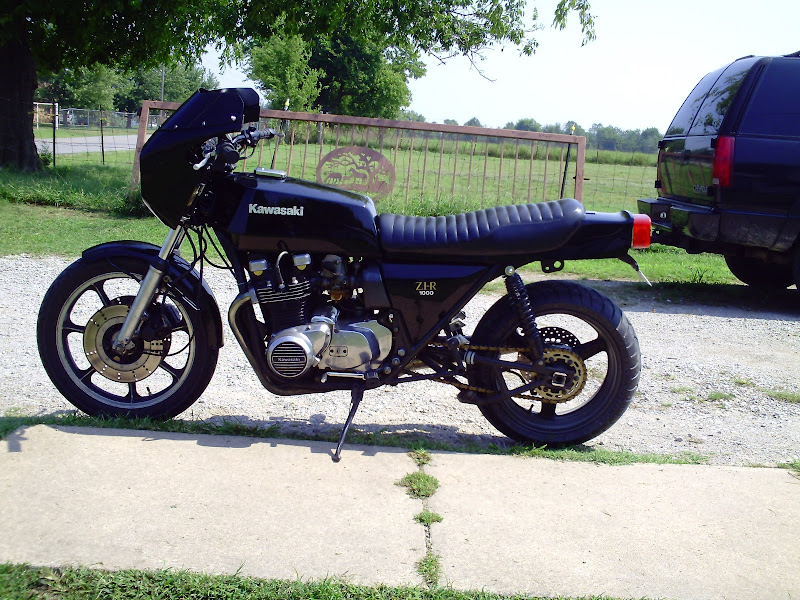

531blackbanshee wrote:
def one of the best looking bikes on the forum. my new cpu background.:laugh:
