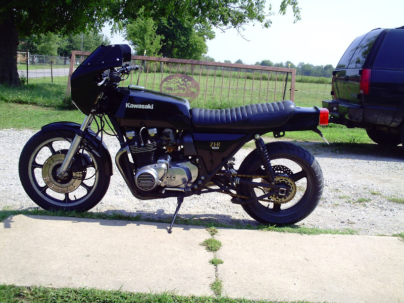

28 Mar 2011 01:03nice little yamaha!RLB454 wrote: Hey guys, Just signed up and I am sure that I will have a bunch of questions for my next project. I just adopted a 93' Police cruiser, and plan to turn it into a cafe racer. I am not new to old school cafe bikes, and pretty handy with fabrication, so the basic build should be a snap, but this is the first KZ I have ever had.
My first question is what years will this 93' cross over with? Body parts, electrical, motor components, etc. All of the police goodies will go away (of which are for sale, pm me if interesed), and I want to replace the wiring harness with a standard model. Any ideas for this bike are greatly appreciated.
Here is a pick as it sits now:
And here is my last project I finished a couple months ago. 79' Yamaha RD400F "Daytona Special" (2 stroke baby!). 2 years in the making, and a complete down to bare metal resto:
