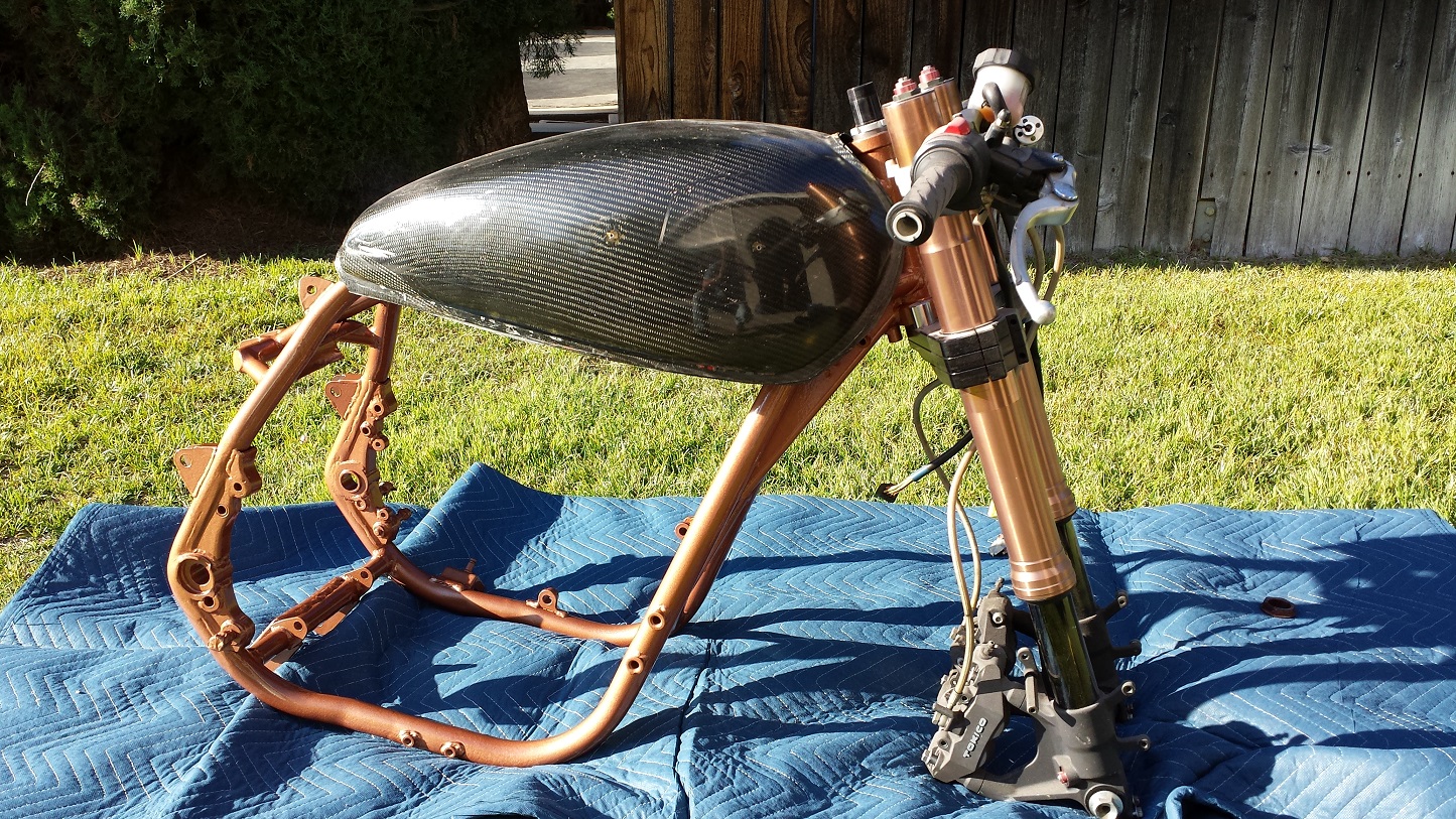

Hmmm, not a perfect match, but I DID darken the paint a bit with the candy (which, btw, isn't very noticeable if at all). OK, that will do. But how will it look with a black tank? So I set the raggedy prototype carbon tank shell on there to see.
I think I can live with that :woohoo:

lookin good! i was thinking about your CF tank the other day. I know you were having trouble with getting the CF to stay in place before you could bag it for the top mold of the tank. If you split split the tank into 3 mold sections, top left, top right, and bottom. I dont think you would have any trouble getting the CF to stay in that scenario. Although you end up with a seam in the middle of the tank. but then you just paint a sweet racing stripe down the middle to hide it. like so.

That looks really good. No disrespect on the clear coat. Probably fine if it's not out in the sun all the time. Clear coats have UV inhibitors but they can't block because they're clear. Eventually the sun will get to the resin given enough time, the clear just slows the clock.

Well yeah, no coating is forever! I wonder what happens faster, rust eating a tank or UV embrittlement of resins? Either way, if my tank has some issue down the road, I'll just make another one
Doctorot, that is a sweet looking tank! Thanks for thinking of me, and the suggestion. I will eventually have to make another tank mold, and when I do I will consider a 3 piece top unit. Before I do that, I will run some infusion experiments with the current mold. The biggest issue I had was the sheer size of the pieces of cloth I was working with, and the amount of time it took to do a wet layup necessitated a slower cure resin. That was a large part of my issue, plus the cloth not staying put. In an infusion, all the cloth is placed dry, so I can either tape or use spray adhesive to keep the cloth in position before bagging and pulling a vacuum THEN introducing the resin. If that fails to work, then I'll try something like you suggested, so thanks

the porsche sounds pretty wicked :evil: !
that painted frame has been a long time coming :whistle: ,congrats on that.

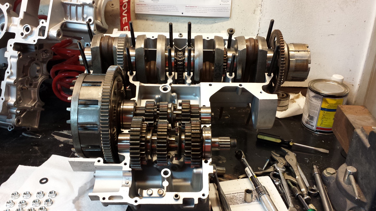

I got my cases pressure washed last night to clean out all the threaded holes and started running a cleaning tap through everything.

Curious to find out how your CF tank holds up. Did you line it with anything, or is it raw? I have one on my framer and I don't want to line it, or for it to delaminate, so I drain the fuel after every race.

Oh Leon, you're such a slave driver! Thanks for dropping in Josh, and yeah, I had my concerns as well. Not from a technical perspective, but a time and resource commitment. It always seemed there was something else more important. As for a video of the car ripping around...all in good time
Priority 1 is to get the Kz into a permanently assembled roller. Priority 2 is to finish off the major bodywork items on the Porsche. Priority 3 is the cam and clutch replacement. After that, I'll make you guys a little video :evil:
Slayer61, thanks for stopping by. The task I have here is a non working prototype. It's an unbonded top and bottom piece. I had planned to just hang that one on my wall, but it would make for a great experiment to affix a cap, fill out with pump gas and let it sit to see what happens.... I might just do that, thanks for asking
