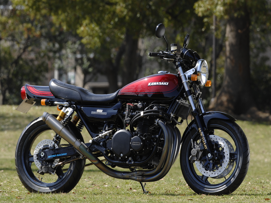

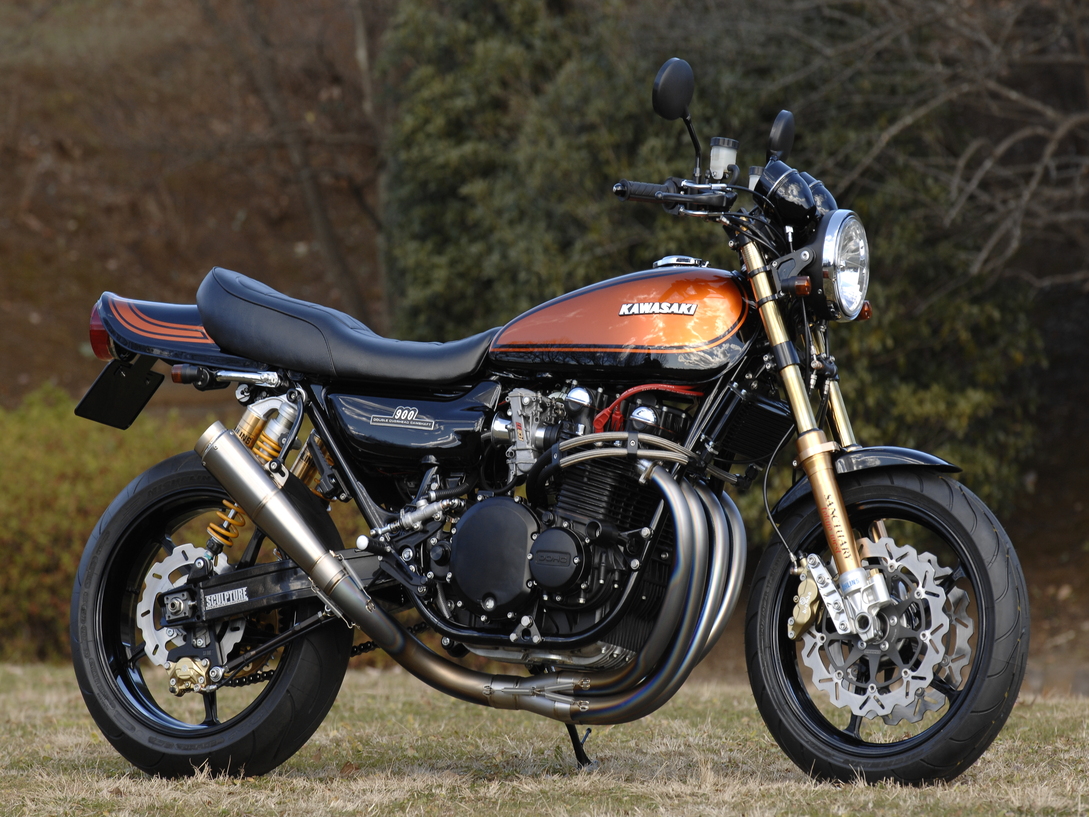

dang! those are some sweet 900s. where did u find those pics? I want to know more..
uh, oh yeah - Nice job on the rearsets too.

16 May 2011 23:31
Leon is like the Hugh Hefner or Larry Flint of KZ Porn. He's all the good pictures. :whistle:
