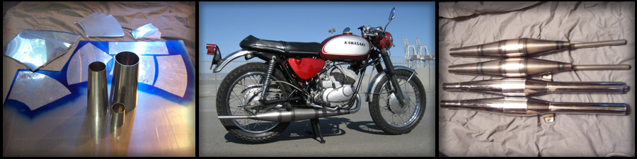

15 Nov 2011 20:23I like those. Can't seem to find a price for them so I think I will email them.
