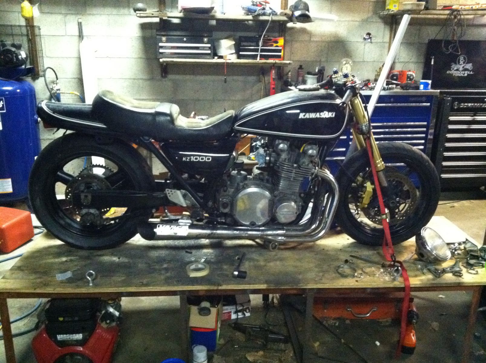

Thanks! I don't think we can get it much lower without going to a hard tail.
I have a slimmer tailight coming though, to we'll see.
Here's some slightly better cellphone pics.
Naked
Mock up
Naked
Mock up

Re: 1977 KZ1000 Street/Strip Project
31 May 2011 17:16
Looks good man.

lookin at your bike i just thought about your front tire contacting your header on hard front braking. where it dives enough to really compress the front end.
you may have already checked,but that is something to make sure you can clear.unexpeted front brake usually ends up with a face plant.
just sayin' :pinch: .
it looks kicka$$.
i have a 900 i want to do basically the same thing to.
